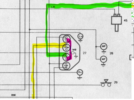

So here's what I'm confused about. It looks like, to me, that the temp and fuel gauges are not connected per this wiring diagram. If any gauges should be affected in unison it would be OIL and FUEL (the pink line). From what I see on the diagram, TEMP and FUEL don't appear to be tied together at the panel, right?

I agree and have a few vehicles that have similar results with the fuel gauge. THIS scenario with my FJ40 is different, in that the fuel gauge works fine showing the correct level of fuel, but if you watch the needle it will randomly start to drop slowly then it will randomly rise back up to the correct level. This corresponds directly with the exact same symptom with my temp gauge. They both do the exact same thing at the exact same time. Just giving more info if it helps at all.

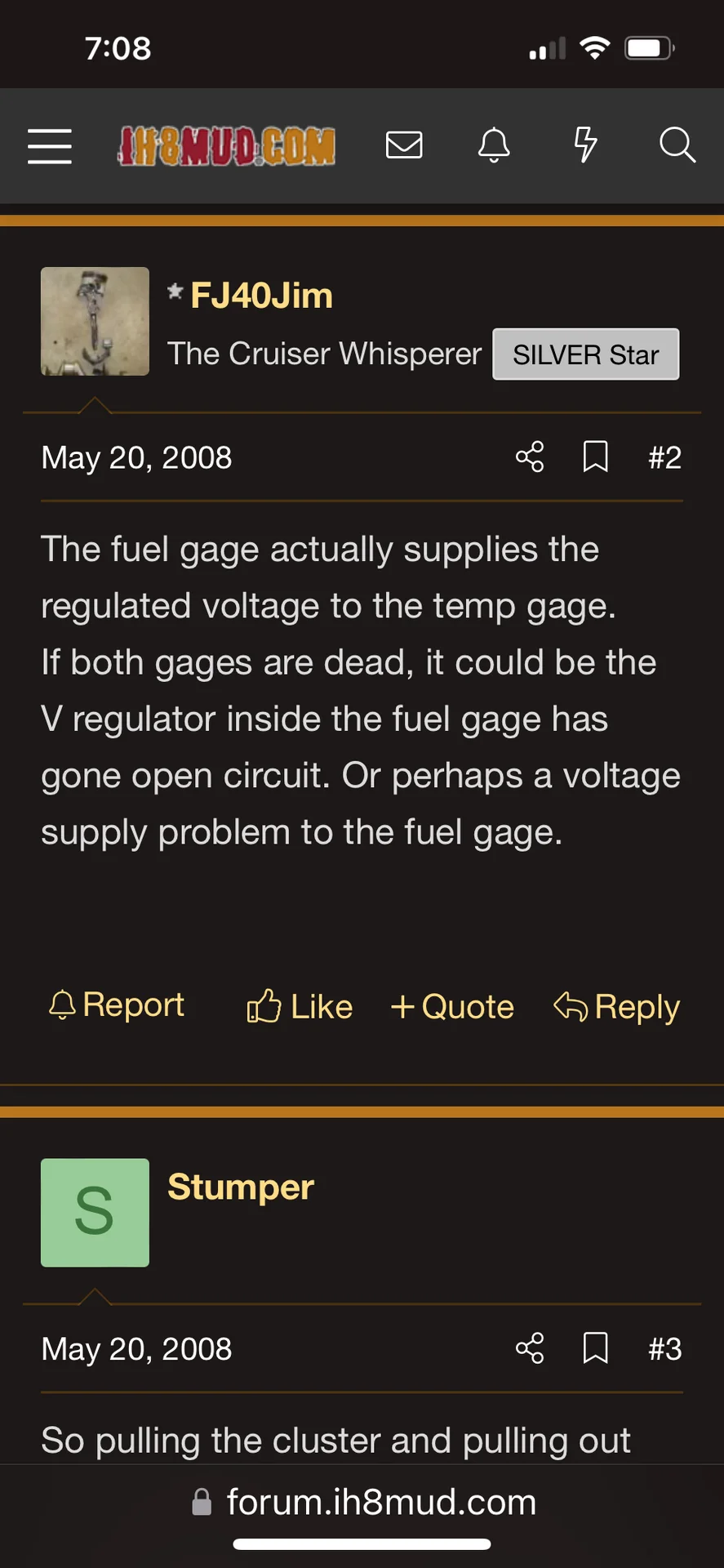

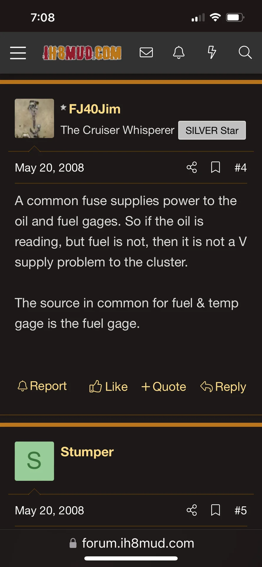

@MOTOV8R That's the kind of information I knew someone would have! I'll mess around with the wire to the fuel sending unit and see if I find anything. My fj40 has a second fuel tank that was installed at the dealership when new and that tank has a fuel sending unit too...that works. I flip a switch on the dash to change tanks and the fuel gauge reads accordingly.
Both gauges read accurately about 85% of the time so it's really a minor annoyance. If you watch them the needles will randomly start to slowly drop (in unison) and then after a second or 3 they will bounce back up to the correct reading. I'm sure it's probably a loose connection somewhere so I'll start with the fuel sending units and go from there. The info about the fuel gauge supplying power to the temp gauge gives me a great place to start. Thank you.
