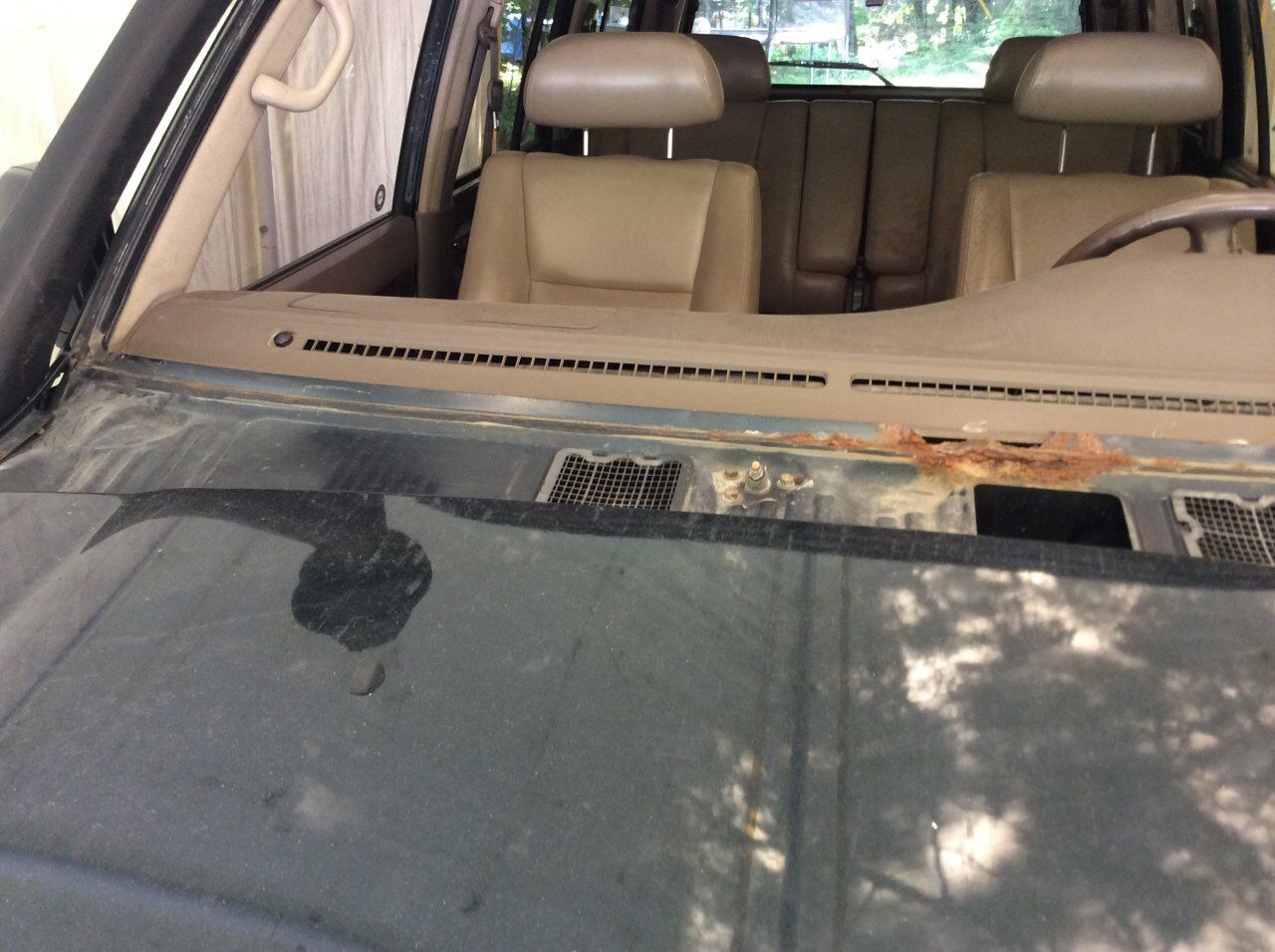

I guess even Toyota can get it wrong. This was mine last year after the glass shop pulled the original windshield.
