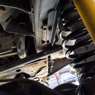

I loved them. I installed them the day before Rubithon. I think it took me longer to remove the OEM bolts on the axle side mount than installing these..

So I finally got around to installing the DC brackets yesterday during the Giants game, so time taken is not a good indicator, plus I had half a zoo in the smoker that I had to tend to, but things popped on easily enough. As a test, I'm leaving the bar parked disconnected while I toodle back and forth to work this week. I'm interested in finding out just exactly how much more body roll I'll have on the pavement with the sway bar dis-connected, since the trip I'm on this weekend is on and off pavement, ten trucks, and I won't want to hold up the bunch by connecting and re-connecting every time we're on a different surface. I don't have anything on the roof when on a trip, all is packed into the back, so my CG will be changed but not as much as the guys with roof-top refugee houses.
The body roll is easy to handle until you need to make a sudden correction.:eek: I have driven the same section of highway with and without big difference/scary if you do anything out of ordinary while driving. Bottom line its much safer connected. A big time saver for me is to have the brackets adjusted so the swaybar will stay in place at the bracket without needing to hold it up. Once you find a system that works best for you it goes pretty fast. I normally reconnect while a tire is airing up, takes less than a minute. :meh:
I ran a trail this weekend with two vehicles (Overland The Americas & Overland The World) on there way to South America both running Gopro's and Ernesto said my 80 looks like a pretzel going through the holes and never lifted a tire.:)
