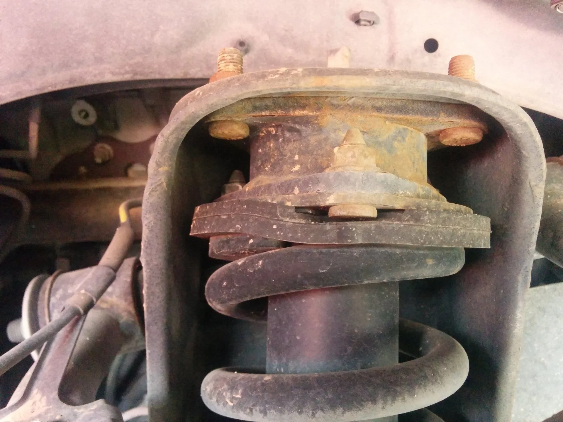

This is what can happen if you lift with a top plate spacer and don't extend the bumpstop. Shock becomes bumpstop, shock bottoms out and fails (from a Tacoma).

With much research and $38 shipped for a 0.75" puck, I pulled the trigger and got it done...nothing's permanent should it suck, and for that price it's totally worth a shot. This co$t doesn't really factor into the " save your money for a real lift" argument.
Again, for me, I just want a scosh more clearance under the skid. I like the ride, handling and travel in the stock setup. It's a family hauler and weeknd camping rig, albeit weekend camping includes the 4-hour radius around moab. . . :flipoff2:

That 3/4" Puck will net 1.5" of lift. That would be the maximum that is still safe with stock shock and upper control arm.
I been running the same thing for 5 months. The only difference I add 1/4 more on the driver's side to compensate for driver's side KDSS lean.
Two weeks ago I change the upper control arm with SPC (new style forge in US arm). When I took the OEM upper control arm out I definitely could tell the driver's side bottom out at full extension. The ball joint felt much looser compared to the passenger side that does not have additional spacer. I could feel the ball lips have open up a bit around full extension.
So a 3/4" spacer that should net 1.5" lift is the absolute maximum you can do safely.
