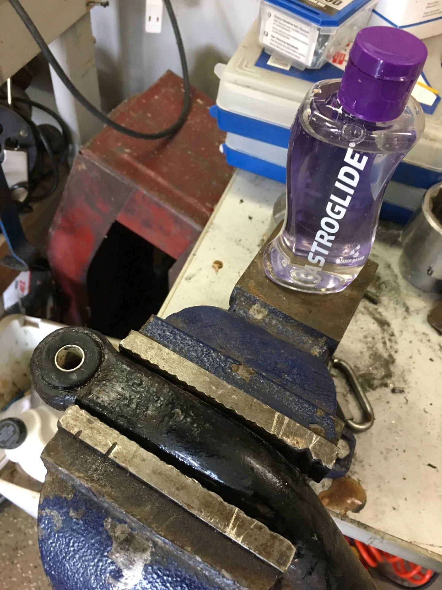

I think I've got it narrowed down. I crawled underneath again today and took a closer look. Sway bar bushings on the axle end don't look great and I can get some movement out of them. I figured I may as well replace them now regardless so I removed the entire sway bar and I'm not hearing the rattle. I've got some on order from Mr. T. I'm adding some new TRE grease boots as well as mine are torn. That could also be the culprit, letting the ball too easily pivot until it hits the stops. I think it's the sway bushings though. I'll report back this weekend.
Gotta love ASTROGLIDE for new bushings! Lol.
