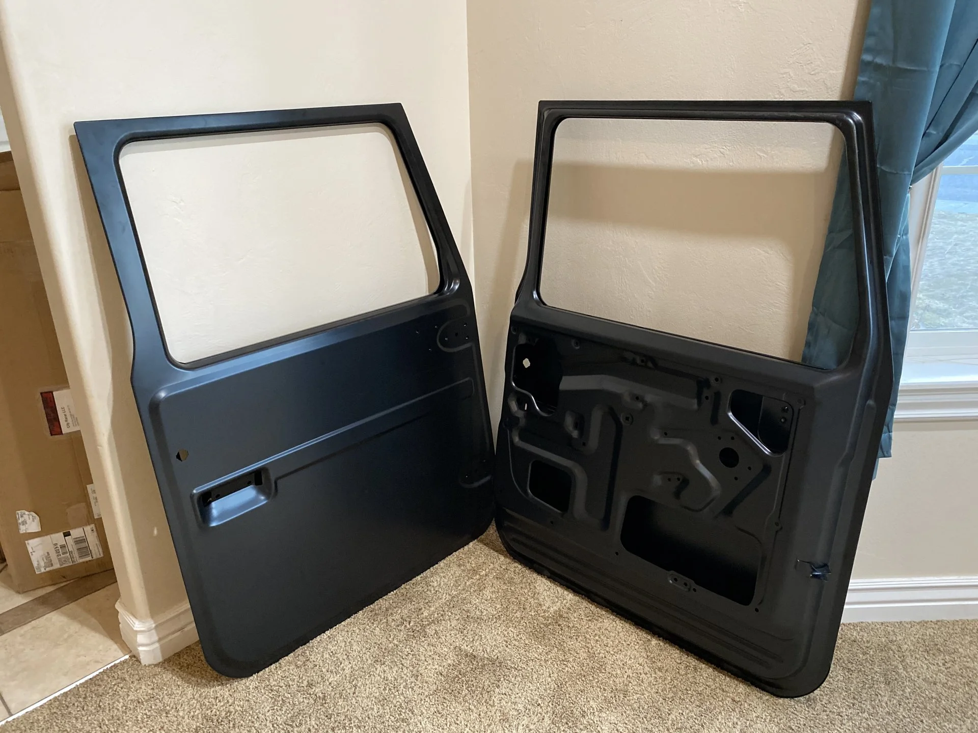

Only caught a glimpse, but it looked like the weatherstrip notches in the sill might be the newer flavor (all rubber, different clips) vs the "beaded" flavor (wire pin clips)...the SA doors were similar. Definitely good to check before assembly to have the right parts, although those sill pieces go last.
I'd be curious to see the latch pocket and inner window rails - those are the parts that are a royal pain if they're wrong...
Otherwise, seem like more consistent than the SA doors, although those pinch folds are a bit quirky as called out. The upper rail looks more consistent/straight than the SA doors as well. Lateral straightness is the other fun one - when they put the clamshell together, did they introduce any warping. (My hunch is no, but the other good thing to check).

Doors showed up in perfect condition! They look great. Curious though, my pinch folds are perfectly flat like they should be. So there might be some minor inconsistencies in production. I haven’t personally seen any SA doors but I would imagine the quality would not be better than these. Full schedule today but if I get some spare time I will post up a bunch of closeup pics for the masses.

I would wager the "assembly" might still have some human element, so that could explain the pinch differences.

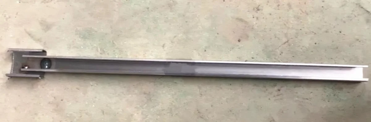

Glass rail? Like this? They offer it as a separate part. Is there a need for these?

That's the rear one that's removable. There's one in the front thats spot welded in before the clamshell is closed. I had a crooked one on the SA doors, and it's hard to fix once the door is closed up.
The SA doors did have some quirks on how that rear rail mated up too, but I digress... 😂

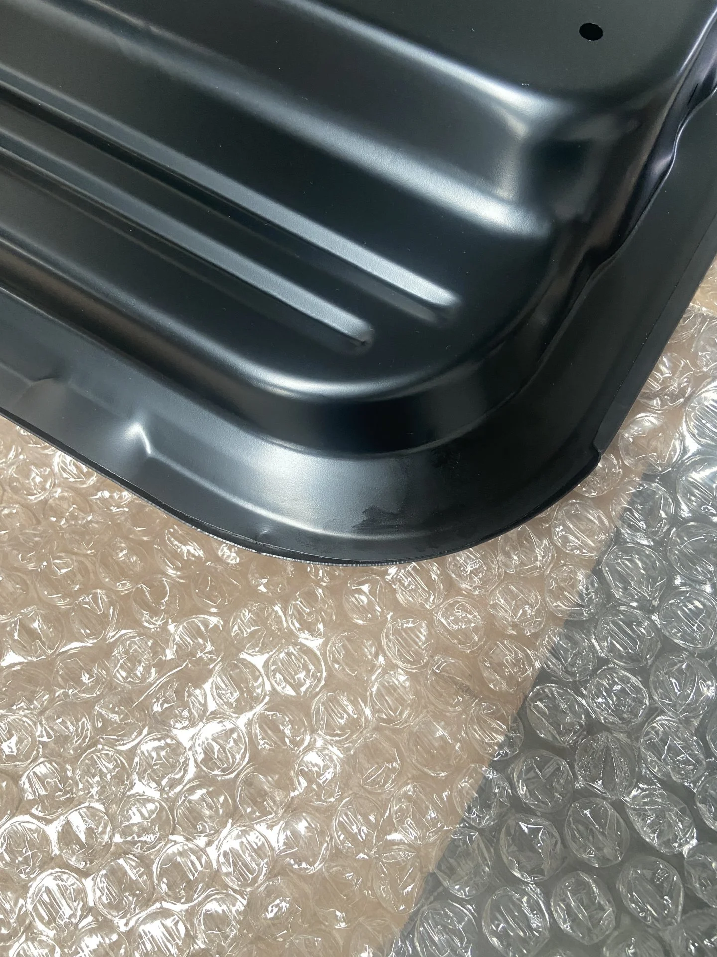

I haven’t had any real time to look this week, and I’m off duty now after a rebuild marathon earlier in the week, but I think my hunch about the bottom radius on the inside shell being a little off is probably correct. If my eye doesn’t deceive me, it’s off by about an 1/8”. I don’t think it will affect anything except how the weatherstrip squeezes down when the doors are closed.
