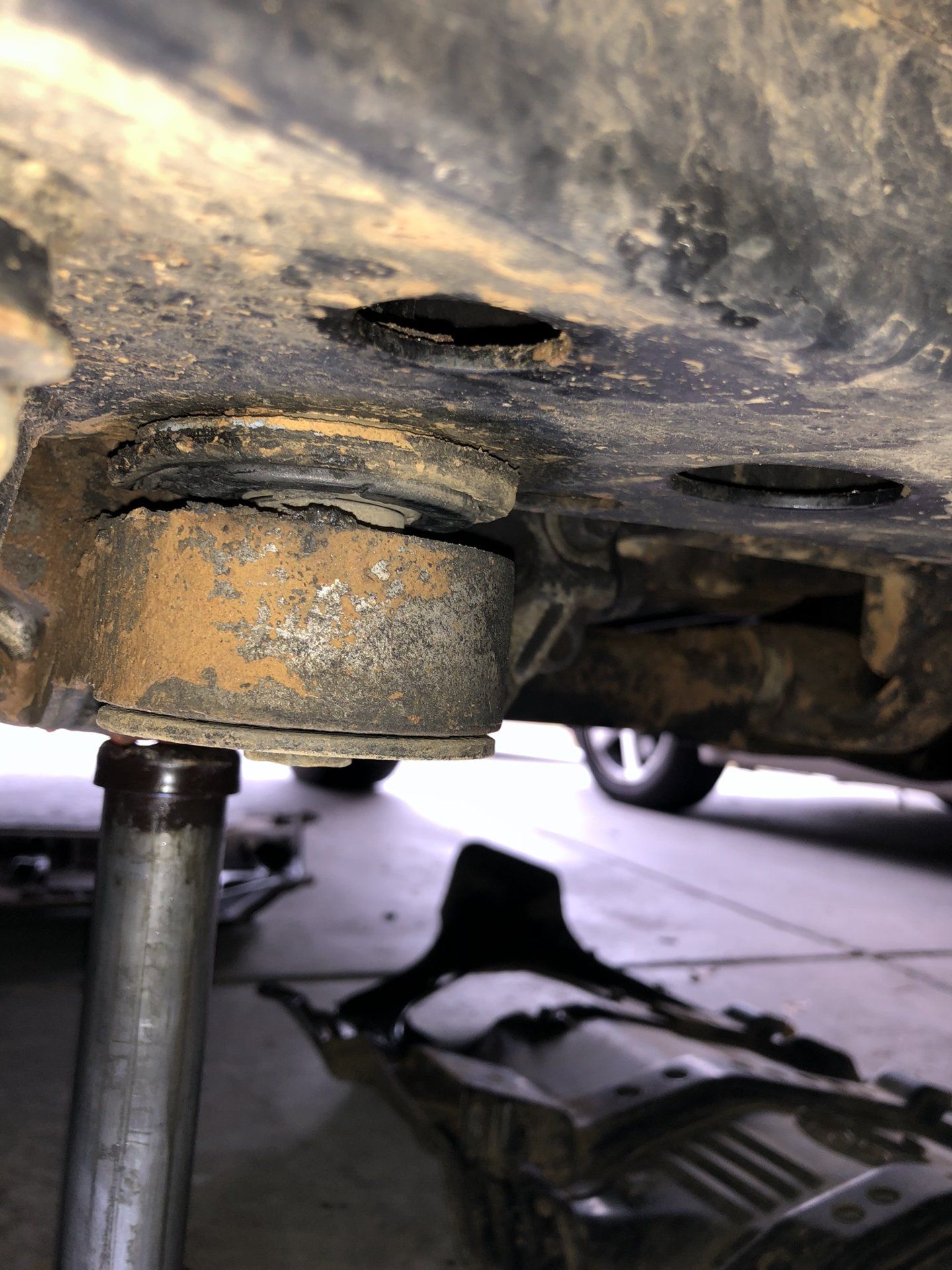

The front "hockey puck" bushing I did via a jack. Untighten the bolt while the jack is supporting the front diff. Gravity did most of the work, but I let jack down a few cm to swap out the new OEM bushing. 1 banana job!

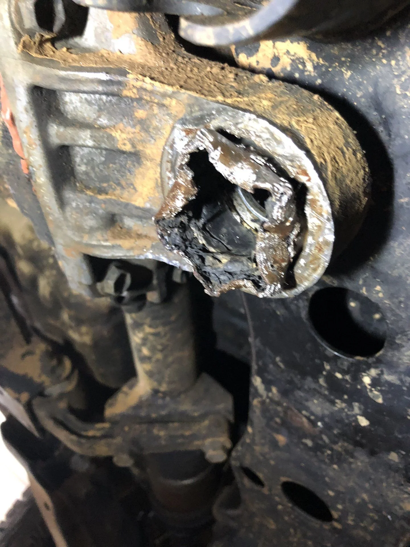

Just FYI - I did this in situ, with nothing but a 3 lb hammer, flathead screwdriver, and a floor jack. It took me all day, but it *is* possible, just not enjoyable. Pressing it in was just as hard as removing it, and I had to use the hammer to beat the last 1/4” or so. I still couldn’t get it flush, but close enough to consider it done since it fixed my thunk.
Rent a press from advance auto to get it to seat all the way. It’s a 20 min job max

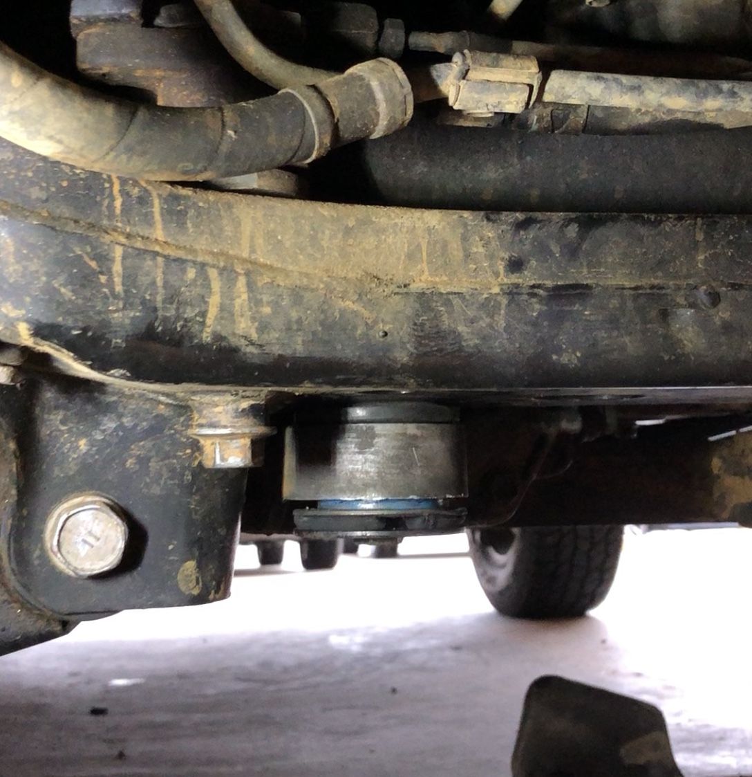

I'll see how well this works, polyurethane installed

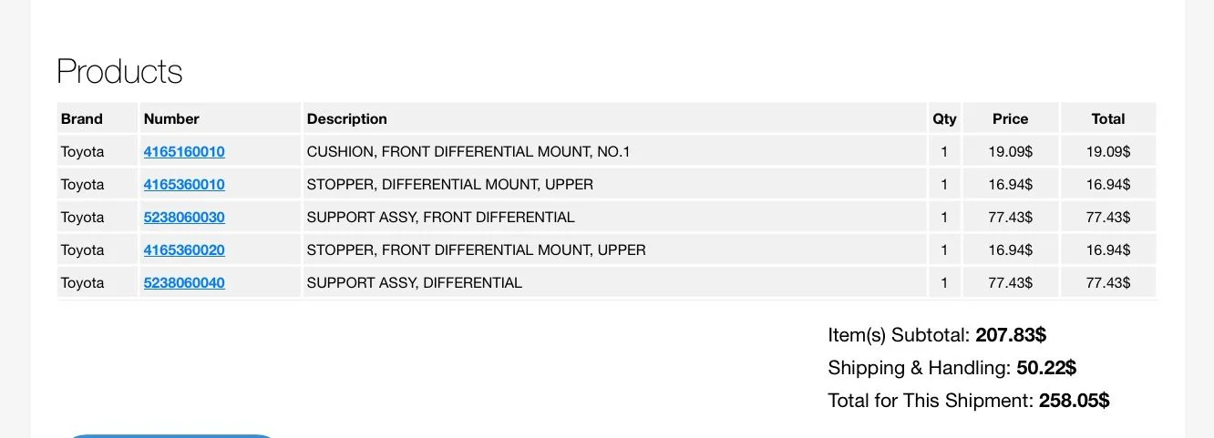

Can anyone verify the part number for the (8) bolts for the Front Diff Cover (41181B)?
I have a 99 LC. Thanks
Thanks so much. Was pretty certain on the diff cover, but saw a couple different numbers for the bolts. Looks like 90105-10417 has replaced the old number of 90105-10117. Thanks again!
41108-60011- Cover
90105-10417 - bolts
41108-60011- Cover
90105-10417 - bolts

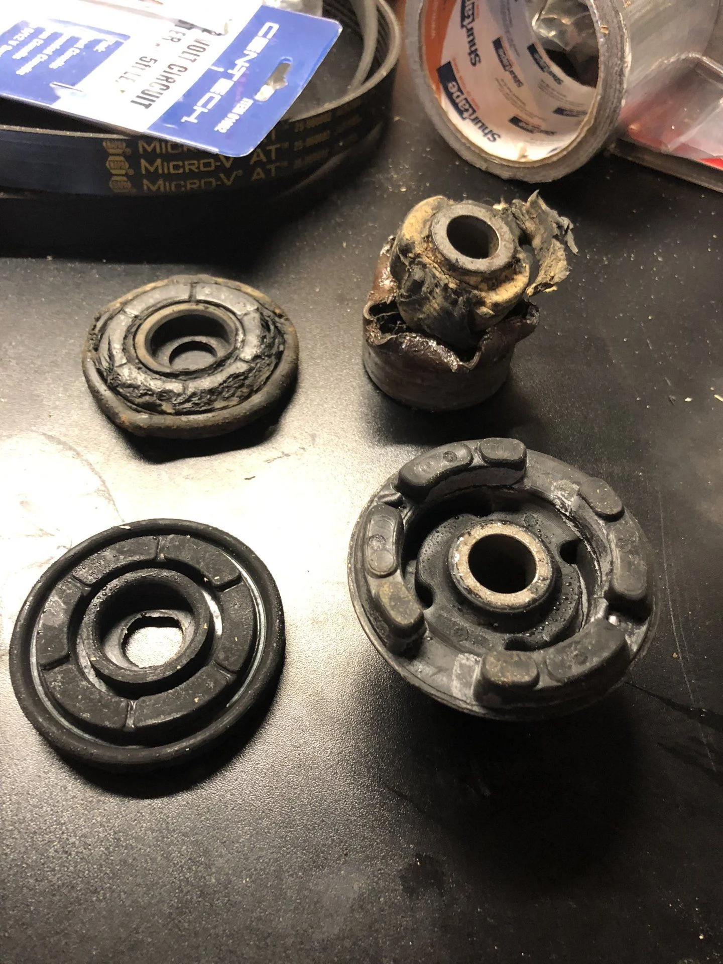

Ordered all of the front diff bushings from PartSouq. My 98 LX has D to R clunk, bushings are a bit worn and the front drive shaft feels like excessive play when shifting into drive or reverse. I'll update once I get installed on the improvement.

I suspect it will help. I'm not sure what is with the front driveshaft / diff slack. Maybe it's always been that way, but I can notice the clunk because the bushings are bad.
I replaced the front and driver side bushing on mine, still have a clunk. Need to replace the rear bushing, but it doesn't have a ton of freeplay. I think my clunk is coming from slack in the front diff. The front shaft spins about a half turn going from drive to reverse and I don't see much slack in the CVs.

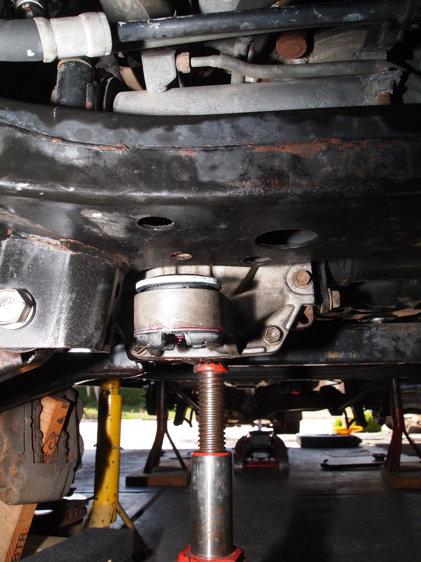

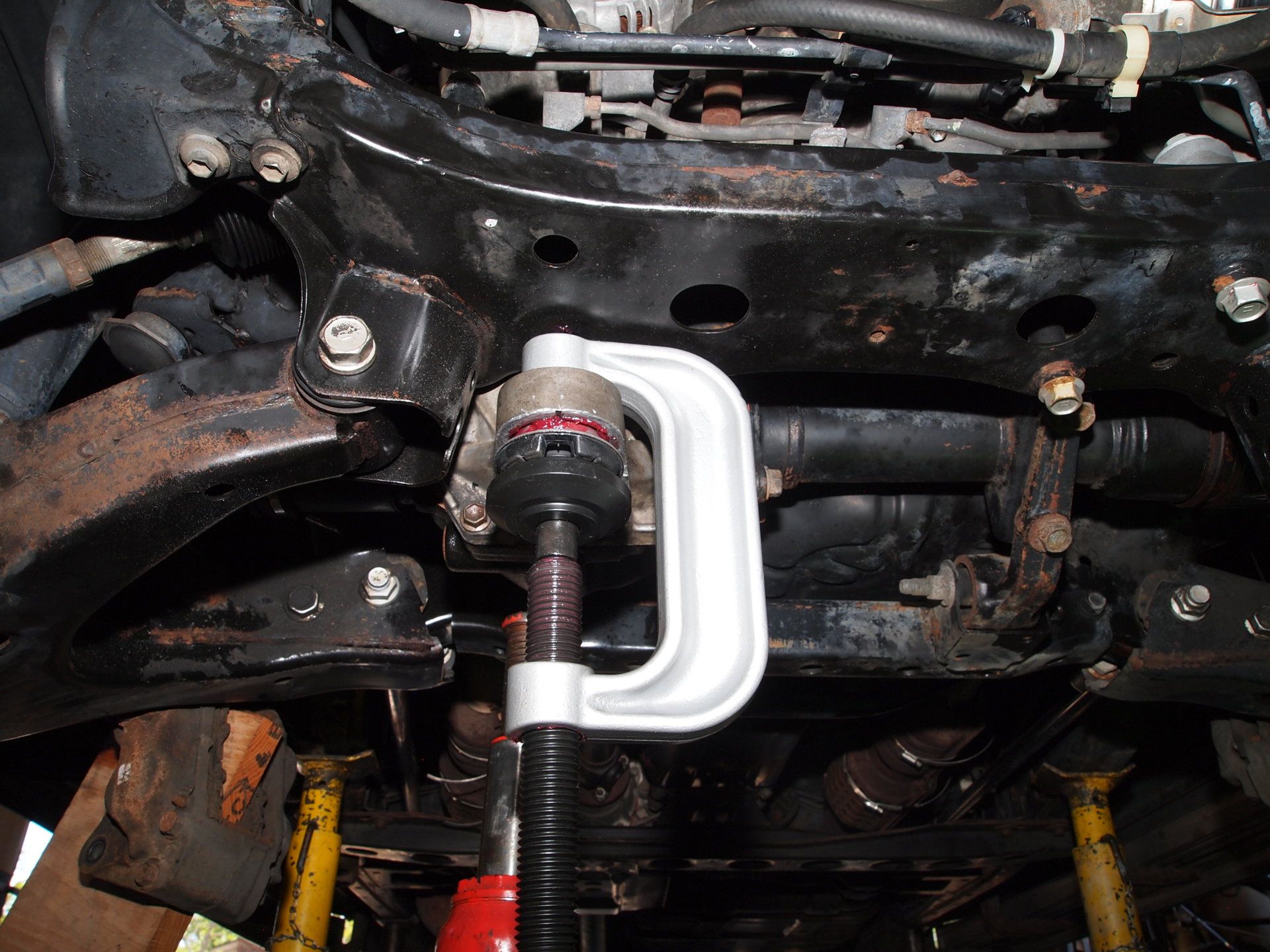

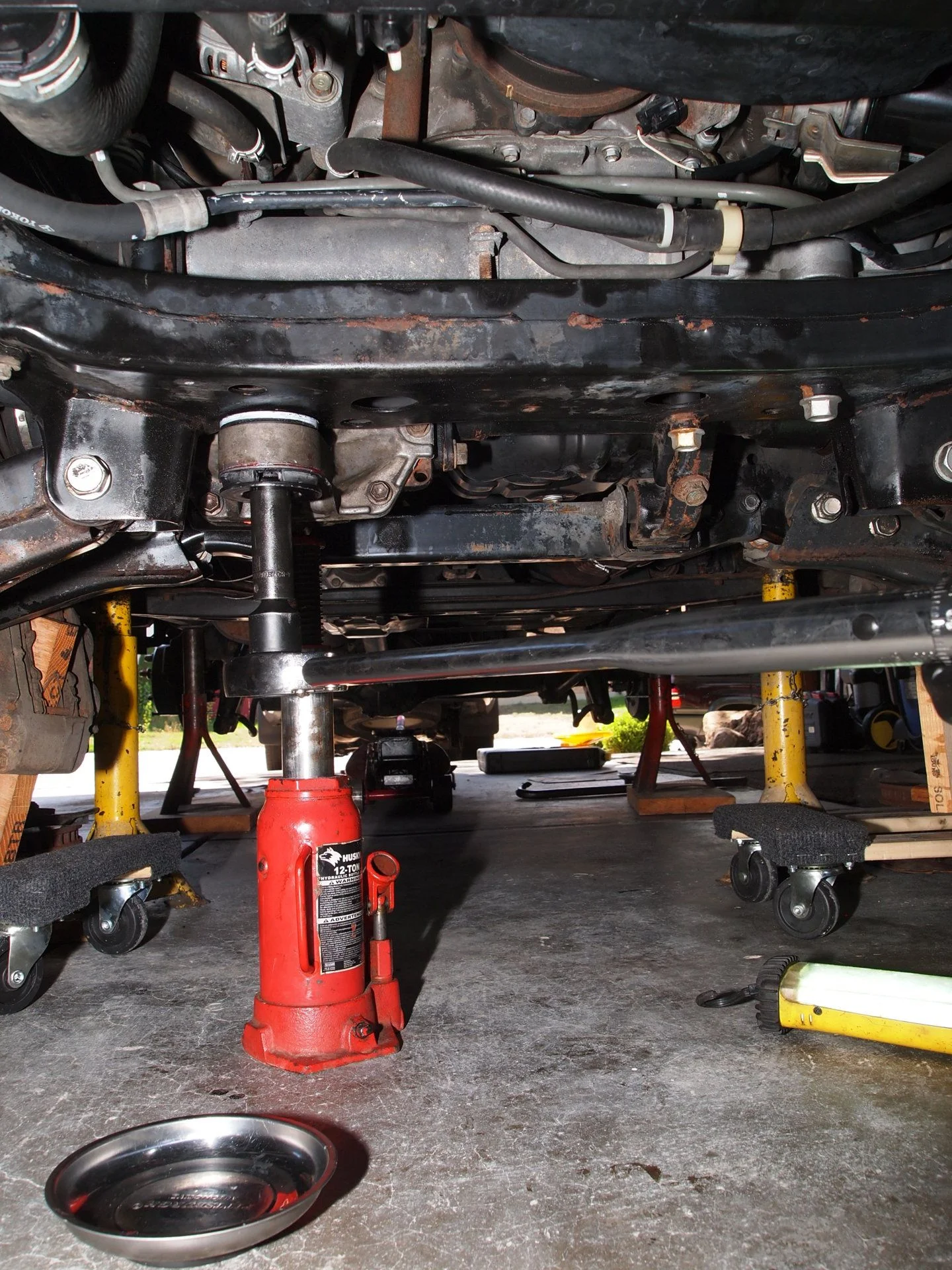

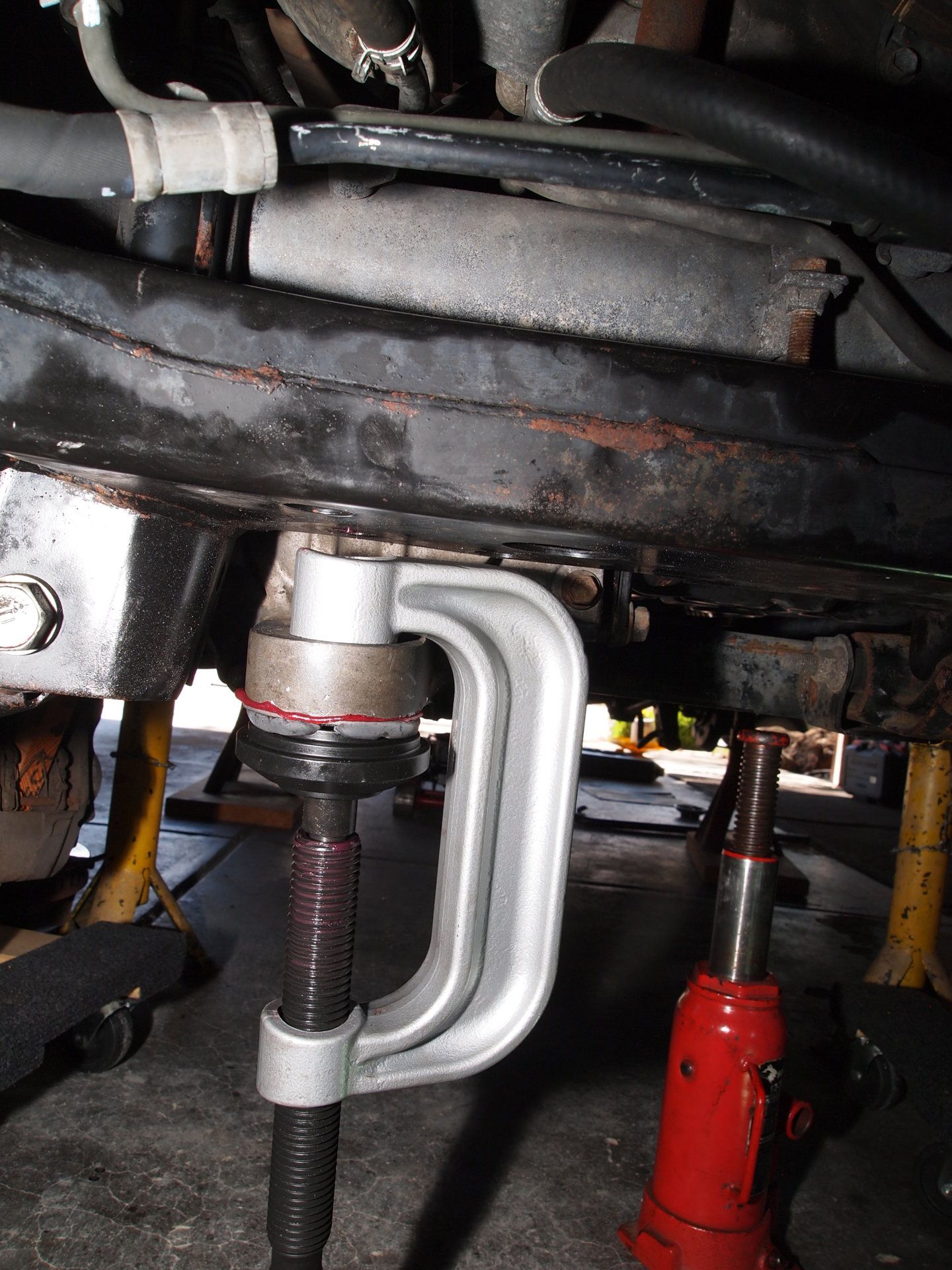

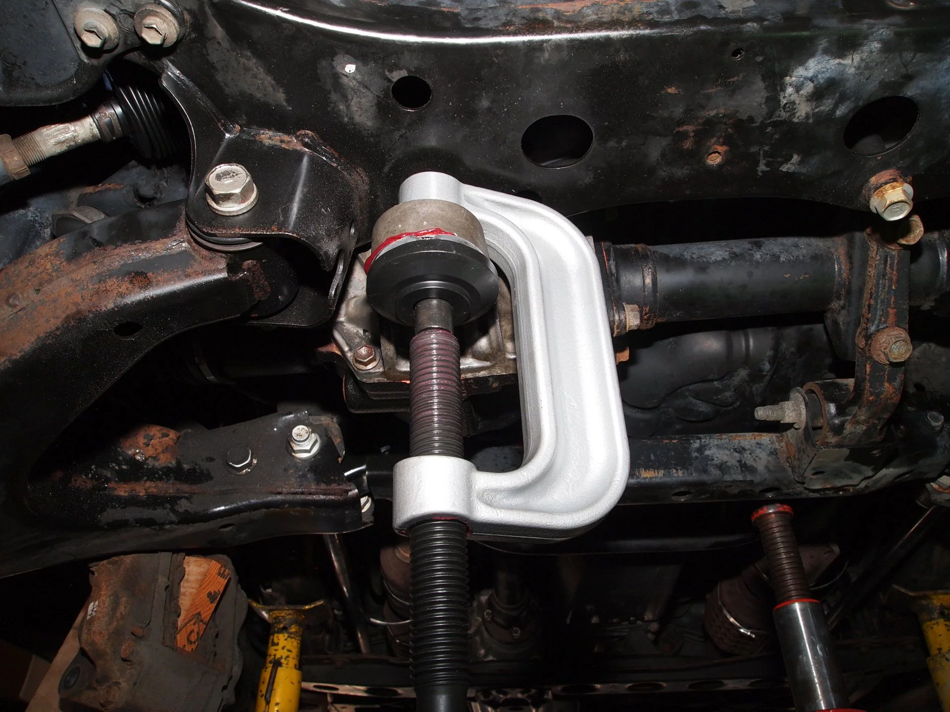

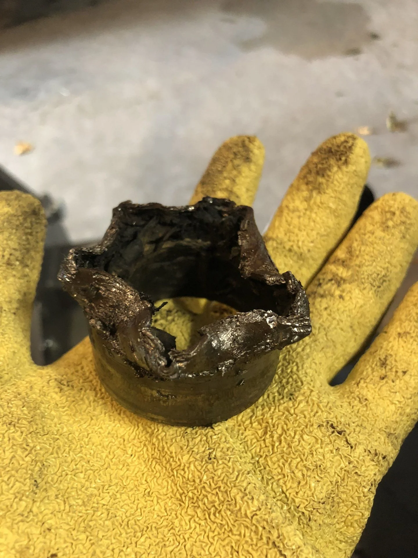

Replacing the pressed in front bushing isn't difficult with correct tools. I drilled out the old bushing center, used a small and medium sized chisel to work the old bushing housing loose, cleaned up the slot with some sandpaper, greased new bushing, started to seat the new bushing with the bolt & washer, and then pressed it in with a c-clamp style press. Took about an hour, a prybar will be useful push the diff down, to remove the press if needed.
