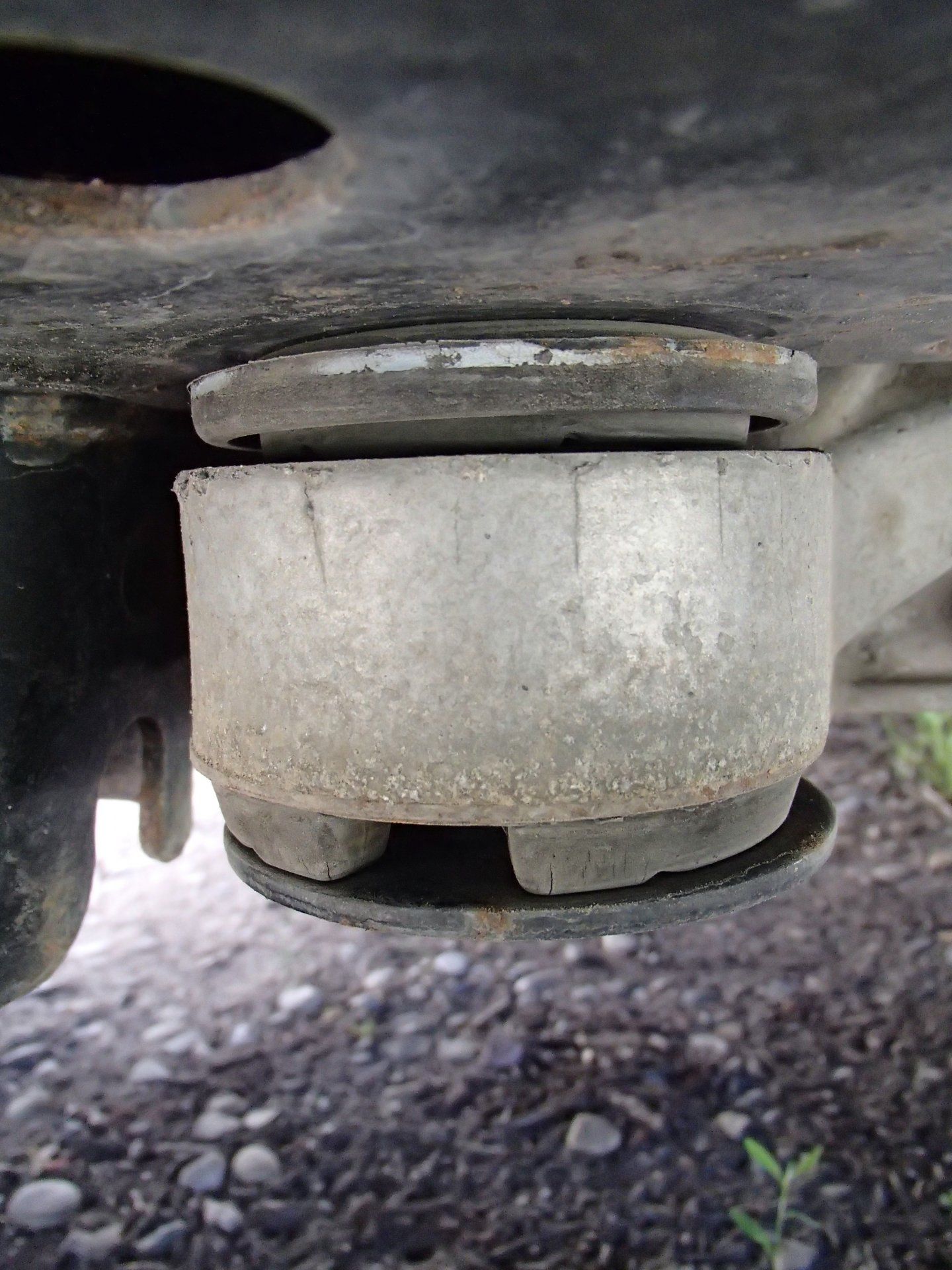

I snapped a quick photo of the front cover bushing as well. Can anyone confirm if the gap closest to the frame is supposed to be that large? When shifting from D - R it will move almost all the way up and down.

I just installed a diff drop this past weekend so its fresh in my mind. As far as I can remember, in order to get the puck out, you have to unscrew the 19mm bolt that holds the puck in place, and also the two 19mm bolts that hold the diff support arm to the axle tube ( all require 137ft lbs torque so be prepared for that). This should allow you to drop the diff enough to slide out the puck. Not sure if you'll have to loosen the rear puck mount to get more clearance- that one is a booger if you have any crust on that top nut.
So the thing is that the puck is attached to the diff cover... So If I destroy the bushing in the puck to get it out, I either have to put a new bushing in or the whole diff cover... And I have not been able to find just the bushing.
This is the one I'm talking about just to be clear
There is a bushing pressed into the mount on the diff cover (what you have circled), the "puck" sits on the topside of the bushing. The "puck" can be removed by dropping the diff down- after you remove the bolt and drop the diff/axle assembly down an inch, it slides right out.
I haven't tried this next step so I am figuring the bushing that's pressed into the diff cover will require removing the cover to replace it-I've read some folks have busted the diff cover trying to get that out while on the truck.

To answer your question, I loosened to bolt holding all of that together just far enough that I could see the bushing inside the cover is cracking. I am also having an extremely difficult time tightening the assembly back together. When I have a jack support the diff, there is still room up and down for the diff to move. I can't tighten it all the way (maybe by design?) and I'm not cross threading.
I believe the bolt threads into a captured nut so there shouldn't be any interference for it to bottom out on, but the bolt itself is shouldered so maybe you have run out of thread which sounds from your description that the rubber has worn away enough to cause that gap.
That's what I'm thinking. So I think I have to replace the cover and the puck below and on top.
According to earlier posts in this thread- the diff cover bushing itself can be ordered separate of the diff cover: 41651-60010 (CUSHION, FRONT DIFFERENTIAL MOUNT). The puck (STOPPER, DIFFERENTIAL MOUNT, UPPER) is 41653-60010. Better check the rear cushions as well while you're at it.
