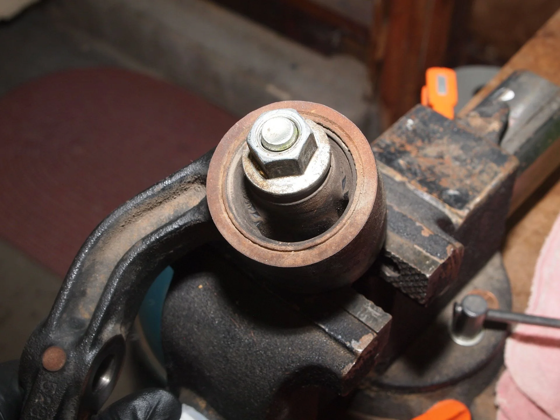

First, in the video showing a supposed bad "bushing" arm, using a crow bar on the diff DS side tube bushing arm. That bushing looks and sound good to me. Where I once thought that a sign of worn out bushing, I now know they are designed to move like that.
~ 50% of the bushing connects inner to outer area. ~50% is void. In this one the rubber is starting to crack, but really not to bad. New is stiffer, but not that much improvement will be gain by replace this ~$100 bushing.
At 200K miles and 13 years not too bad.

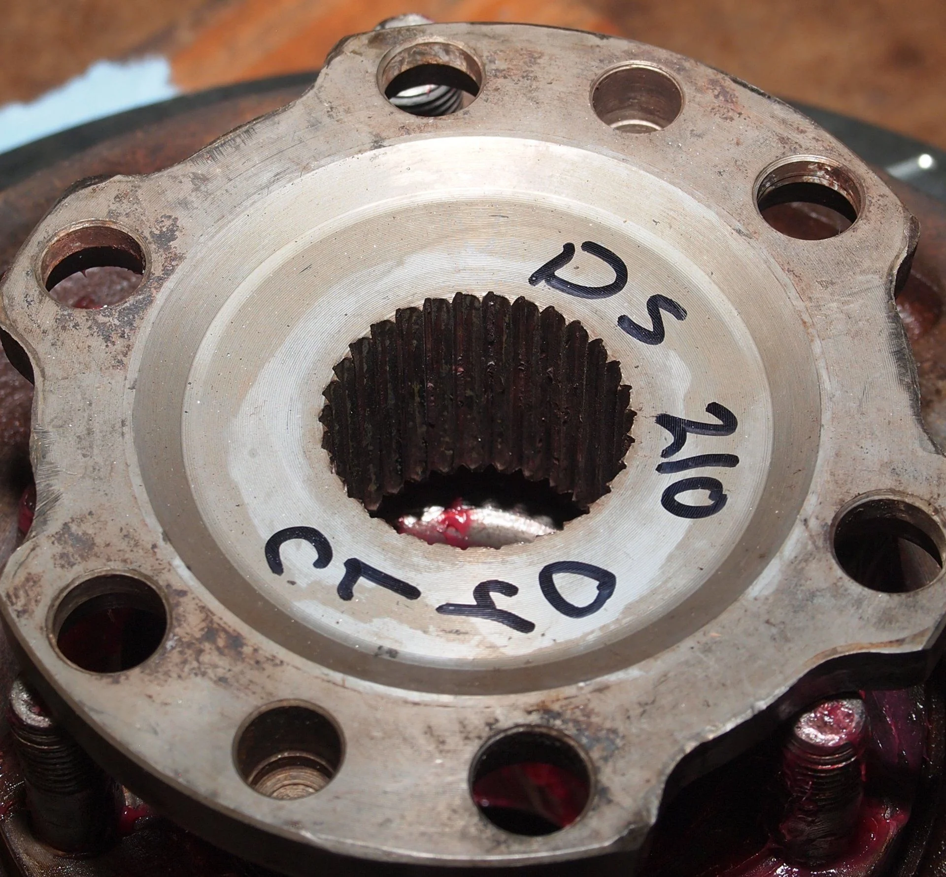

New Hub Flange
2012433
Worn
2012430
2012435
Damage face where snap ring rides.
2012431

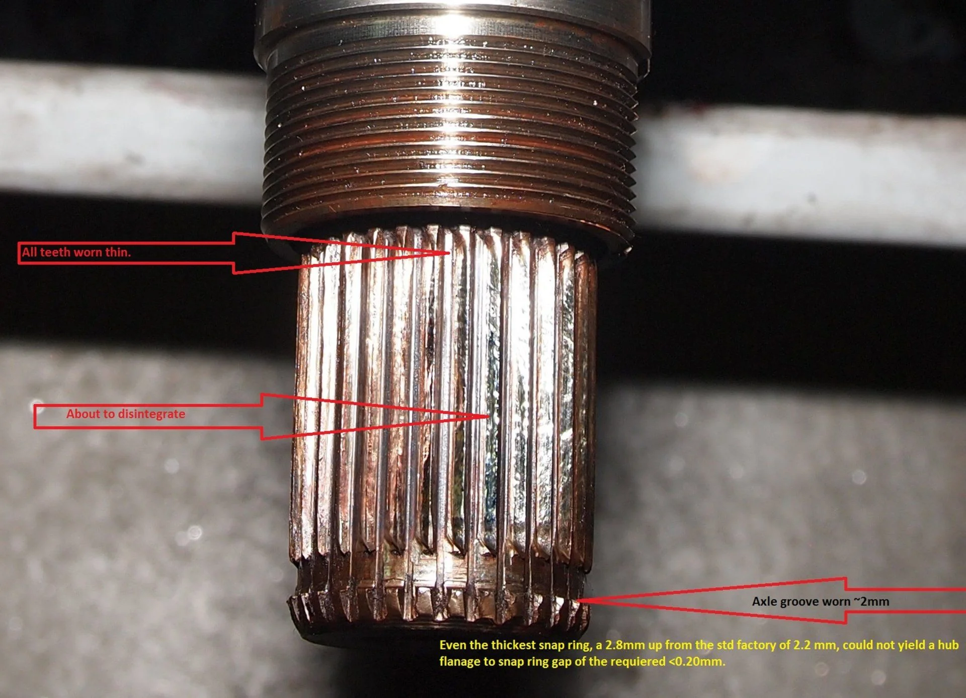

If wheel bearings loose and snap ring (reused) and gap to wide, axle and hub flange will fail. Properly serviced wheel bearings protect the very costly FDS (Front Drive Shafts). No reason for axle and hub flange to ever fail.

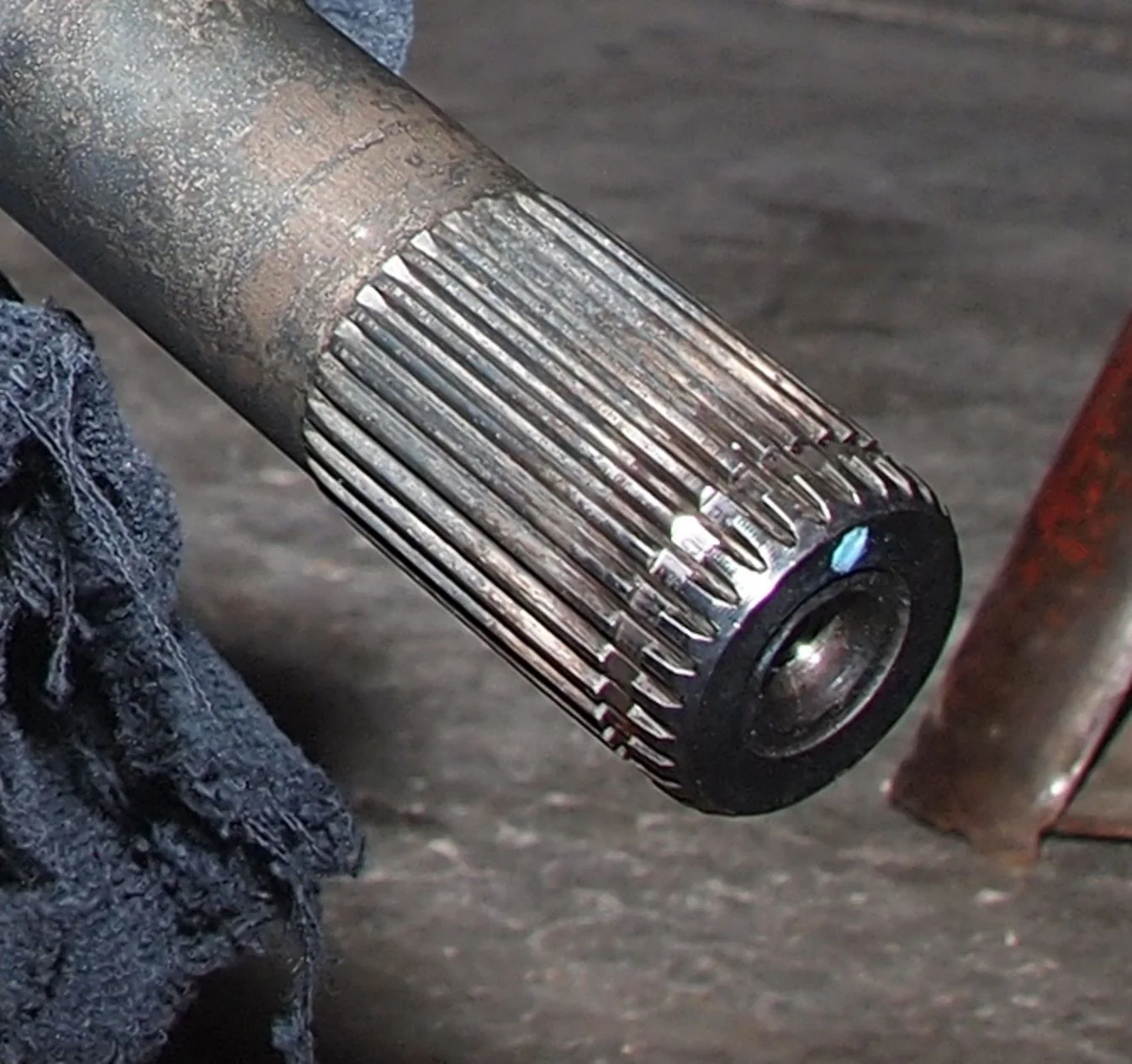

Here's a bad axle of FDS. See how worn the splines/teeth are:
2012452
Good axle
2012454
The most expensive result of not properly service wheel bearing is FDS.
Preliminary inspection of health of hub flange and axle.
Worn axle and hub flange yield D-N-R clunk.

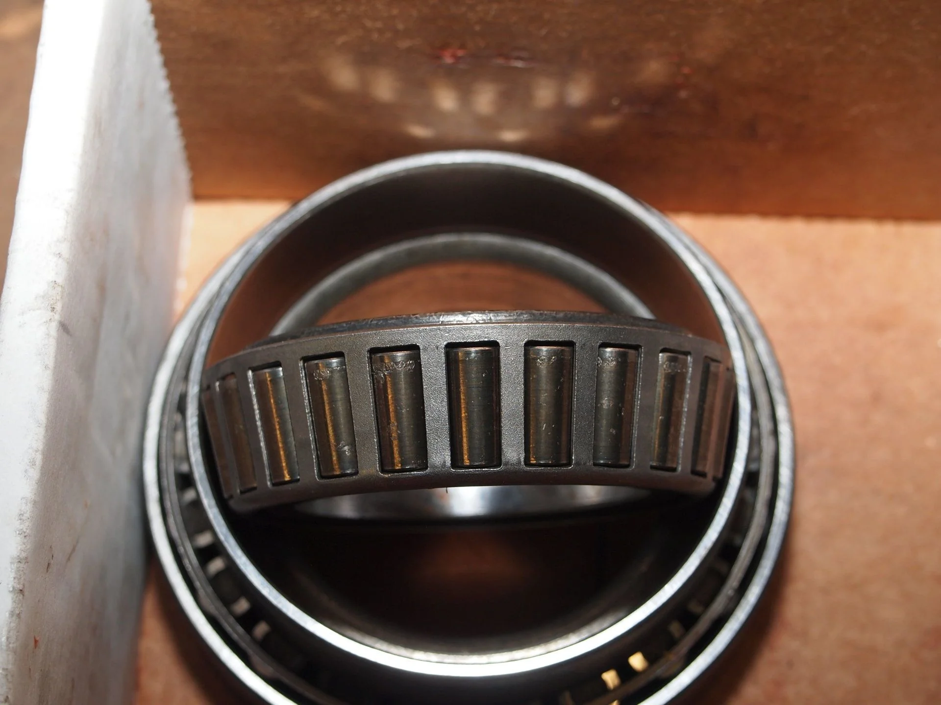

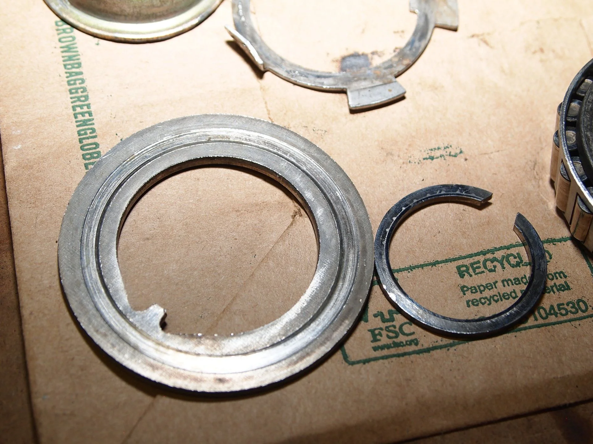

Here is examples of a bearing, claw washer, snap ring and cone washers that would need replacing.
This bearing did have 570K Kilometers on them, but were not properly serviced. Had they been, they'd likely still be good and not looking like this.
2012747
Here the first axle needle bearing and brass bushing I've replace. They still had factory grease at 570K KM. The inner cage was black from excessive heat as was race of wheel bearing above. Had they been grease every 30K miles they likely be fine.
2012749
Here's a scored claw washer. Which scoring is from loose wheel bearings chatter on it. Once they start scoring, bearing loosen faster and chatter get worst. It's a vicious cycle.
2012753

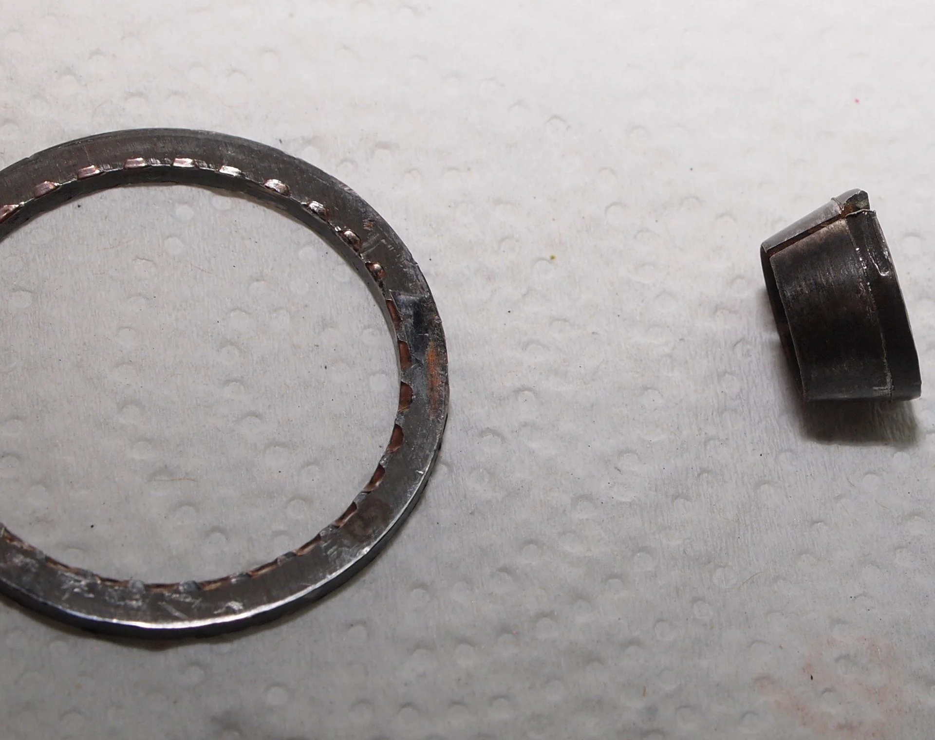

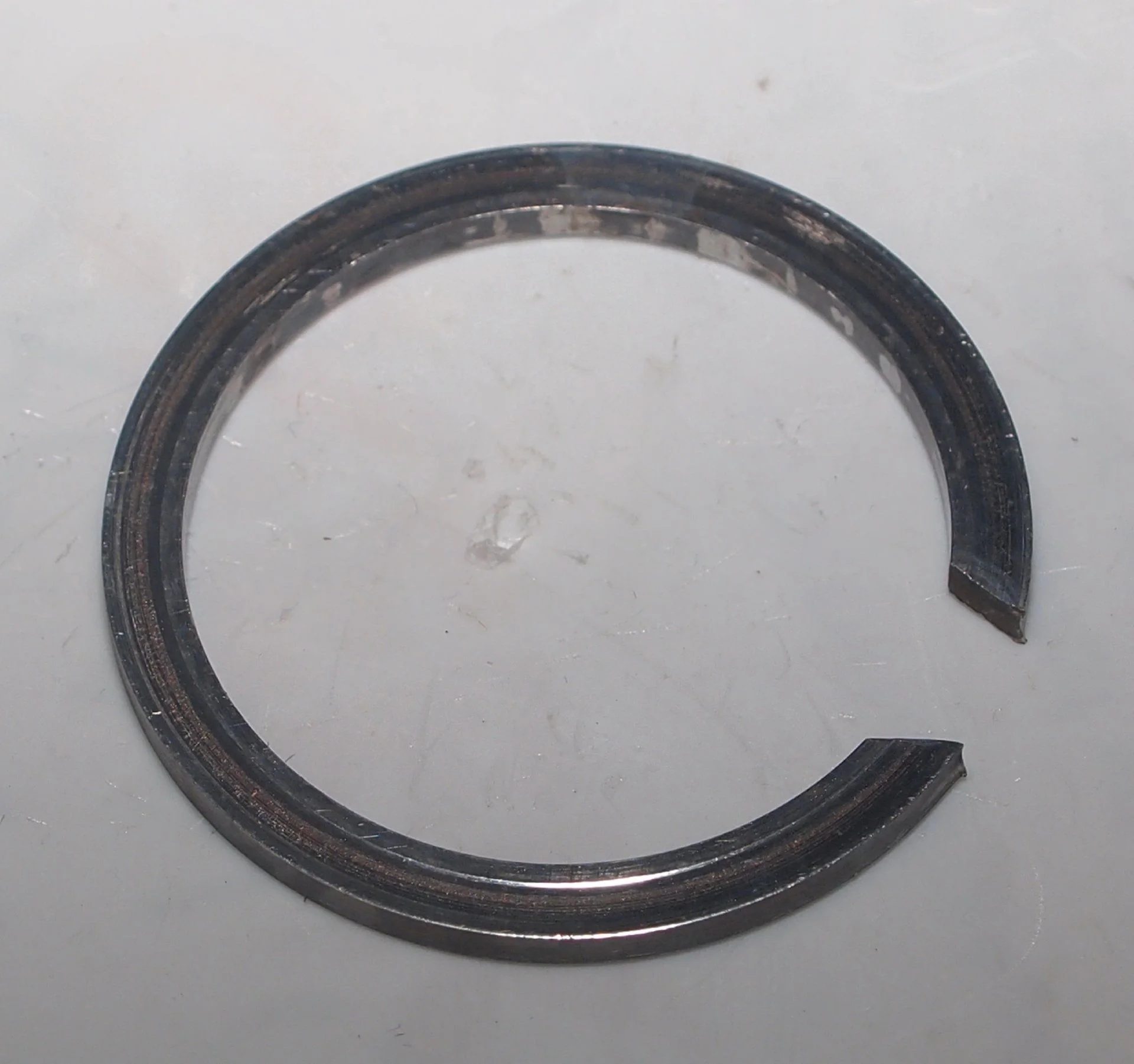

Trashed snap ring which are not reusable, and score cone washer that needs replacing.
2012754
2012757
If wheel bearings properly service, those parts would look like new and be reusable time and time again. I'll bet 1 millions miles or forever. I've found wheel bearing actually get better with use, if properly services,
