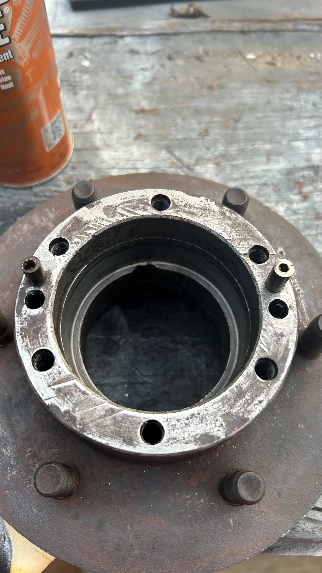

so, I'm cleaning up this hub and notice a stud broken off right at the top of the hole. I then looked at the others and sure enough right across there was one broken off half way down . Gosh I literally drilling and tapping broken studs/bolts....just hard for me. But anyway, I did get two holed centered fairly well, so as I was drilling the first one, I noticed the broken off stud was rotating along with the drill bit...hunh? Sure enough the drill bit actually pulled it straight out of the hole and there were no threads on it. The other one was the same way. Also, I thought I would take a small punch and clean out the holes, but weirdly each hole feels like there is a piece of rubber at the bottom....So, can you seasoned mud heads can enlighten me on what this is and especially what to do about replacing whatever these buggers are.............Thanks in advance
