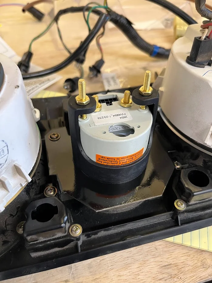

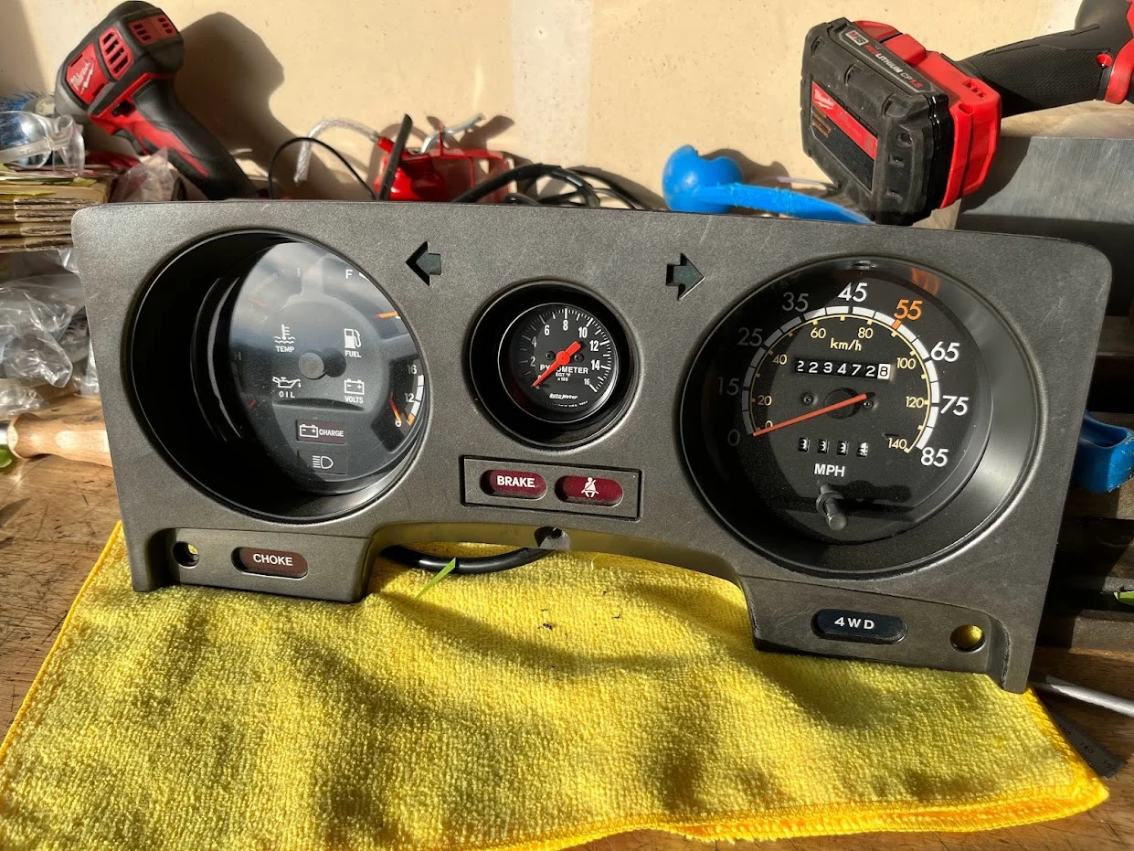

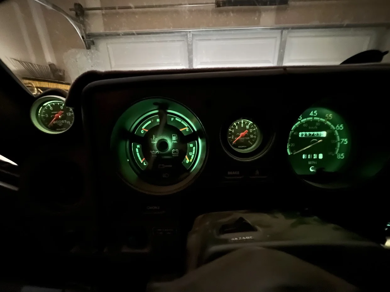

For the gauges, I replaced the factory tachometer with an EGT gauge and added a boost gauge in the left corner of the dash.
Made a simple plate to hold the EGT gauge.

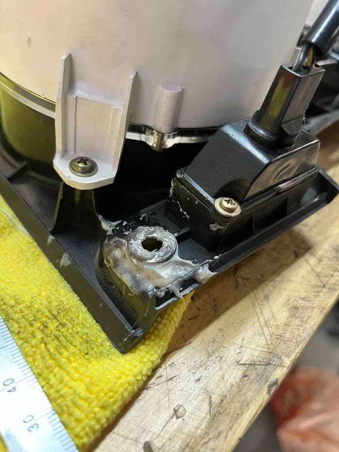

I also repaired a broken bolt hole for the dash panel with some JBweld plastic specific epoxy and a washer. Looks like crap from the backside of the cluster, but works great and isn't noticeable at all when installed.
New gauges are wired to light up when the headlights turn on. Lighting thankfully matched the OEM green nicely.

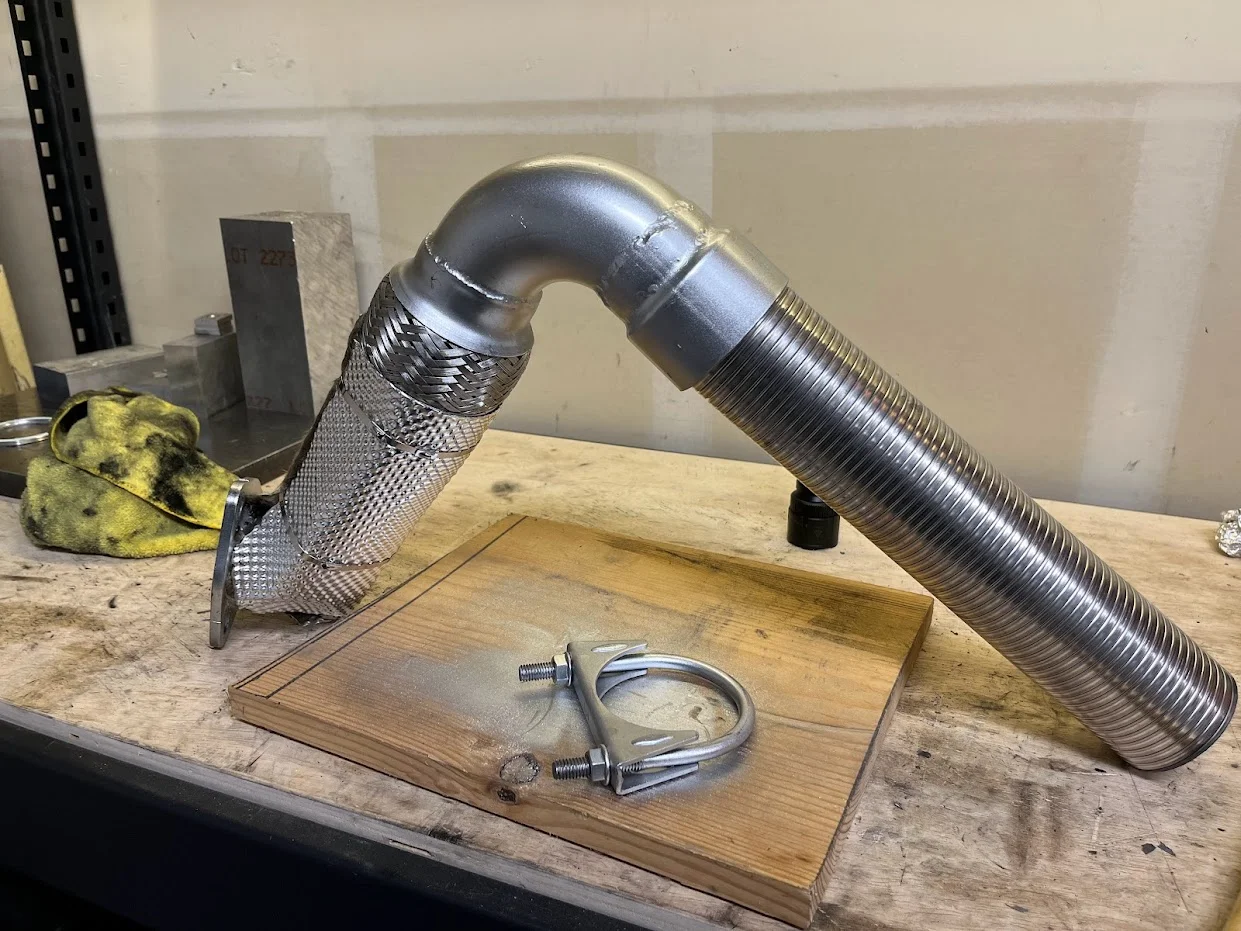

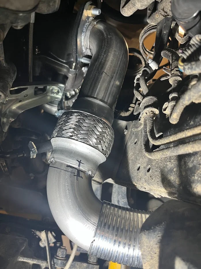

Made a real downpipe and connected it to the rest of the exhaust. Then re-made the lower portion to work better with the flex pipe Im using for now to get around the frame rail. I definitely found the limits of my ability with a TIG on this project and was wishing I would have just bought a MIG. 🙃 Eventually I'll take it to an exhaust shop and have a good 3" setup made, but this is good enough for now.

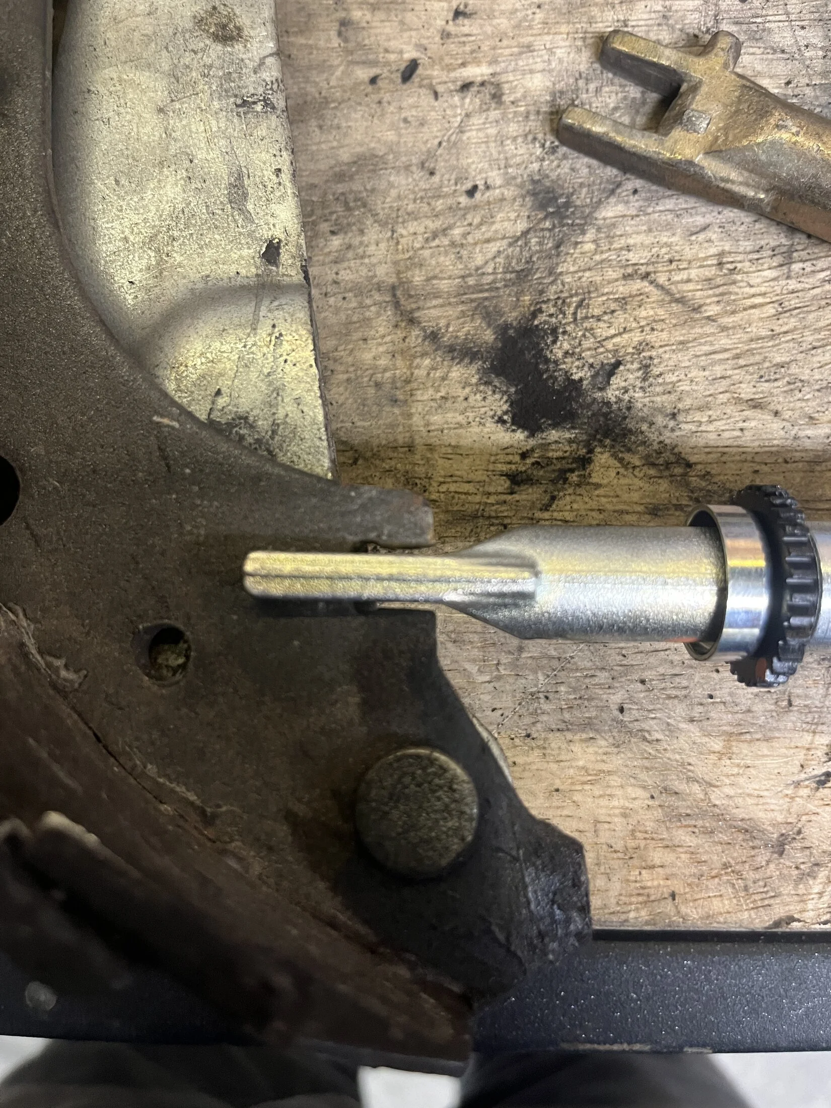

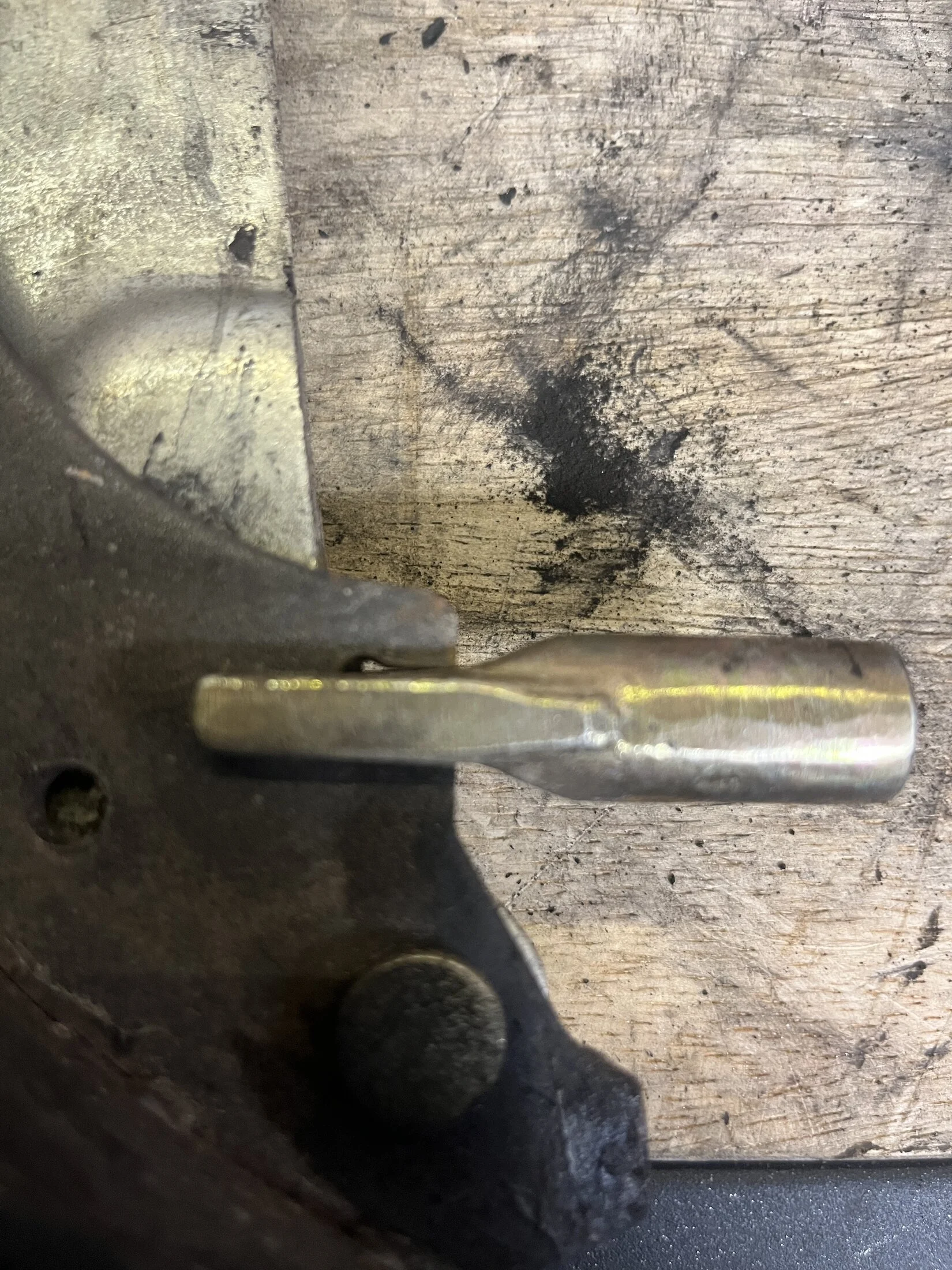

Finally got tired of not being able to drive the 60, so I ordered a few parts and rebuilt the rear brakes. I was having issues with the parking brake adjusters over adjusting and dragging. No mater how many times I adjusted them back they would start to bind again after a few parking brake applications.
Once it was all apart it was pretty clear that the adjusters were the problem. The fork end of the adjuster did not have enough clearance with the shoes and was binding, and the floating barrel was incredibly loose also causing binding.
I put these in probably 10+ years ago when I didn't know any better and just bought the cheapest parts I could get. Don't be like past me, only buy good quality OEM parts.
Adjuster PN's:
4706160011
4706260011
Low quality aftermarket adjuster:
Nice OEM Toyota adjuster:
