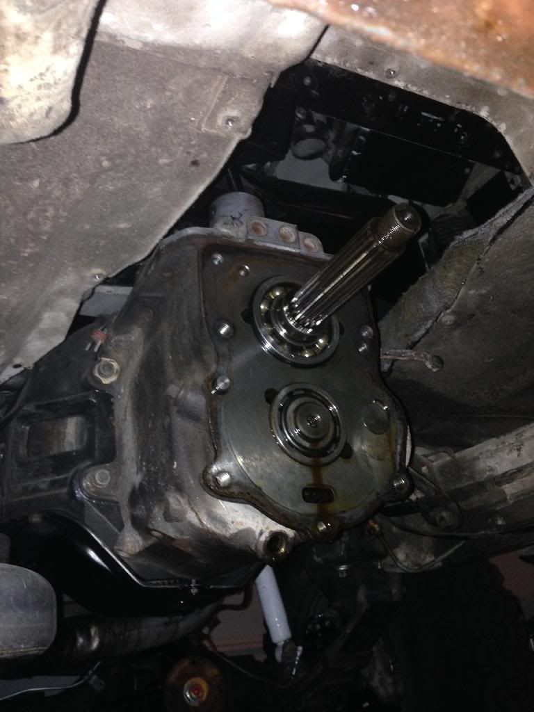

So one thing always leads to another, in trying to get the sliders installed for the LSLC Roundup in March I ran into an issue. My exhaust is currently run down the outside of the DS frame rail, exactly where I need to mount my slider :frown: Having known for a while that I was going to have to rework my exhaust when I did the H55 swap (in the way of cross-memeber mount), I decided now is the time to install this bad boy:
So I got her situated for an extended stay in the garage and pulled the front seats, transmission hump and drive shafts :grinpimp:
Split-case comes off tonight, got me a fancy new transmission jack I'm hoping makes the job easier.
Stay tuned ...

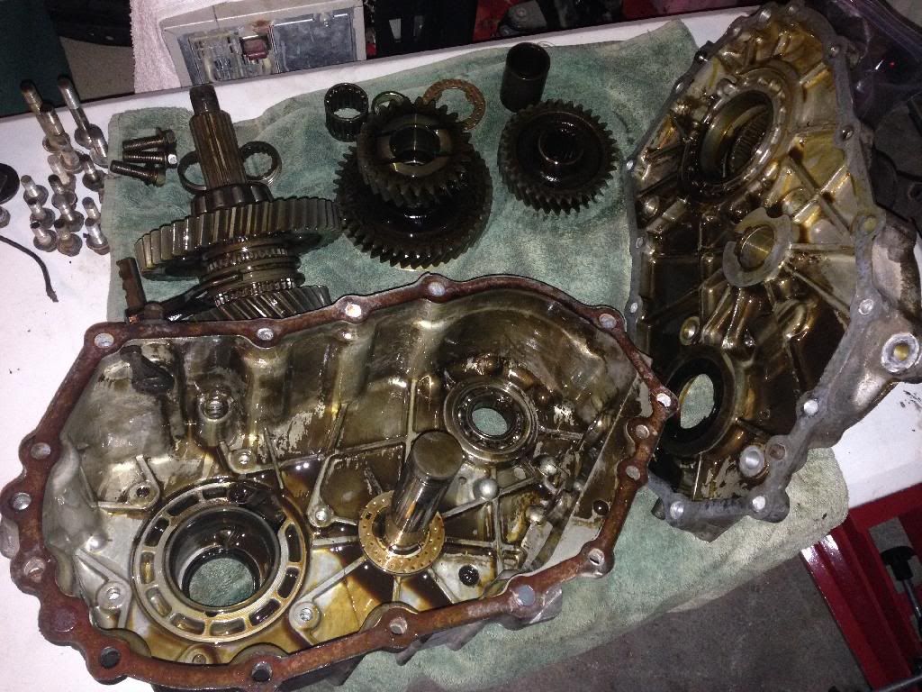

Tucker
Tucker,
That case looks a lot cleaner than mine, starting out. I thought it was one of the fun things to rebuild, on the wagon.
Was pleasantly surprised with the condition of the case inside, broke a couple of bolts in the process of taking it apart that aren't gonna be fun ... but that's how it goes.
