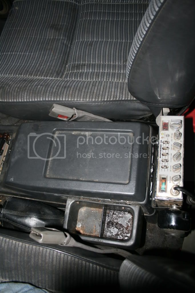

This was the only spot I could make my radio fit but I'm happy with it. I didn't want to run a small radio that would fit in the dash, mainly because I had this one and another Galaxy laying around already. :D
It's a Cherokee Nightrider I've had for a few years. It's been Tweaked and Peaked to 18 watts. Always been a good radio and tends to get out alright for my cheap trail setup.

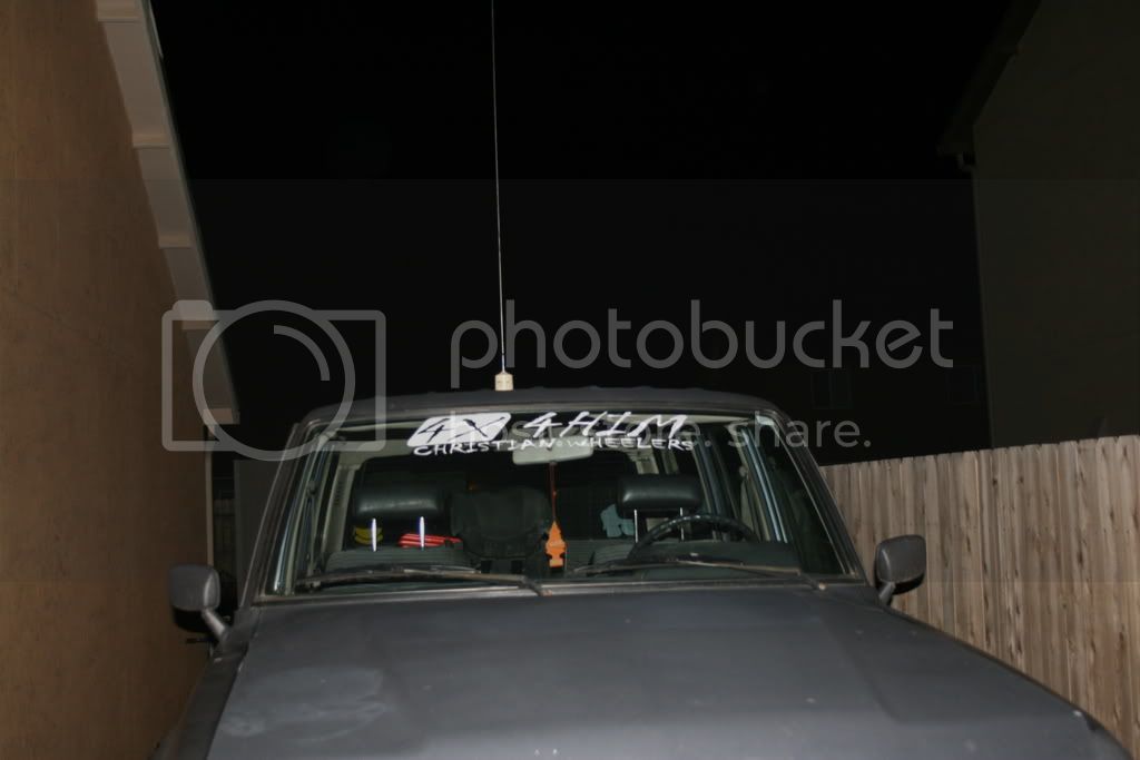

By the time I got home it was dark so these are the best I could do for the antenna.
It's not centered due to the reinforcing ribs that run the length of the roof but I'm happy with how it turned out.

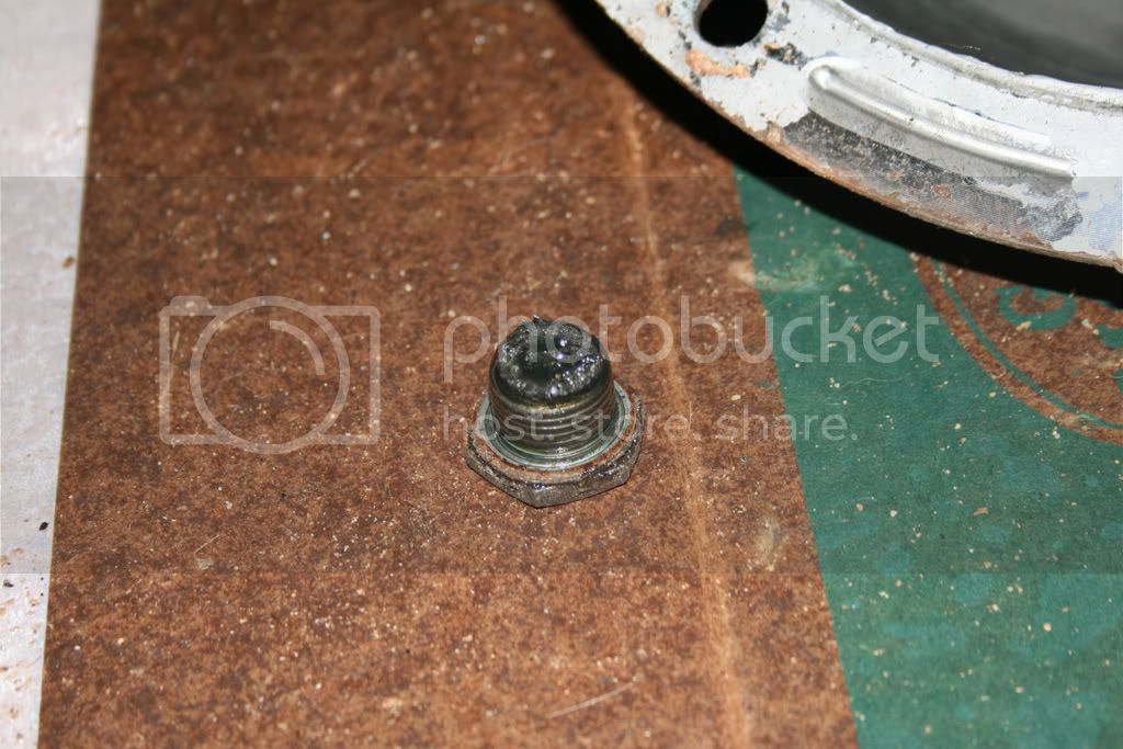

I pulled the drain plug and saw this.

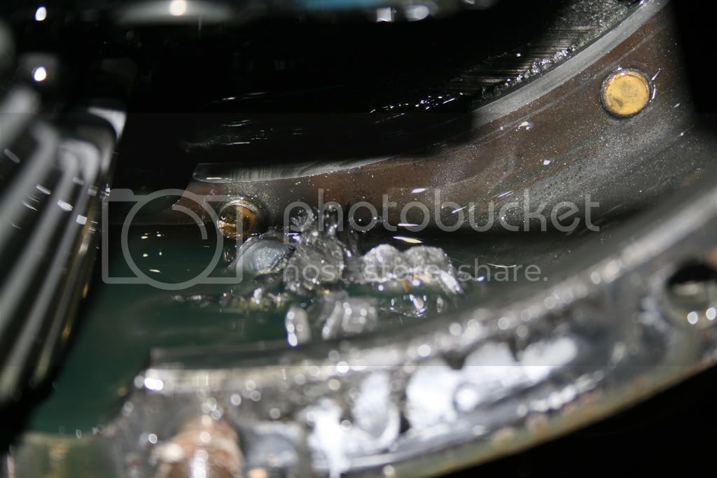

Drained the fluid and tore the rear cover off.

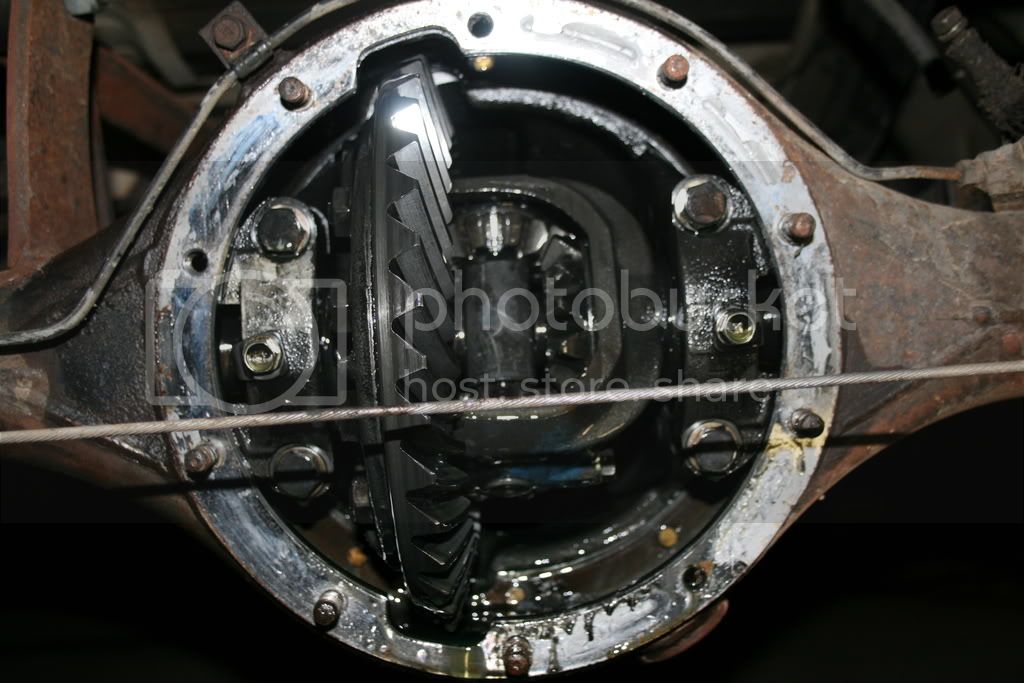

Bit closer. Somethings missing. :hhmm:

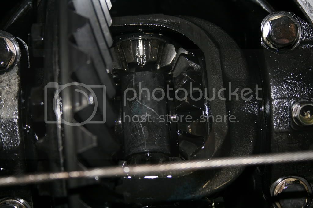

Ahhhh, there it is. Ummmmm chewy.
I had never welded a Cruiser diff and was a bit timid around the edges of the side gears as I didn't want to kill the bearings. I went a bit light on my heat and definitely not enough welded surface.
Next time I have some time, I'll get the third all cleaned up REALLY good and tack it as it sits. I'll pull it from the housing and weld it up REALLY good on my work bench.

Just pull out the spider gears and clean them and weld up a few of the valleys. That should hold up real well and you can use plenty of heat.
I am not so sure, I had a buddy with a welded centre and it kept breaking till I welded the side and spider gears together then got some 5/8 bar to go as filler between the gear teeth and welded that to the gears.
looked like a right mess, but it held up
