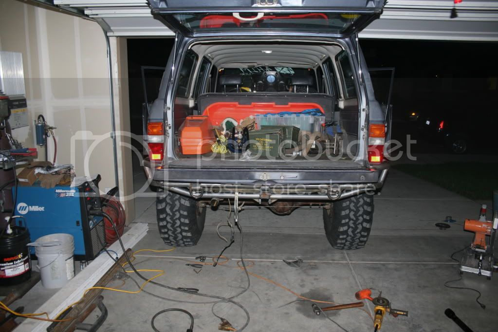

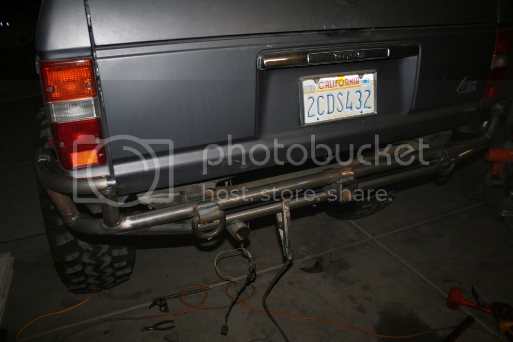

That looks awesome, but you can't open your tailgate. The tube sticks out too far, right?
That looks really nice man! Any pictures of the mounting brackets you made? Did you cut out the factory crossmember back there?

I actually have this welded (tacked for now) directly to the frame. I notched the frame so the tube sits in it real nice. I angle cut the frame so the lower tube is closer to the body than the upper to aid the departure angle.
I'm out of town until tomorrow but after I get it all finished up, I'll try and remember to get some more detailed pics.

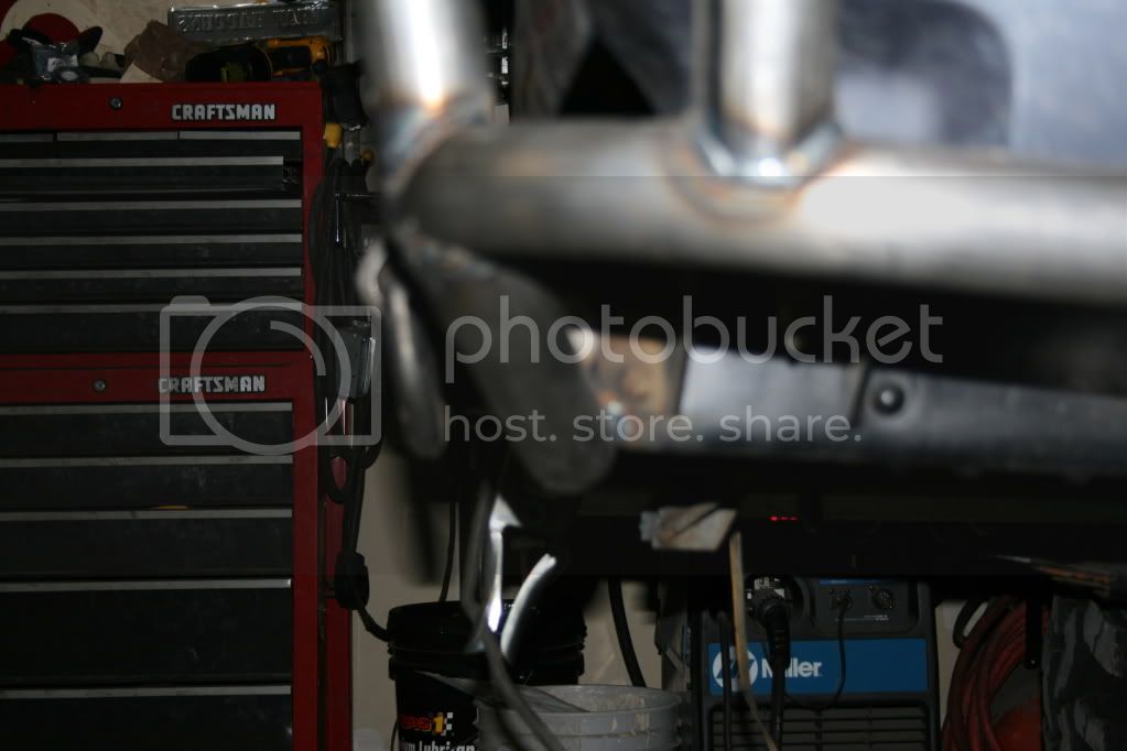

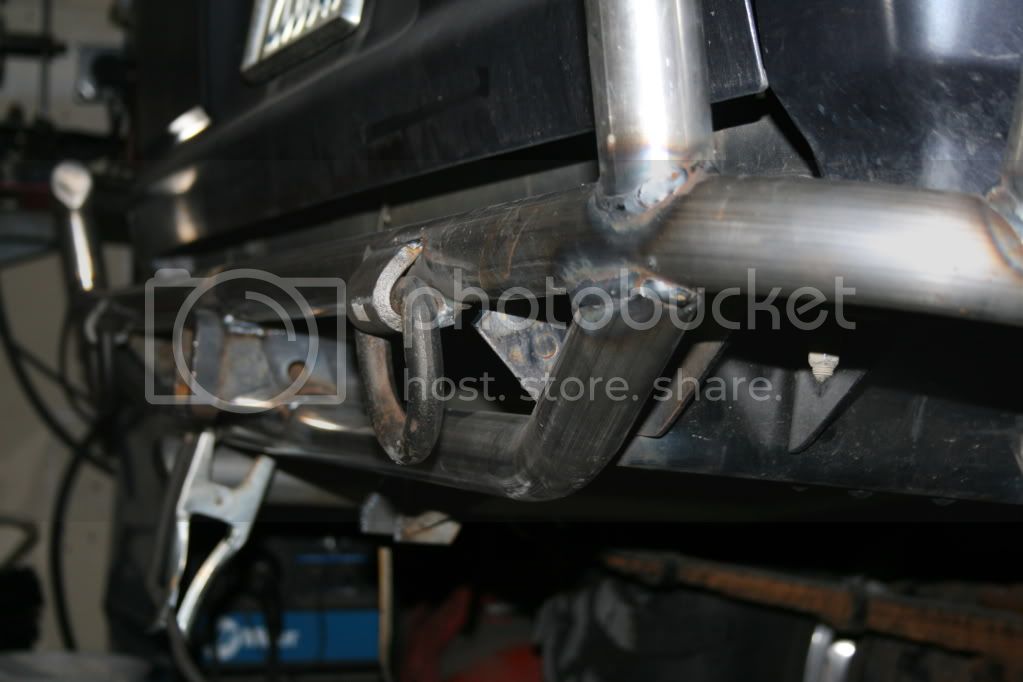

Few more pics of the rear bumper. Got it all cleaned up and finish welded. Should get it painted in the next couple of days.

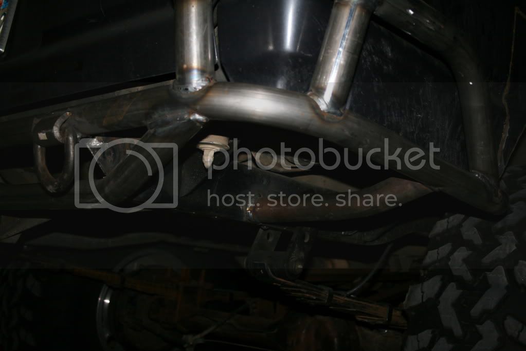

You can see here how I angle cut the frame to aid in departure angle. also gives the bumper a bit more depth rather than placing the lower tube directly below the upper.

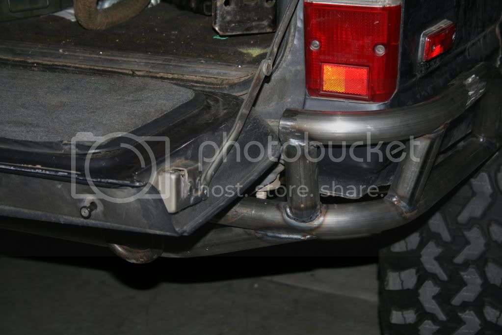

Another
My runner for the quarter support.
