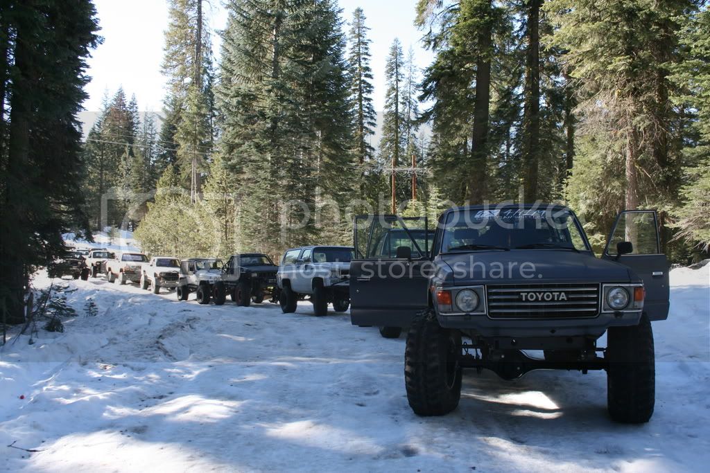

Not much of an update. Been working A LOT lately so no time for the cruiser. Been driving it a ton around town and still seems to be doing great. I finally got up for a snow trip this weekend. I put the word out that I was taking the day off work specifically to go up the hill. Had a few people show.
I think I counted between 15 and 20 rigs. :lol:

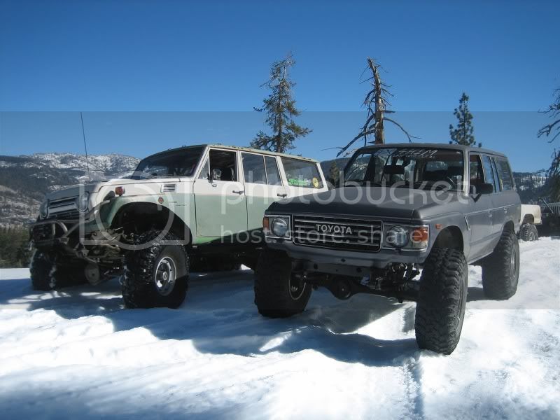

Had a great time even though the snow wasn't the best. I got to have a nice day with my wife, my kids, my cruiser and a bunch of friends. No action pics of mine that I've seen (I was @ the front of the pack) but heres me and Frizzlefry with his 55.
My Cruiser did great all day. I was super happy how the Iroks did even at only 5 and 4 psi. (definitely could have gone lower but didn't need to) I was even more happy how well it did when I figured out my welded rear was only spinning 1 side. I figure either the axle splines or the spiders stripped as there definitely hasn't been any loud bangs or grinding. I also realized this happened on my first trip out a couple of months back. :rolleyes:
