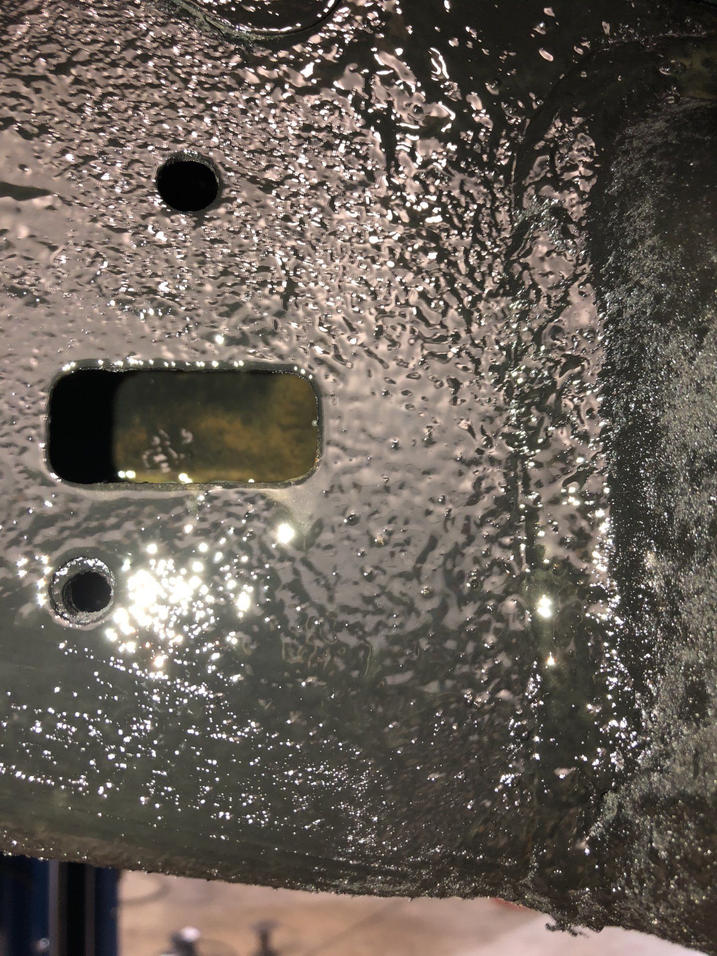

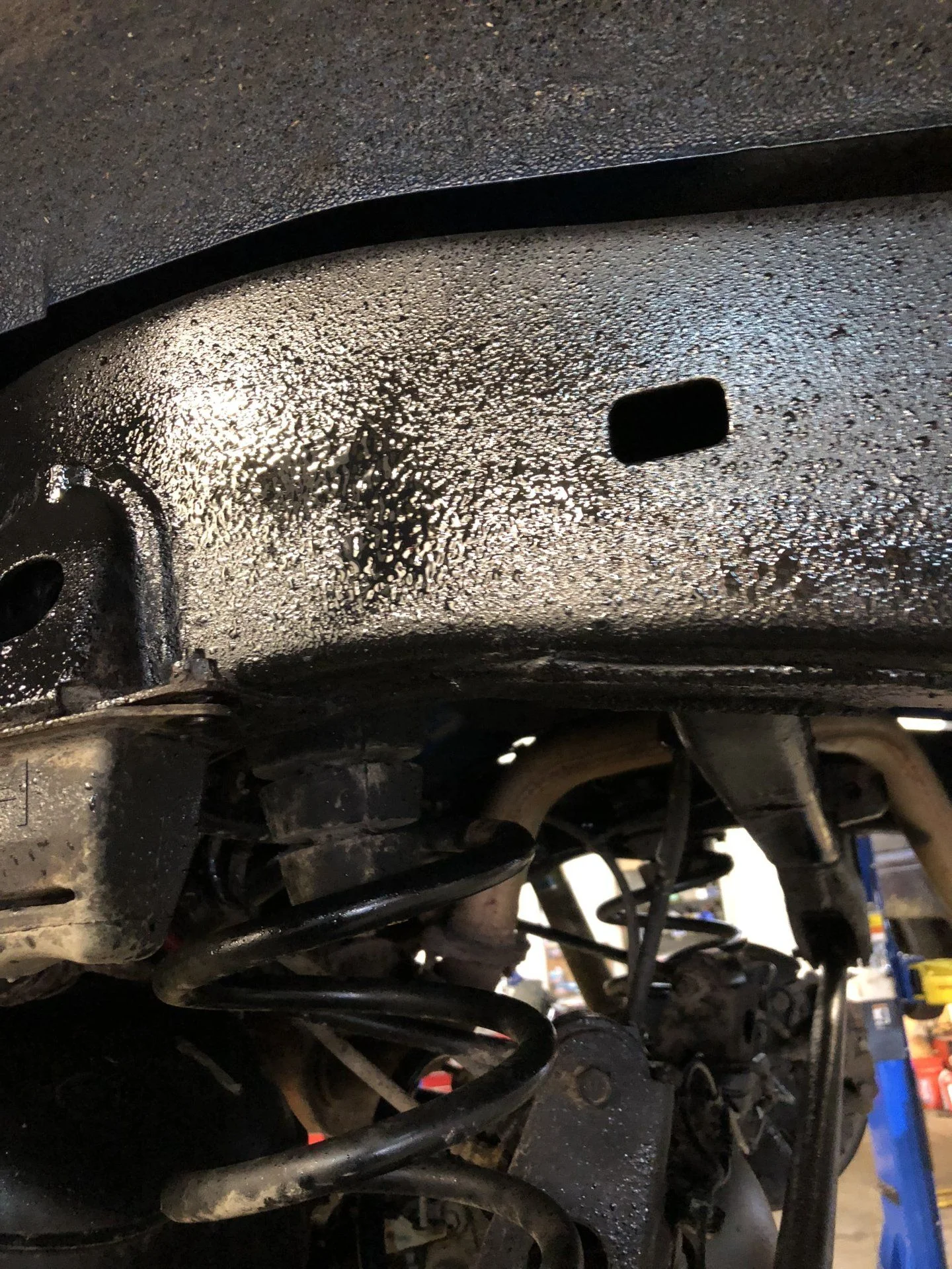

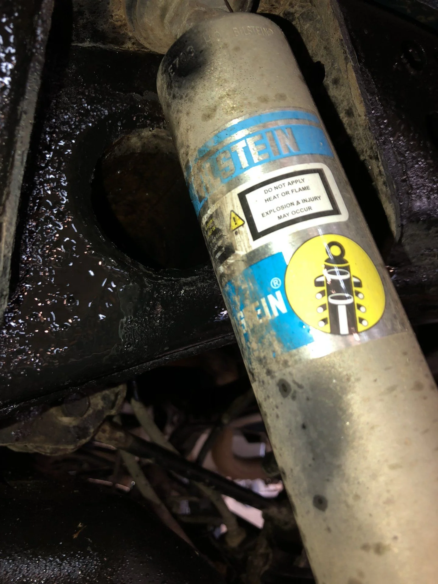

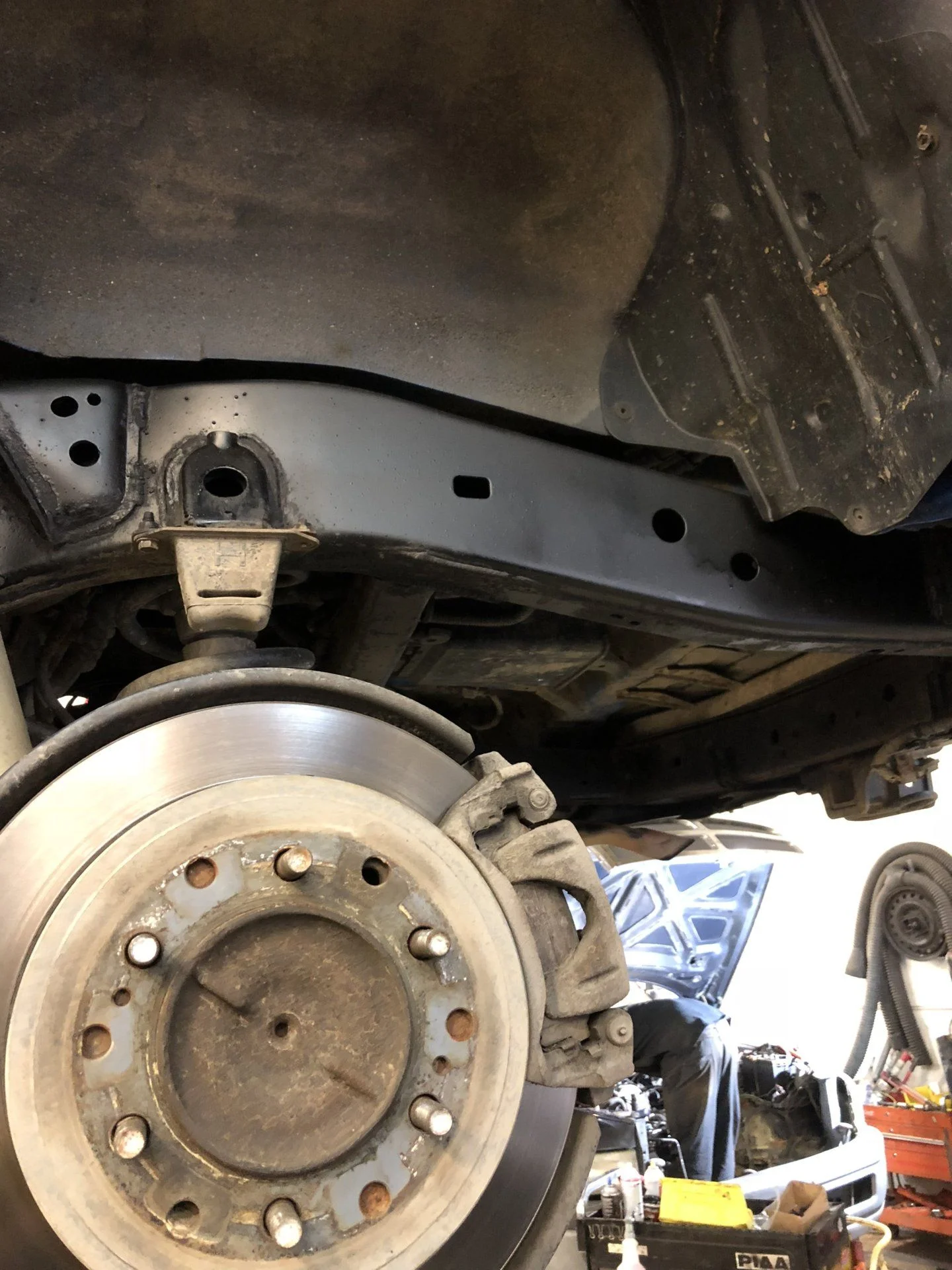

So I finally got around to this today. The application nozzle works awesome and best inside the frame, and makes a huge mess outside, but having it slung everywhere is far from the worst thing. We charge roughly $150 for the application of it, which in my opinion is very fair as it took me a shade over an hour to get into every nook and cranny of the frame. Anyway, on with the pics.
I believe it stays “wet” so to speak. My fj is the second vehicle we’ve done. I do know that it is by no means permanent, and will ultimately need to be reapplied. How soon remains to be seen.
I like the idea, but if it stays "wet", or even tacky, that could be a pain when you're working on your truck. Let us know how this sets up. I may want to do it on the Tundra.
I would do it to most of your trucks. I won' on mine because I weld on it. I bet that stuff burns
As of tonight it is a bit on the tacky side. I don’t think it would bother me while working on it, I don’t really do that much frame contact unless I’m really getting into it.
