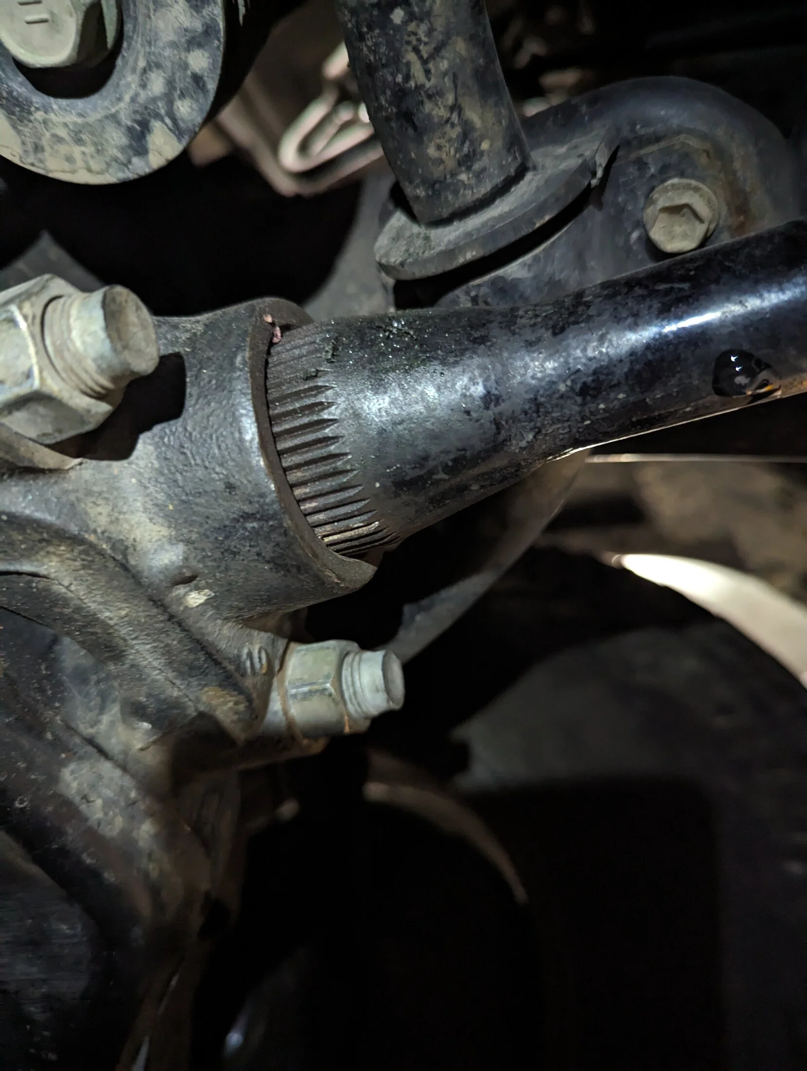

Are the TB splines supposed to protrude this much on the passenger side??
I'm worried my TB isn't fully seated in compared to the driver side:
I had reindexed the passenger side when I couldn't crank any further to get to my desired lift of ~1.5". This was about 6 months ago/a couple thousand miles (highway and off-road ). I guess I didn't pay close attention to it back then. I only barely just noticed after going back down under the truck just now to do an oil change. The suspension and steering feels fine otherwise.

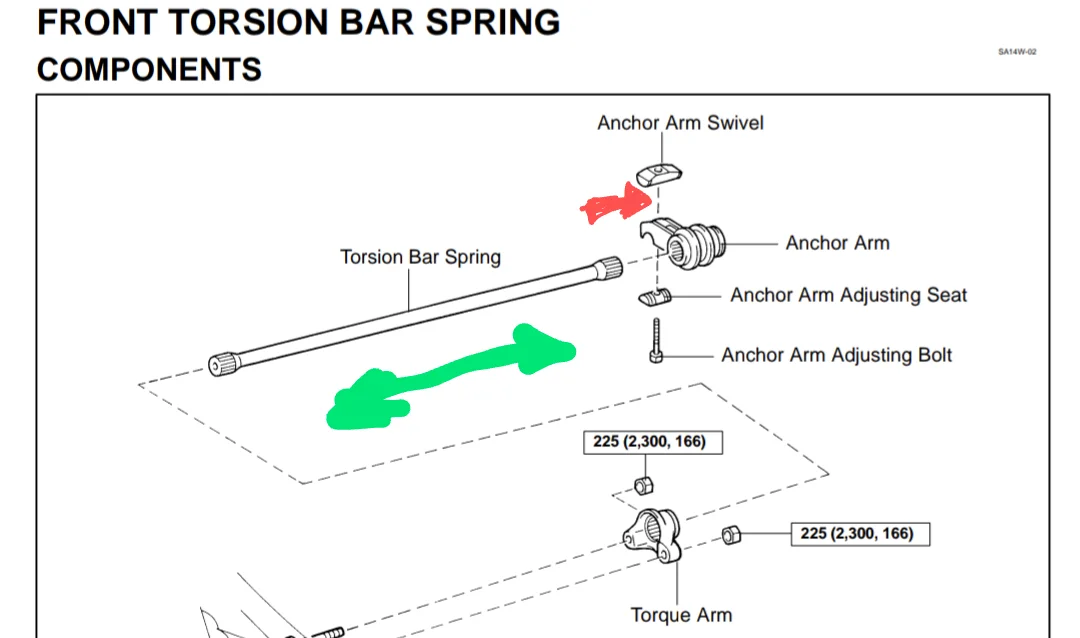

NVM, I had a chance to go down again and loosen everything up. I'll post here because I don't recall seeing it mentioned or maybe I skipped over it:
When reindexing your torsion bars, make sure to seat them in an equally distributed distance between the front torque arm and the back anchor arm. The anchor arm is pretty deep and so my torsion bar was pushed all the way back in there leaving a lot of the front splines expose out of the front torque arm.

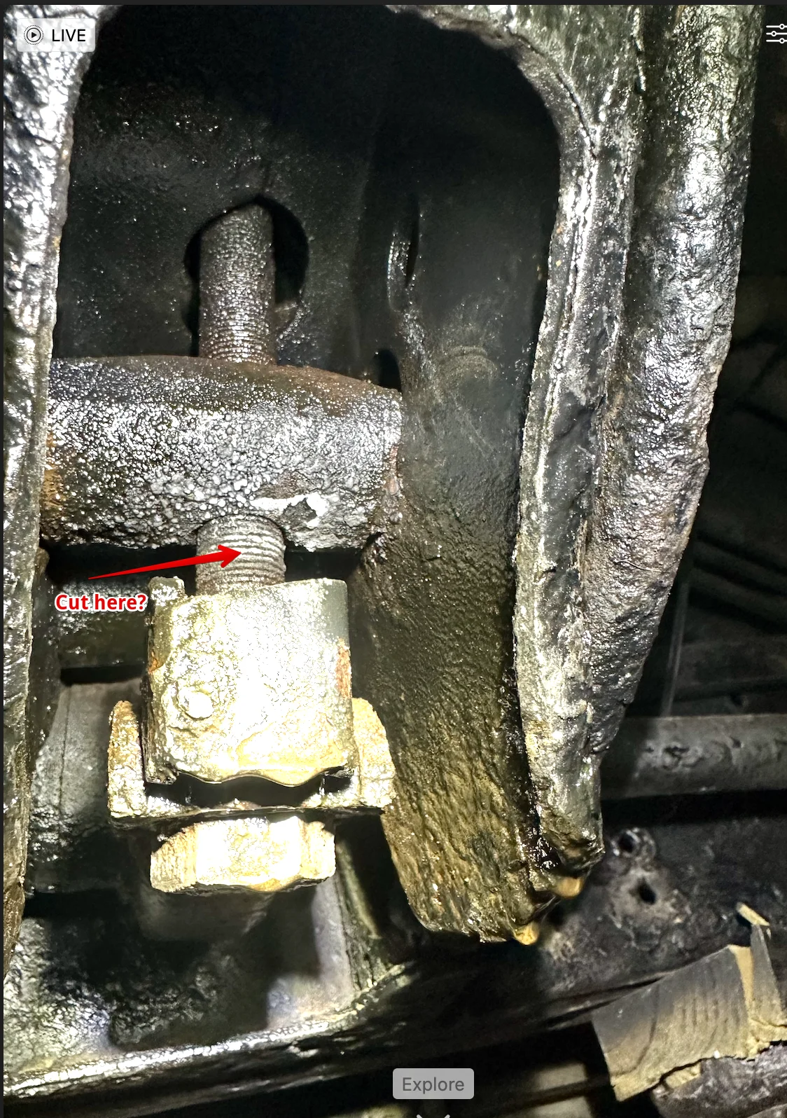

I have a 2002 Landcruiser and need to raise the front by about 0.75 inch because of a heavy ARB bumper and winch. Both sides are currently ~19.0 inches from the middle of the hub to the fender, and I have read the factory height should be 19.75 inches.
The rig is completely rusted everywhere, and I have tried every trick on this forum to move the torsion bar adjustment bolt to no avail:
  • Both front tires off the ground
  • Tons of PB blaster
  • Torch heat
  • Impact wrench
  • 24 inch breaker bar
So I I’m down to cutting the bolts off as my only option, and have ordered 3 new parts for each side to replace:
My question for you guys have to do with the consequences of just starting to cut off the adjustment bolt:
  • if I use a Sawsall to start cutting at the arrow shown in the picture below, what happens when I get all the way through?
  • Is there so much tension on the “anchor arm” that it’ll snap down and is it dangerous to do this?
  • Is this the right way and place to cut the bolt?
  • When I replace with new hardware, is it as simple as just screwing the bolt into the new bolt until I achieve the proper tension and height?
Thanks all,
    If the truck is jacked up you should have no to very little tension on the bars.
    Probably not.
    That would work.
    Screwing the bolt into the new bolt does not compute. Just replace all the new stuff the way the old stuff is in there. Reindex and tighten. If you turn the bar too far your adjusting bolt will hang below the yoke and can get buggered on rocks.
    Probably not. Need to have the truck jacked up to have pressure off the bars. Go slow. It shouldn't "explode" and shoot anything across the room.
    That would work if you can actually get a saw in there.

I might agree with you if it was an LX, but I had a corroded bolt fail when I was trying to tighten the TBs when my truck was on the lift, and it was quite violent.

I guess it depends on how tight it is at first. When I adjusted mine they were pretty loose when lifted off the ground. I guess it depends on its current position. You can feel the tension on the adjuster if you just reach up and try to twist the whole adjuster.
Are you running aftermarket TBs? I can imagine thicker bars would have less tension when unloaded. I still have the original TBs.
OME. I concur with your thinking. I guess they could be pretty tight.
There is not a lot of room in there to work.

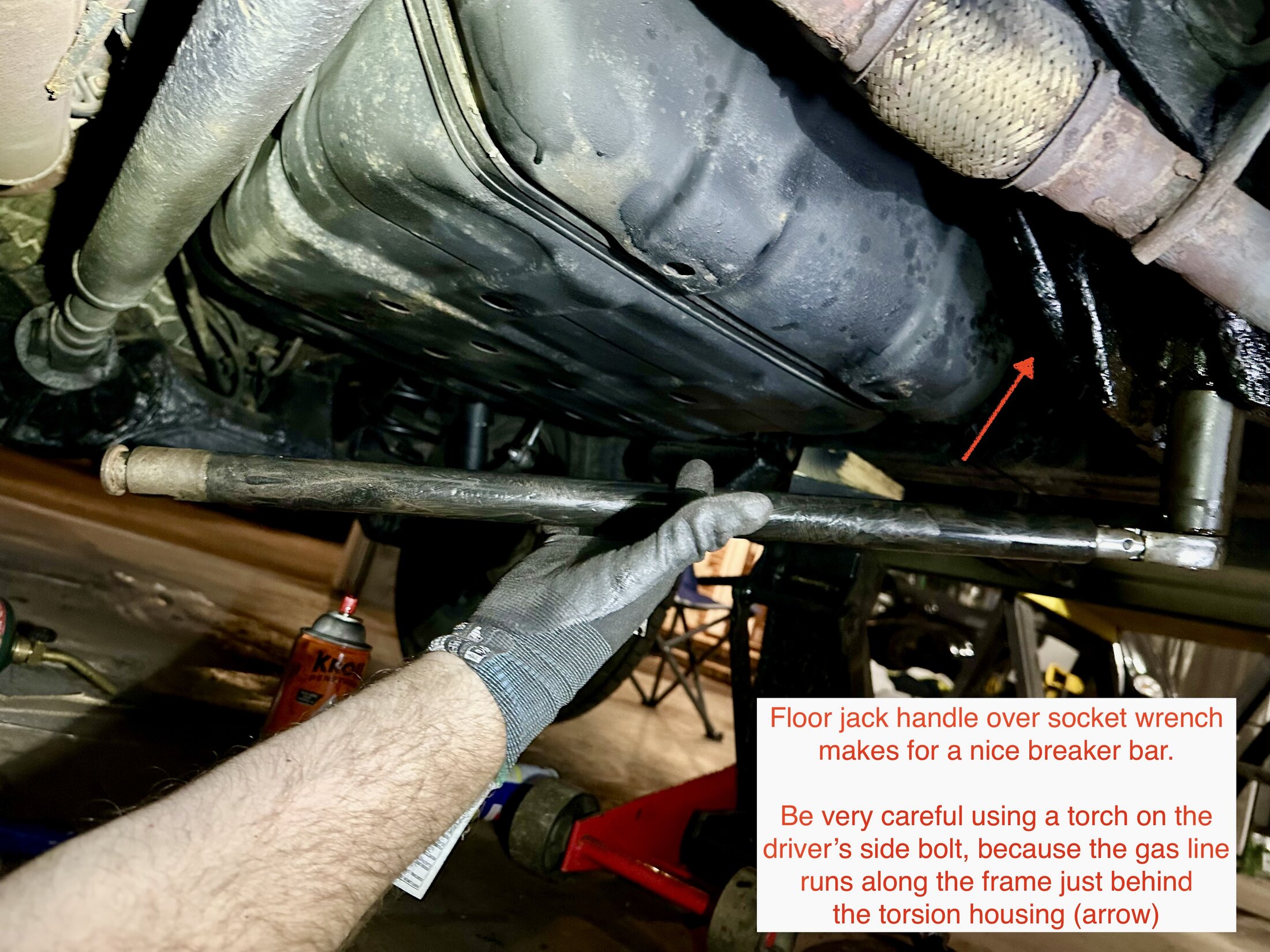

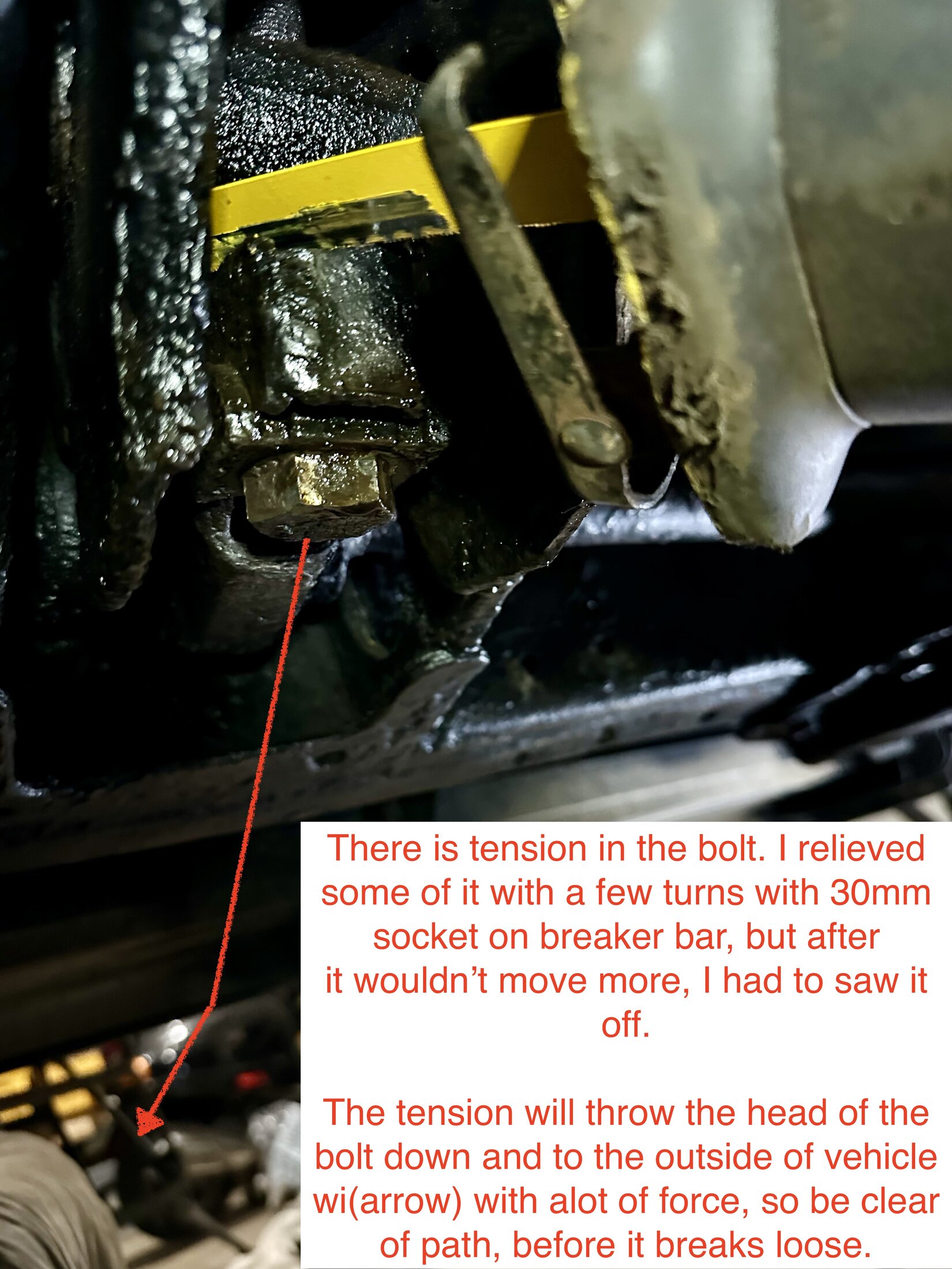

I finally was able to get the torsion bar adjustment bolts out and install new ones, but it was quite an ordeal. After days of Kroil, torching, breaker bars, and impact wrenches, I was still only able to move the bolts a little bit on each side. There was just far too much corrosion on threads once it all got pulled into the crescent nut to move any more.
On the passenger side, I was able to remove all the tension before resorting to the Saws-all. On the driver's side, I moved the bolt a few turns, but then would not budge. I was reluctant to use the torch more on that side because the gas lines run right behind the adjustment bolt. For anyone else attempting this, there is DEFINITELY TENSION IN THE BOLT. But the torsion arm only releases an inch. The head of the bolt with shoot down and towards the outside of the vehicle, so stay way clear of that projected path when sawing. I attempted to show this in the pictures below.

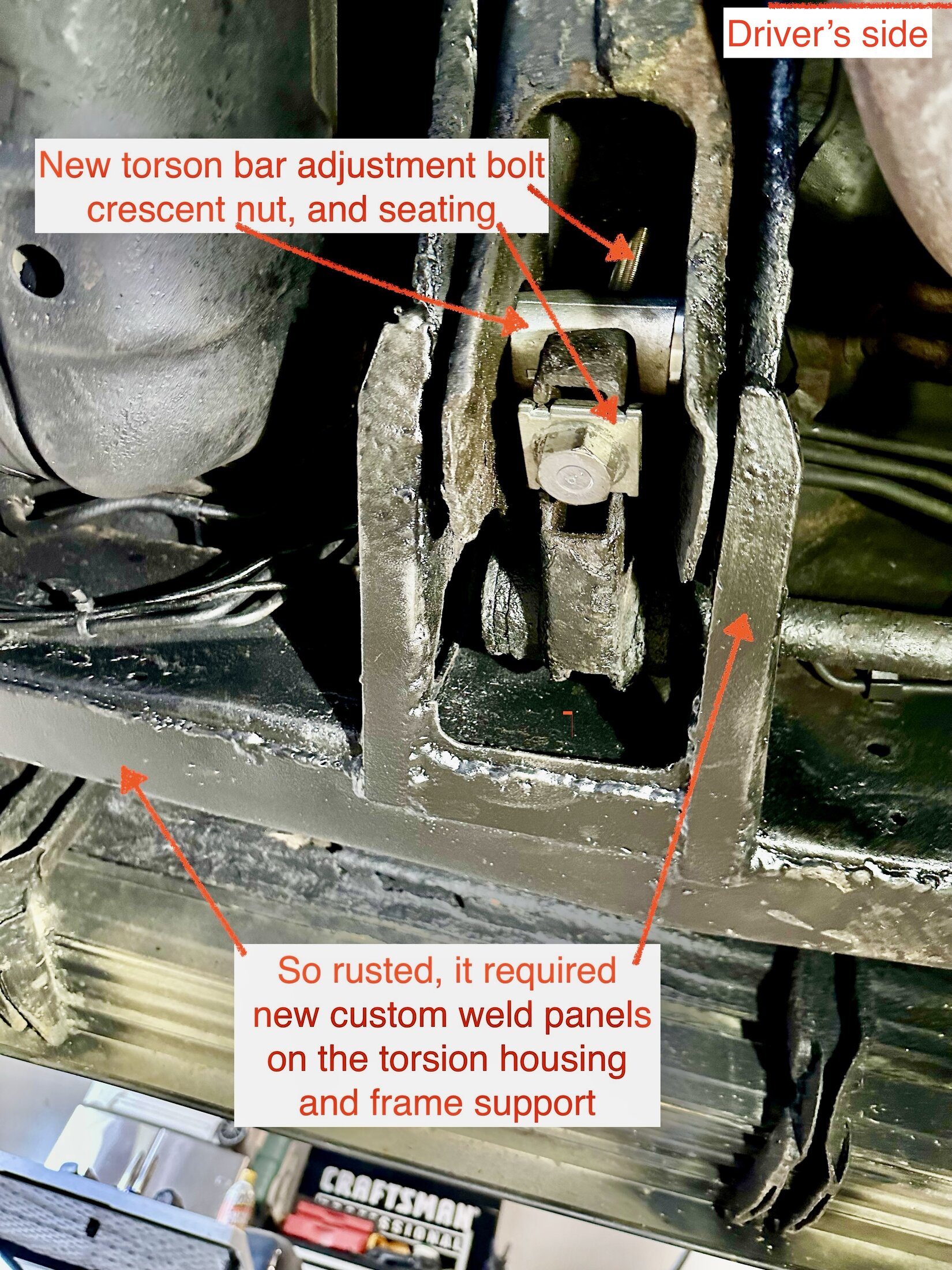

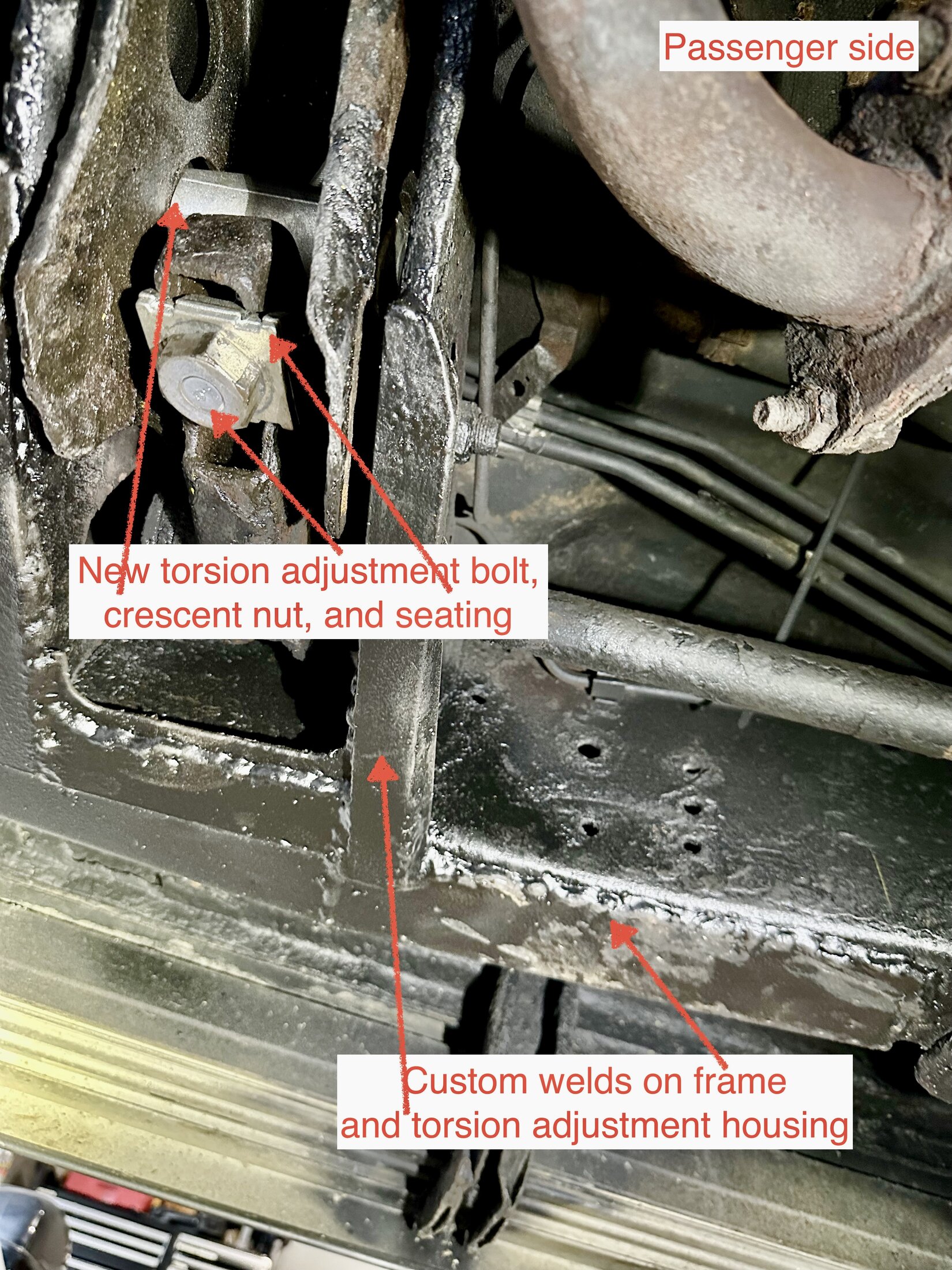

In the process of all the pounding, I noticed that the mounts holding all of the torsion adjustment pieces was really starting to rust out and I became worried the entire mount on both sides might completely break free. So I took it up to a local shop in Danbury, CT and they did an incredible job in only 2 hours with fabbing out new supports and shoring up the frame around it. For anyone in the northeast area and in need of anything like this, these guys are incredible and i highly recommend - talk to the owner Ed at Danbury Auto Springs and Welding. Pictures are below.

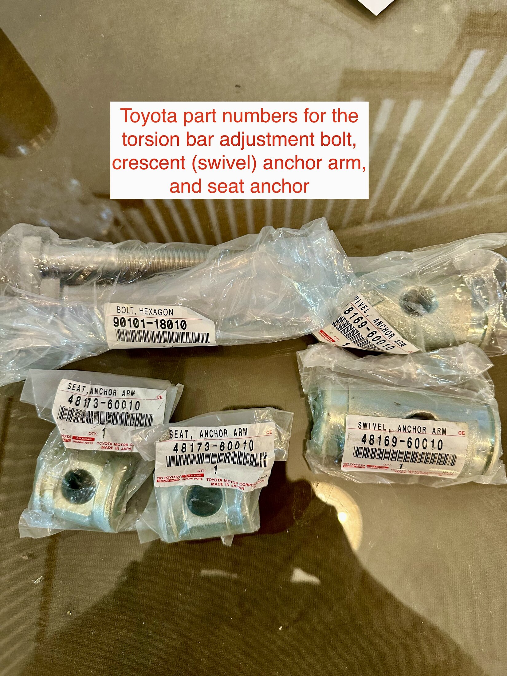

I've also shown pictures of the 3 replacement Part #'s (1 set needed for each side) and it is definitely worth the cost given how easy it is now to adjust everything as I fine tune the front height after installing new OME 2860 springs in the rear.

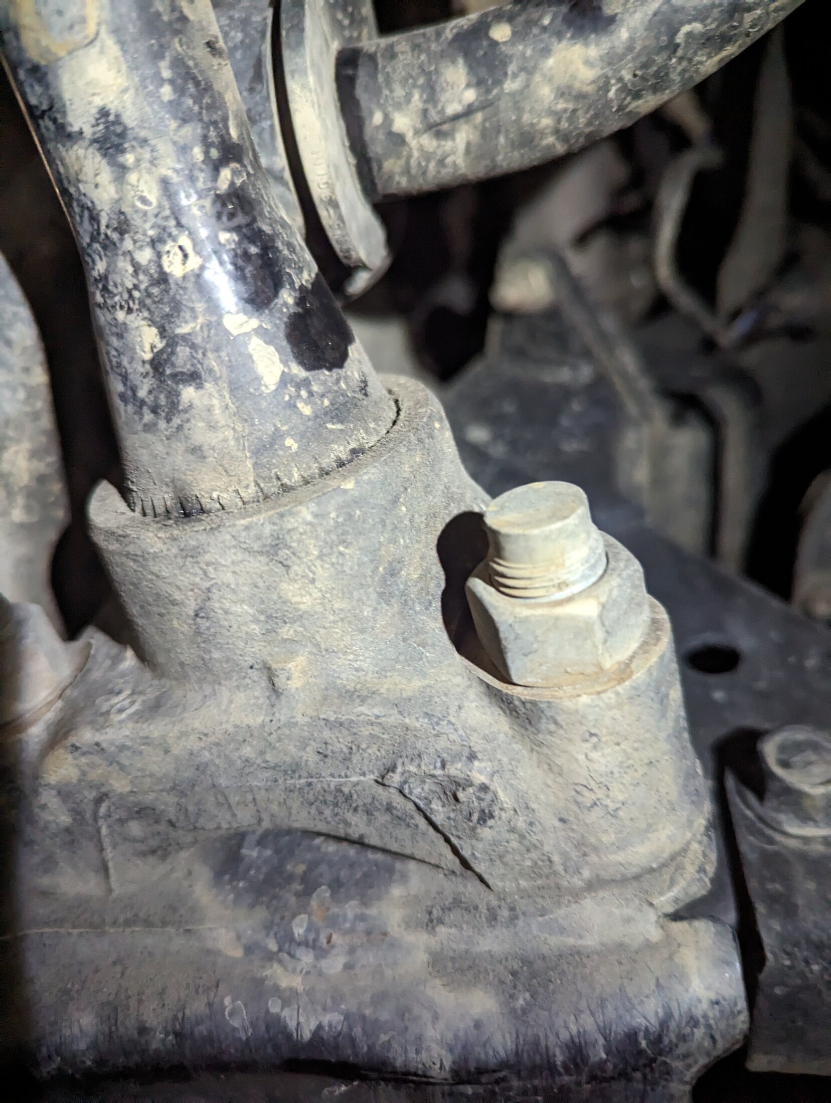

Sorry to bump an old thread, but I'm a little stuck. I have followed all the directions but I cannot get either one of my torsion bars to budge in either direction, I'm not 100% sure what to do. The truck really doesnt even have much rust on it and from what I can see there isn't really much rust on the bolts.
I have the front end lifted, and I've tried everything that I know. An impact in either direction gets me no where, my 4ft breaker bar won't budge in either direction with my full strength on it. I had it soak over night absolutely drenched in pb blaster then tried again this morning and it still wont move. I have tried light impact to the frame area and bolt surface to jolt it. They will not move even a mm, its just completely seized in. Is there a trick that I haven't read about somewhere to freeing them up?
I thought about using a propane torch, but im honestly not entirely sure which area I should put the torch on. The bolt head would be easy, but the actual area that the bolt screws into is kind of hard to access with a torch
Any advice would be much appreciated
On your build thread, it looks like you've been dealing with a good bit of rust on your truck. That plus those bolt threads may not have been worked since new, so I bet they are rust seized in place. Soak Kroil or PB Blaster from the top so it will get down in the threads hopefully.
Heat would be good, but a bigger impact gun is the answer. Bump it IN (up) for a bit, then try to reverse/back it out.
