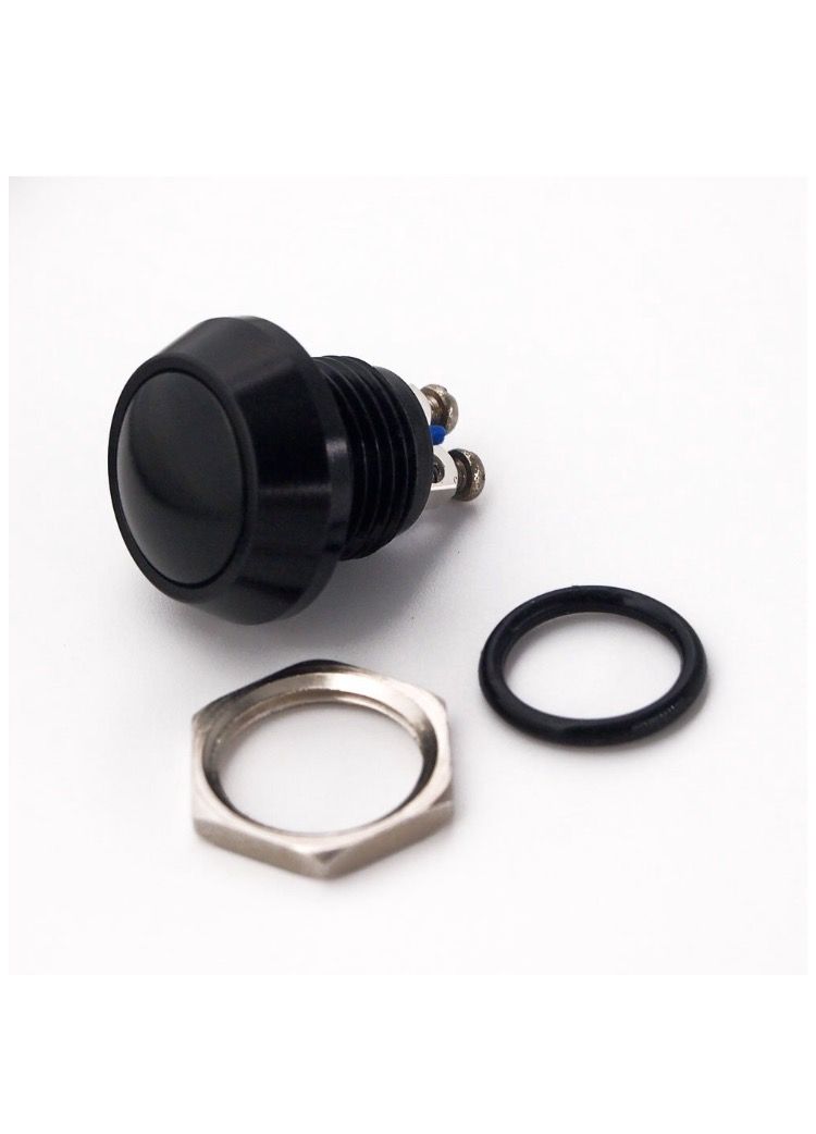

Just ordered a pair of these. They look a lot better than the ones in the kit.

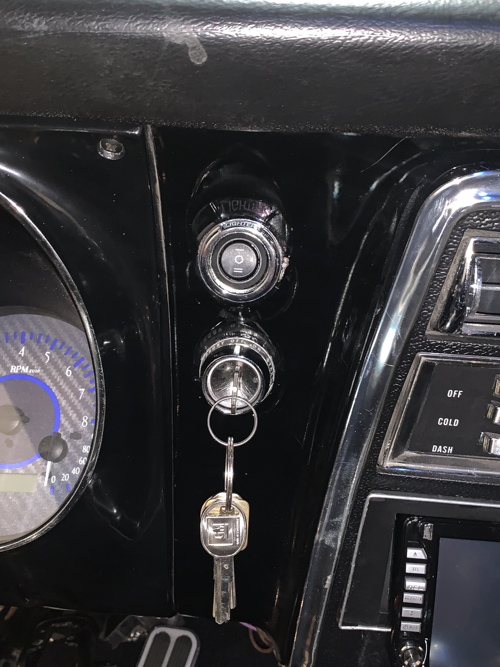

Very old post, but if you don’t smoke use the cigarette lighter and use a double throw momentary switch, here’s mine, 67 camaro.

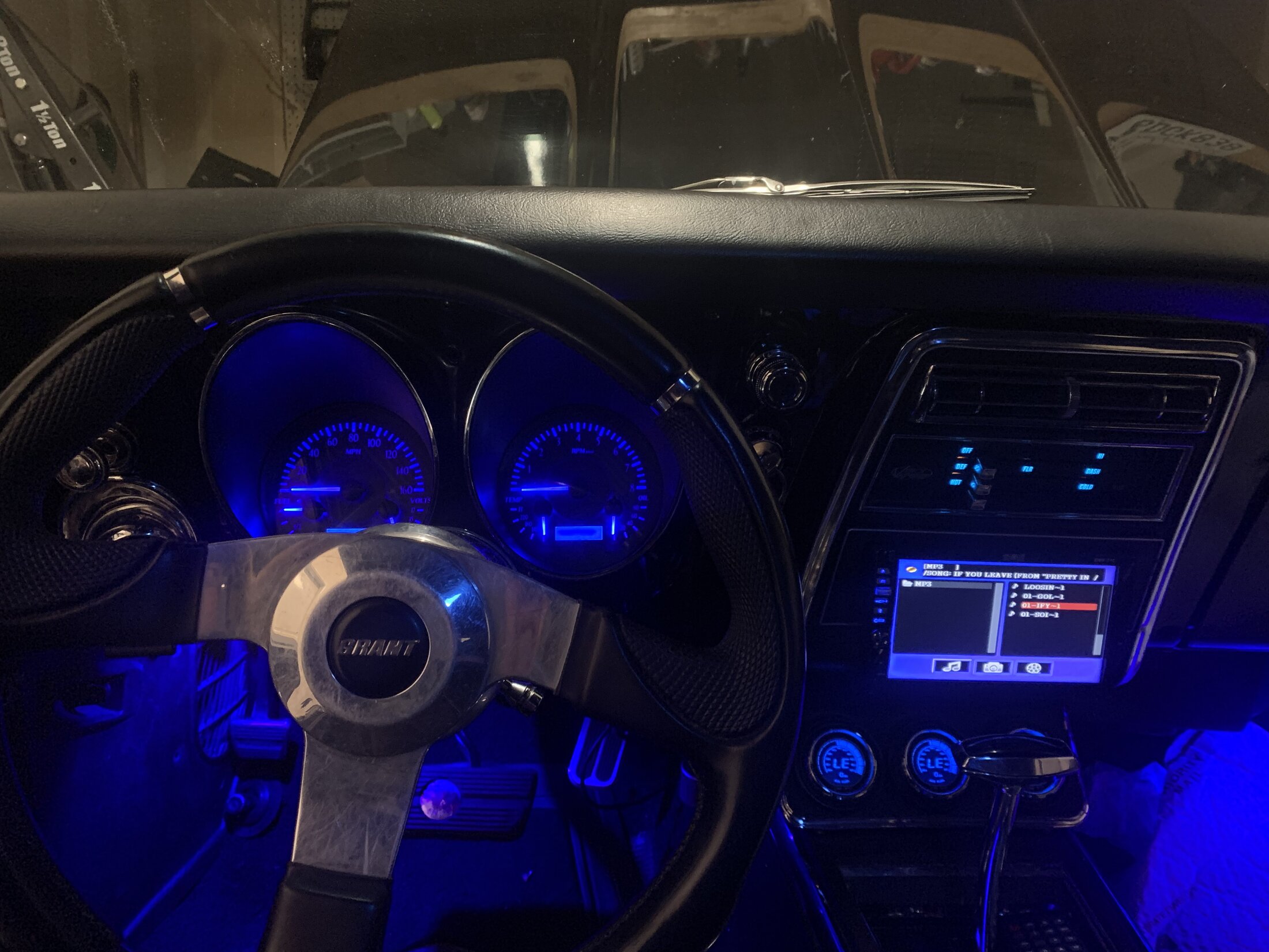

Had our 72 out this weekend, and am using the double throw momentary switch. It took me a minute to remember where it’s hidden under the lower dash pad.
That’s where mine had been, I had it even for a while in the ashtray, then last night I just had this come to god moment and this morning measured, and it’s an exact fit to the lighter, I had a spare base I used and kept my good one if I want to switch back. But works great.

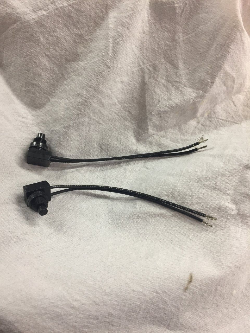

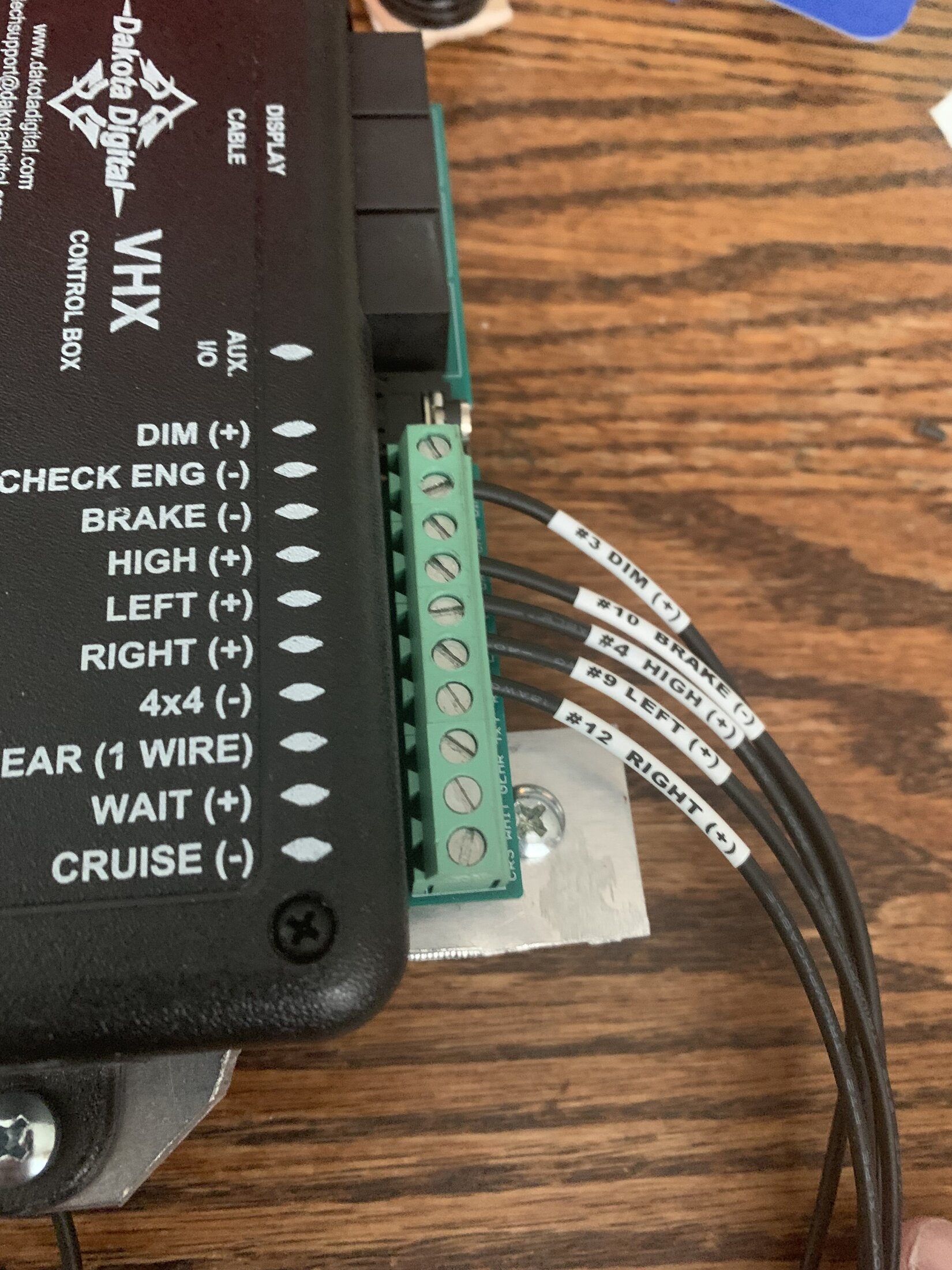

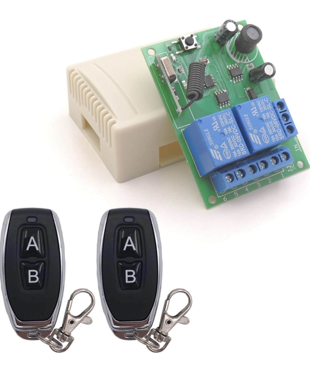

Dude, I’m switching over, arrives tomorrow, replacing switches with wireless key fob setup for around $20.00 tell me what you think?
update:
1: fob for switches worked great

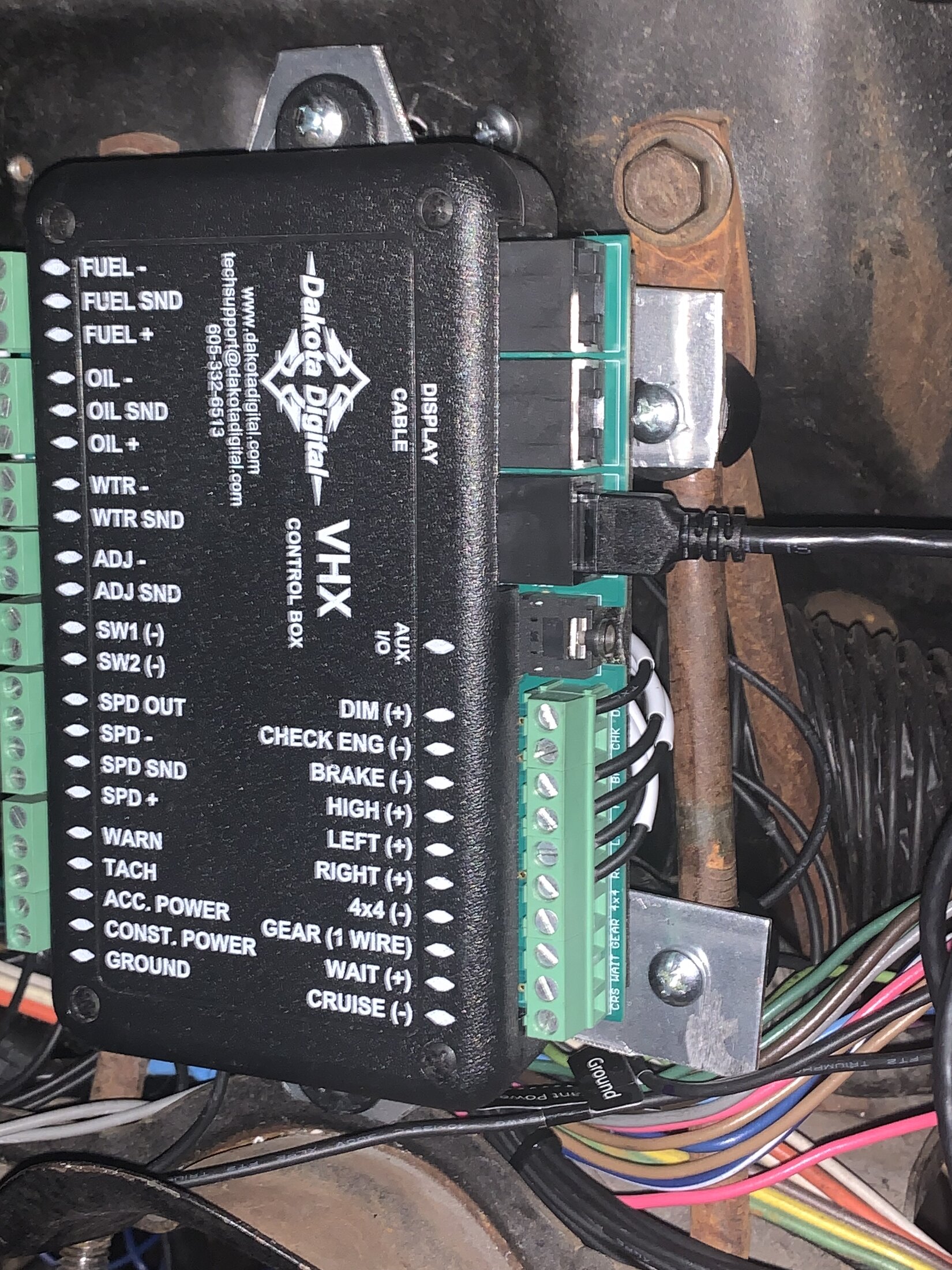

2: I have vintage air so the kick panel vents are sealed off… sooooooo, I used the lever hole that used to open/close the vent and installed a 10k POT for the dimmer on the Dakota digital.
