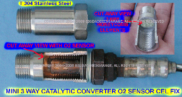

On a side note, anyone know if there are mini cats available for our bolt on style O2 sensors?
