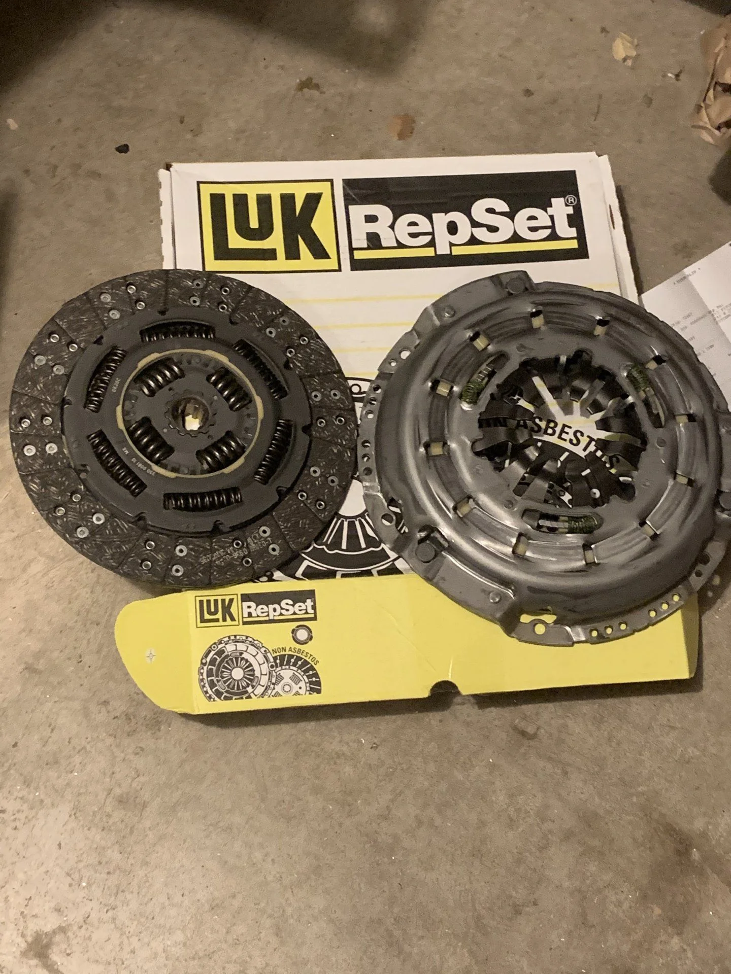

Clutch came in, with the flywheel coming along shortly.
Unfortunately, this clutch kit did not include a throw out bearing. There happened to be one still stuck to the fork in the bellhousing that was used in its prior life. Not sure if it was supplied by Advanced Adapters or what, but the issue I’m seeing is that it’s not quite right.
The O.D. of the section of bearing retainer that the throw out bearing slides on is, to my best measuring capability, 1.365”.
The I.D. of the throw out bearing previously used is 1.424”, and fits pretty sloppy on the shaft(🤭).
Researching some TO’s on eBay and AA, net some with an ID of 1.375” - 1.38”, a difference of 0.010” - 0.015”. Does that sound tight or more better? I’ve never really measured the difference before when installing TO bearings, just threw on what was supplied and went.
Luk - good stuff!!!
