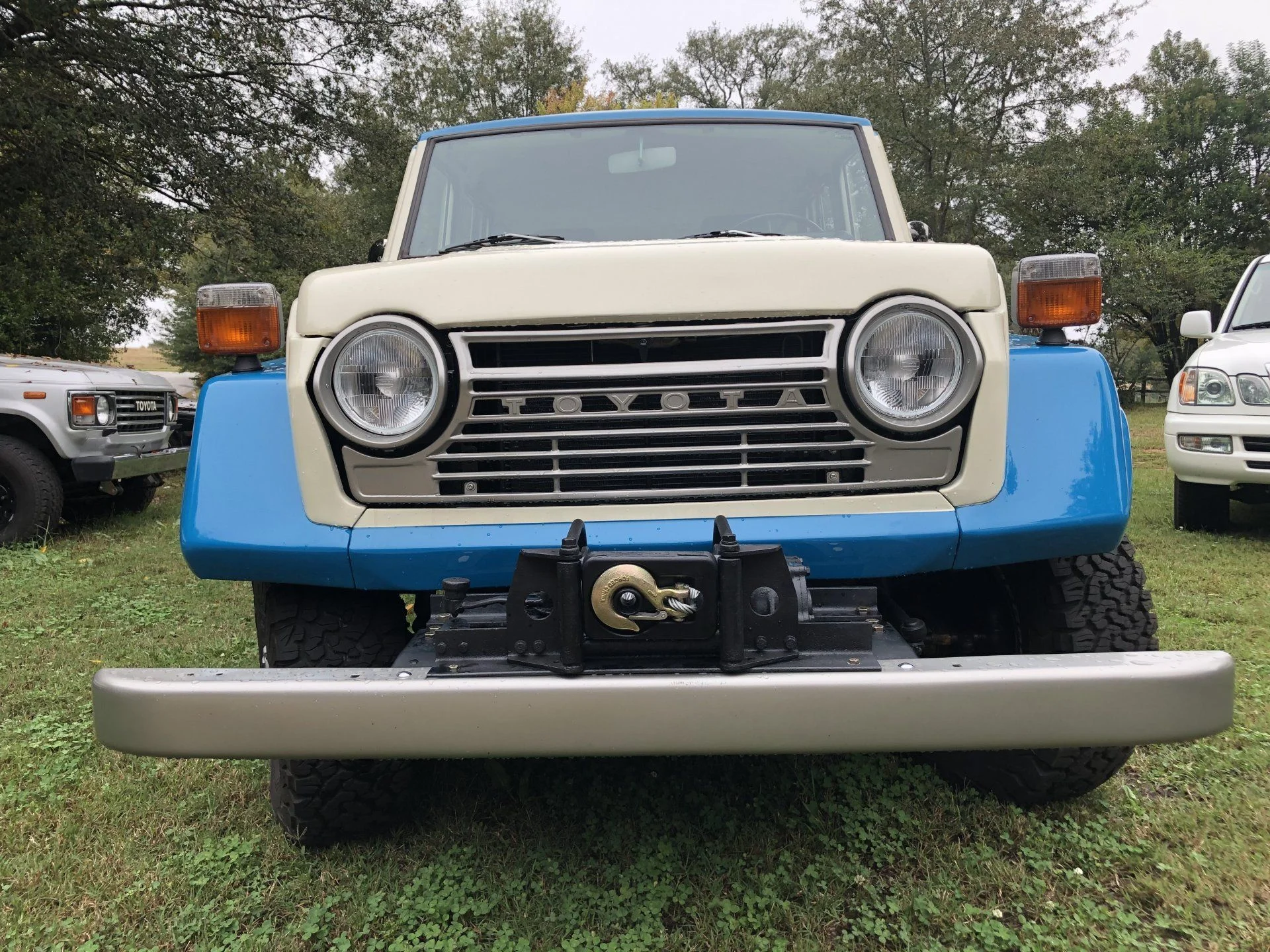

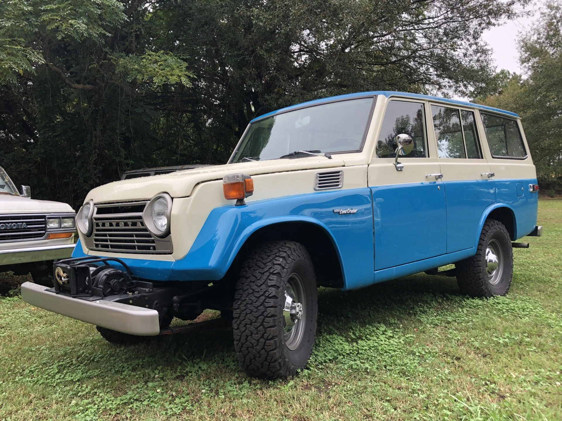

Stan at Hardline Fabrication Services (HFS) in Chesnee, SC just recently pulled the good running 2F out of this absolutely stunning '79 pig for an LS swap. Stan does LS swaps into cruisers for a living, and even he flinched a little when the owner showed up with this fine pig wanting to swap it. The owner insisted,"LS power or I'm selling it." LS it is. I would have kept it Toyota, but in all honesty, a well done LS swap doesn't seem to hurt the resale these days. Swapped pigs and 60 series trucks are fetching big numbers on BaT...and they have got to be so much fun to drive as well.
View attachment 2537255View attachment 2537256
Stan could have called his bluff and offered to buy it!
Start over w/ a non-'79 for LS swap...
