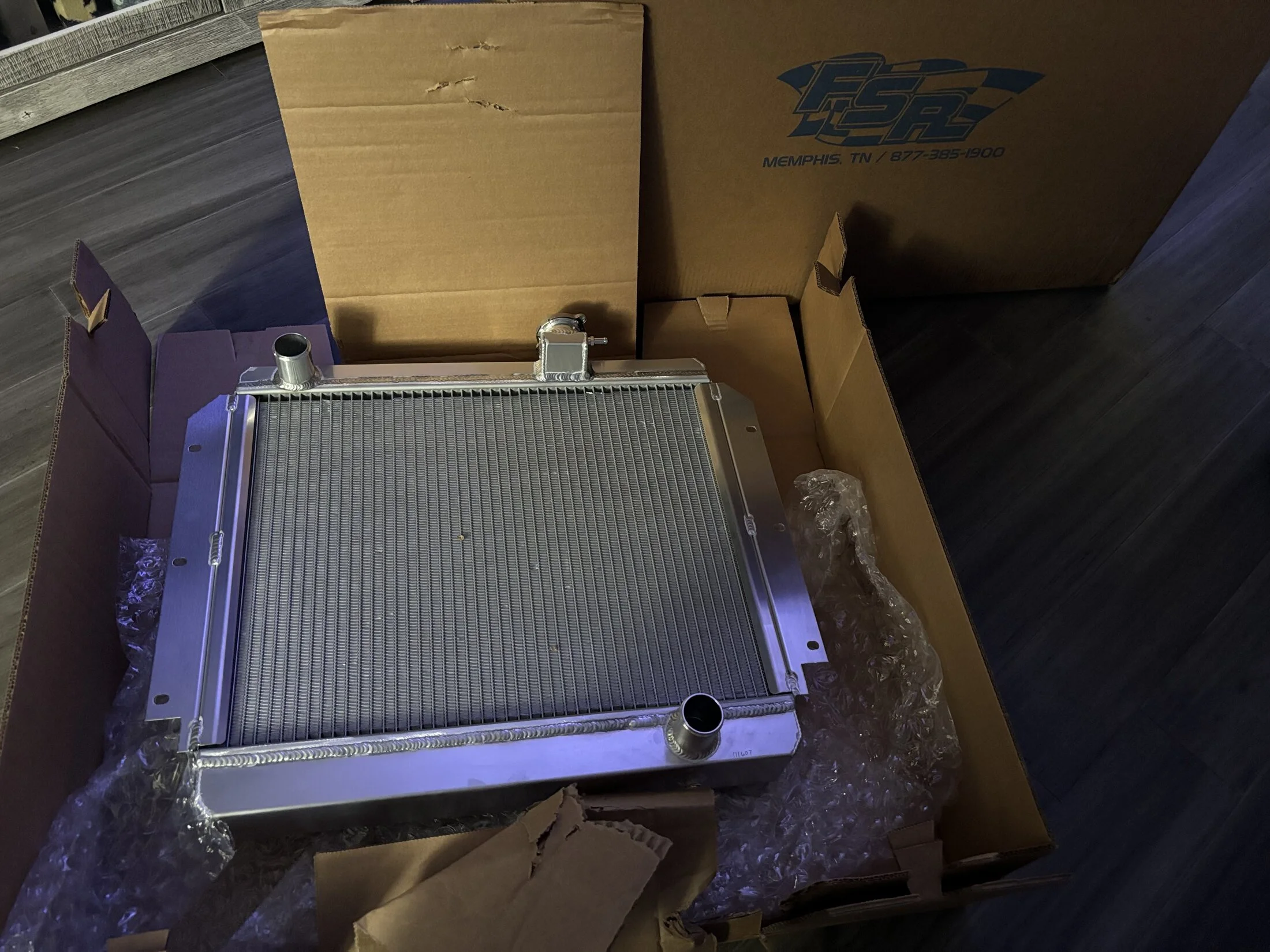

Ordered a radiator from Mosley, but I must have screwed up the order (despite making a note in the comment section that this would be for an LS conversion) and ended up getting what appears to be a stock replacement.
No steam port, and inlet/outlet being of factory size and placement. Will probably get ahold of them Monday to try to arrange an exchange, unless… someone is in need?

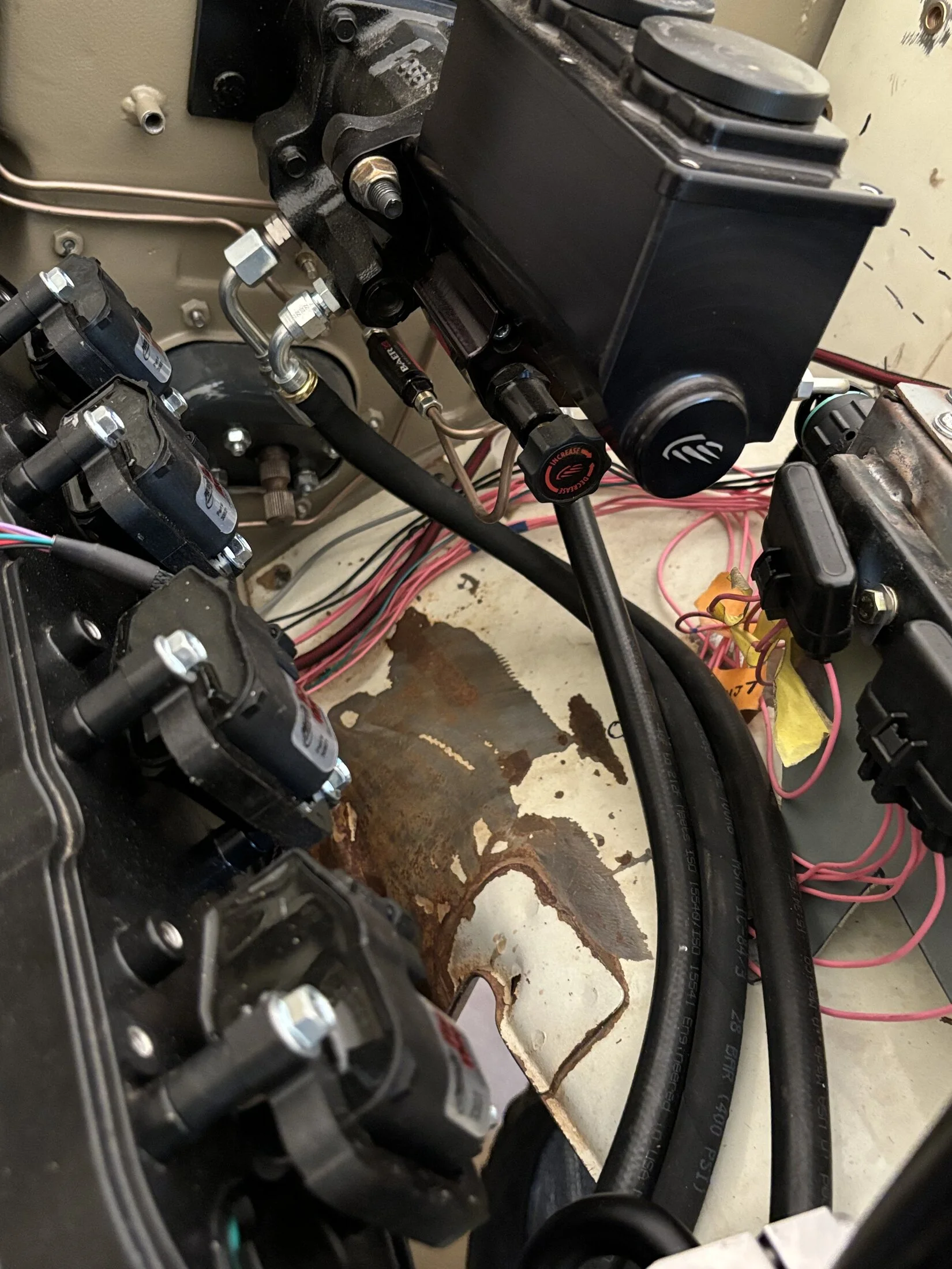

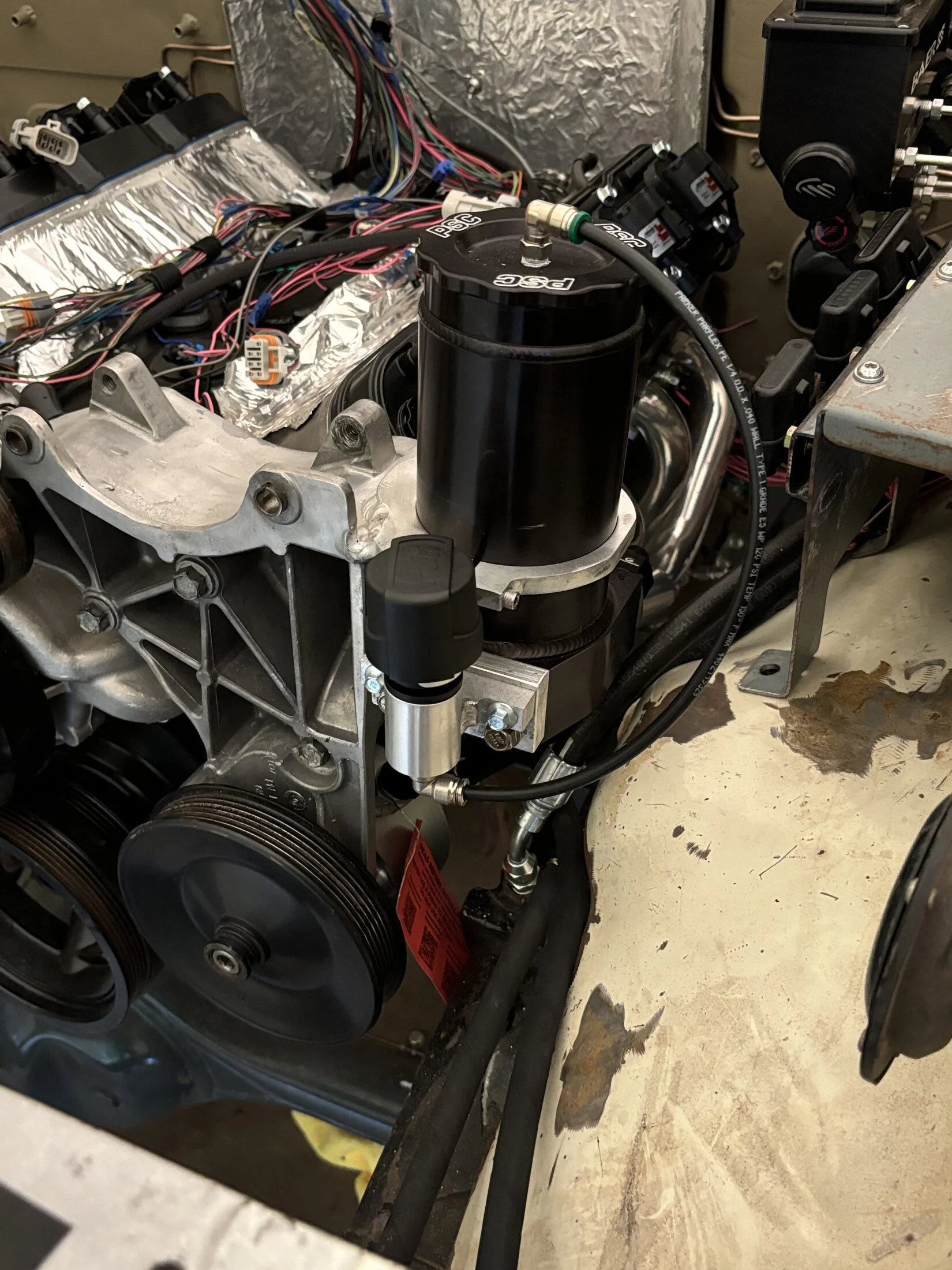

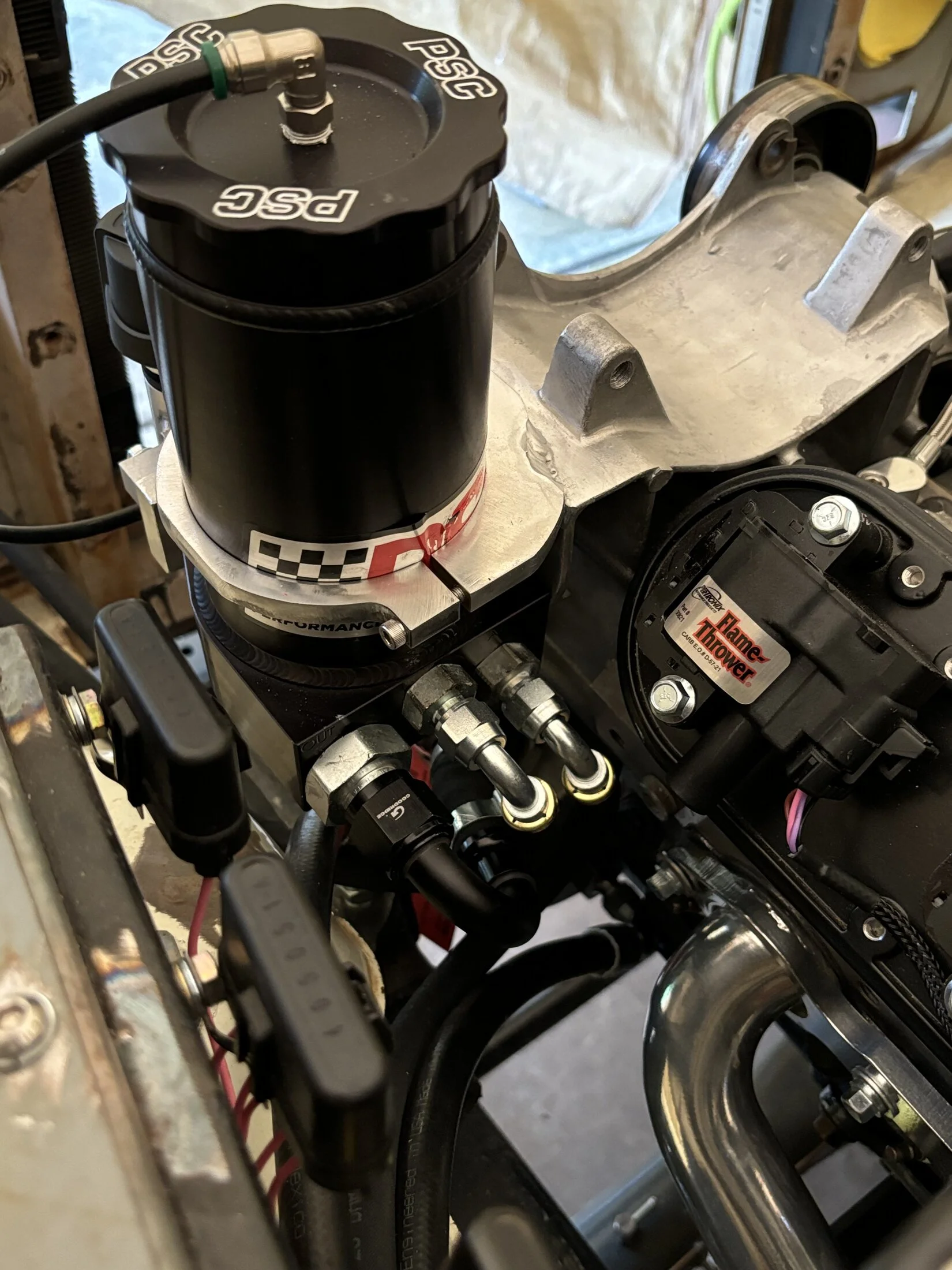

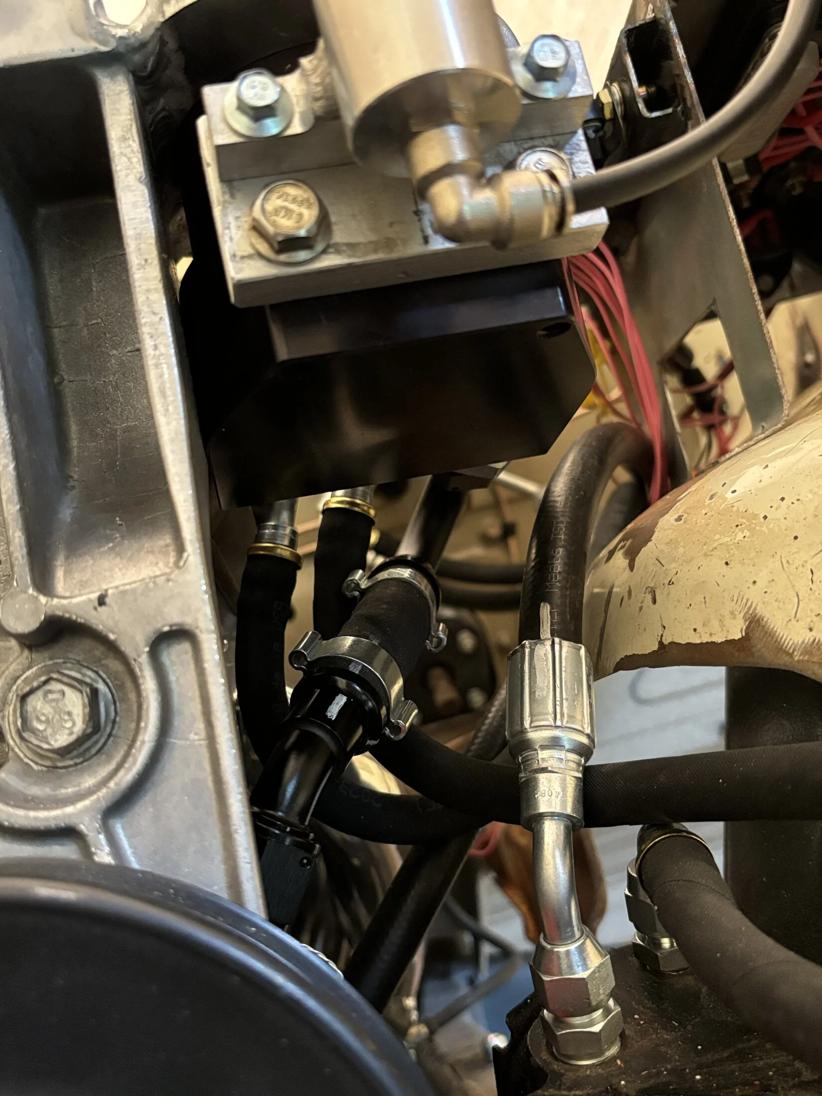

Power steering and hydroboost plumbing.

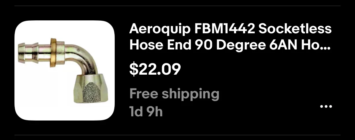

Emulated Scrappy’s reservoir position, but wanted to just try welding the bracket to the alt/ps pump mount. The hard part was making the AN10 hose from the res to the pump, which in this incarnation is a 150° barbed m on the res, and a 45° barb on the pump.
The pressure lines are 6M2T crimped fitting hoses. The supply to the pump and all the return lines are textile reinforced high temp hose, with all but one (on the cooler) terminating on a 3/8” JIC to 3/8” barb 90° fitting.

Sum bitch, that's a lot of plumbing...
Yeah… no kidding. It’s a challenge to make that much plumbing look tidy and clean. Going to add some clamp points on the inner fenders soon to aid with keeping the hoses in place and free of chafing.
