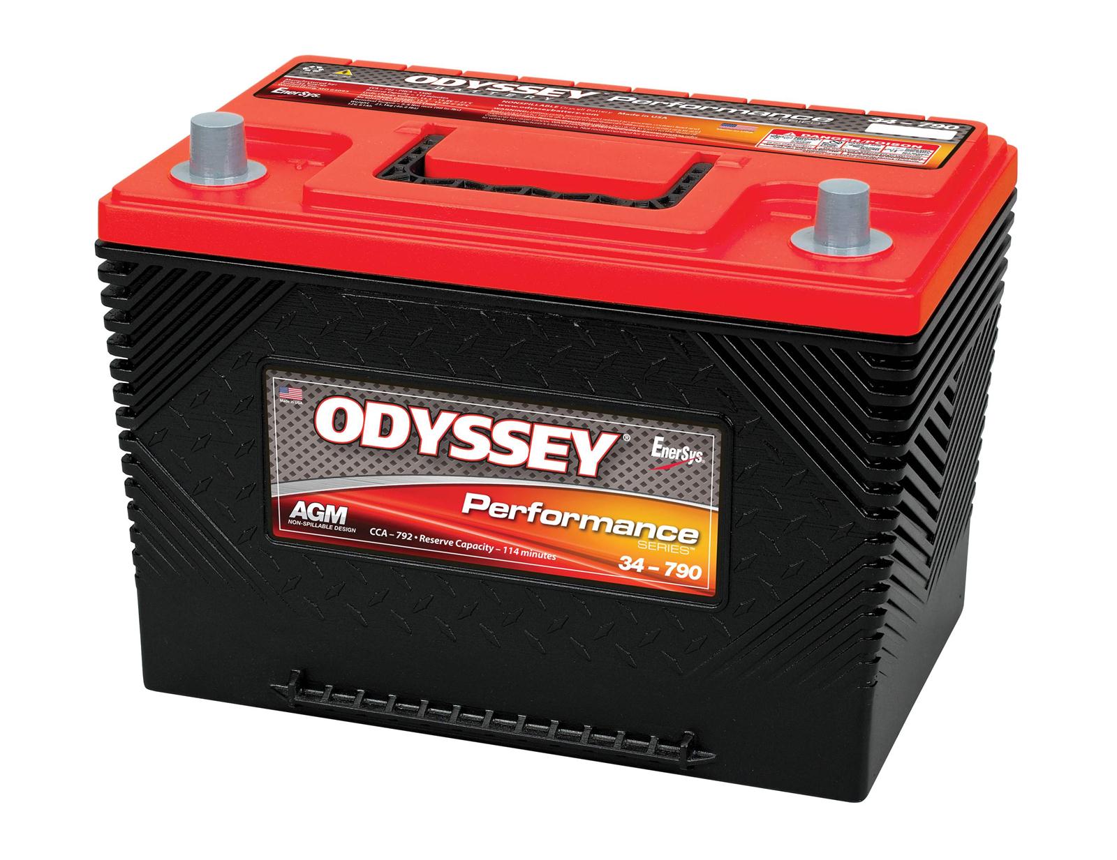

We used the Highway 22 stuff with no complaints. Put the winch and air compressor on the house battery and don't forget about some type of security ( alarm, tracker, cut off switch, etc. ).
I just bought two of those Odyssey batteries for my 5500 Dodge last week. OUCH!

What method of isolating and charging are you using?
I have a blue sea(?) isolator. As far as the charging goes I let the engine take care of it. Maybe this is my mistake, this is my first dual setup. I’ll do some research on charging the odyssey…
