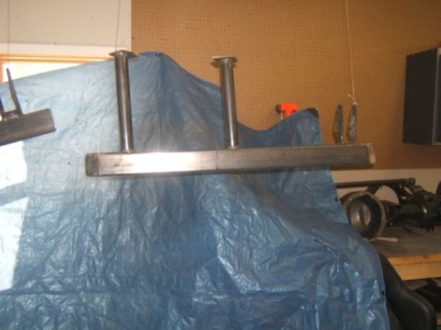

Well had some time to spend in the shop so I built some sliders. I took off the old steps and found a bunch of holes and then came the diamond plate. Its alway a guess whats behind there. Well turned out a hole lotta rust and on the other side there was nothing. So after learning how to do body work which sucks:bang:. I finally got to the sliders nothing fancy but should work good. Then got some hurculiner and painted the bottom half.

I was able to use the stock mount in the front just had to modify it abit.:cheers:
nice sliders, look similar to the pair i have
