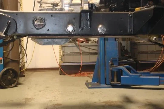

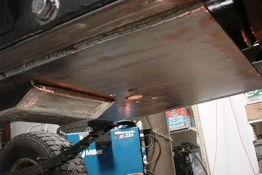

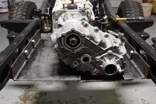

Here are some pics of my skid plate. It's not finished, but...
I used 3/4 bolts and sleeved the frame.
1/4 angle for the bottom and inside of the framerails. (sits on the rivets on the bottom of the frame).
The main flat plate is 1/4, and the part that hangs down is 3/8.

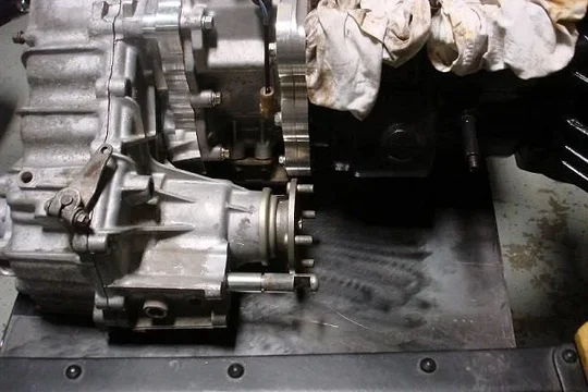

Some more....
The idea here is to have a type of support attached to the frame, something like a driveshaft support bearing, with a short straight shaft coming from the front output to the support. Then the normal driveshaft from there down to the 3rd. I'm trying to keep the front and rear shafts the same length (only have to carry 1 spare).

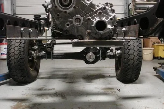

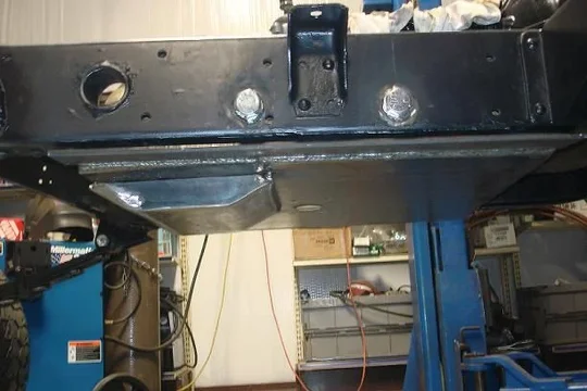

Man that thing is nice. My case sits down farther than that. I belive it sits about 3" below the frame. I spent quite awhile in the shop last night and think I have one figured out. It will not be a full skid plate just a mount for the case. I took Chicago's advise and did'nt hang it from the bottom of the frame which was a good idea. I had to 45 up the ends and attached to a piece of angle. The ps side suched bad they just is not room. Here is a pic of it so far needs cleaned up and the mount will be bolted through the bottom its just tached for position.
NNNNNIIIIZZZE!:grinpimp:
I think youll be glad that youre keeping the frame rail clear as possible. In the past I had tried to get away with NOT taking that advice and folks here set me straight to do it better.
That is why its nice to do a build thread...mudders will keep you honest and spend LOTS of your money for you.;p
Thanks guys it should work out okay I think. A build thread is nice you get to see various ideas and what to do or not to do. I have no cruiser guys around here so this is the place I learn everthing from. Chicago I have read your thread a ton of times. You can find most everthing in there. It really is alot of fun spending other peoples money.
