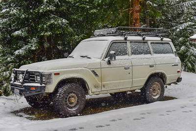

I started this way:
Then went and did this to it:
Chopped the rear off and built the cage in front.
