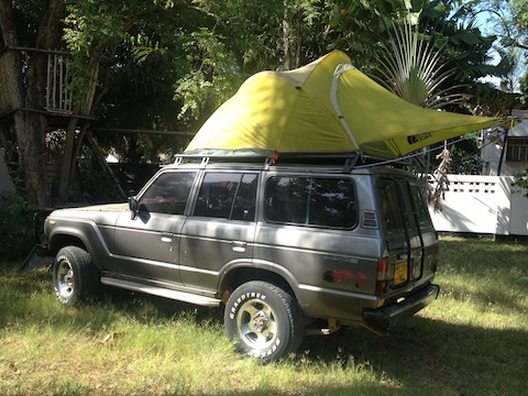

Here's my flat top rack, which is a custom build. It's great for hauling gear ( surfboards, bikes, furniture, friends) and also accommodates my 2-person ground tent when I want. Best of both worlds really, without the bulk and weight of a RTT up there.
Side view without the tent.
With the tent on top.

What is the dimension of that roof rack and what brand and model number is that tent?
I don't have a measurement for you but my rack is roughly 1" above the roof. The production version will be about .75" taller to clear the roof ribs that are part of the factory roof rack.
The rear cross bar can be vertical like I have it or laid flat for more clearance like the rest of the crossbars.
as for the design of the wind deflector, I don't have an answer for you but just speculate that it makes it easier to produce and not have any issues with it contacting the roof.

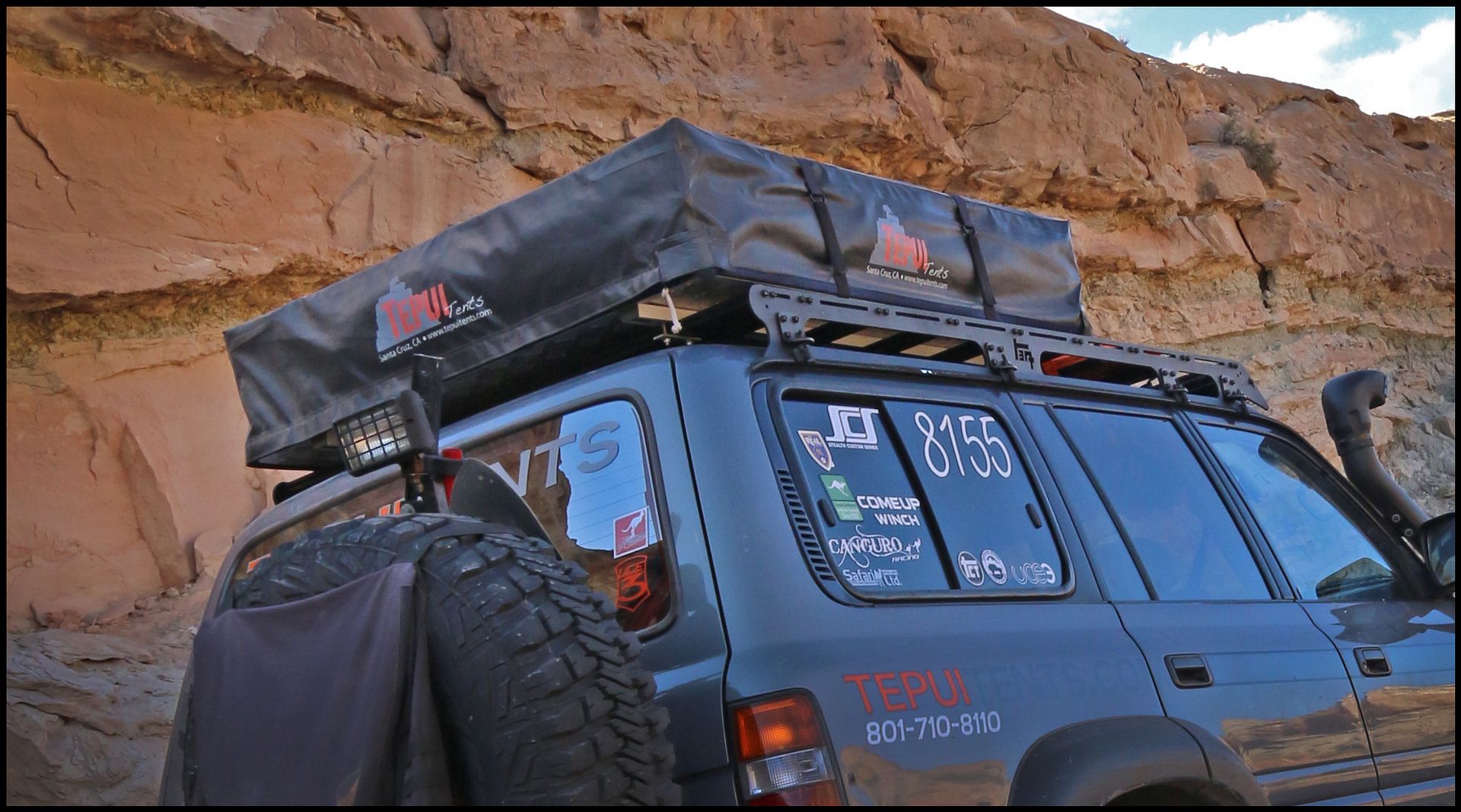

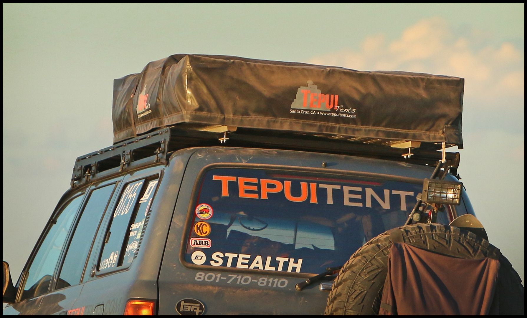

I'm looking at a Tepui RTT to mount to my Prinsu rack. Could you show more pictures of how you mounted the RTT to the Prinsu rack? I've mounted a RTT tent on a Frontrunner rack and we used the two bolts and crossbar clamping method but I thought I may be able to make a U-Bracket for the RTT that would fit over a Prinsu load bar and I could insert screws from the sides through the U-Bracket into nutserts in the Prinsu crossbar to secure the RTT. Sounds like it would work but I've not seen how they are typically mounted.
Are you going to order your Tepui tent from me? :) You should.
Here's the best photos I have on hand that show how the tent is attached. It uses the fairly standard rails/slides that many of the tents use currently. Each corner has a pair of bolts that slide into the tracks and a stainless flatbar underneath to clamp it down.
Hey @Rudster sorry for the months delay. We had another baby - I got distracted.
The platform is 200cm long by whatever the gutter-to-gutter width is on a 60-series LC. When I bought the 80, my fabricator friend just welded different brackets on the bottom to fit the new truck.

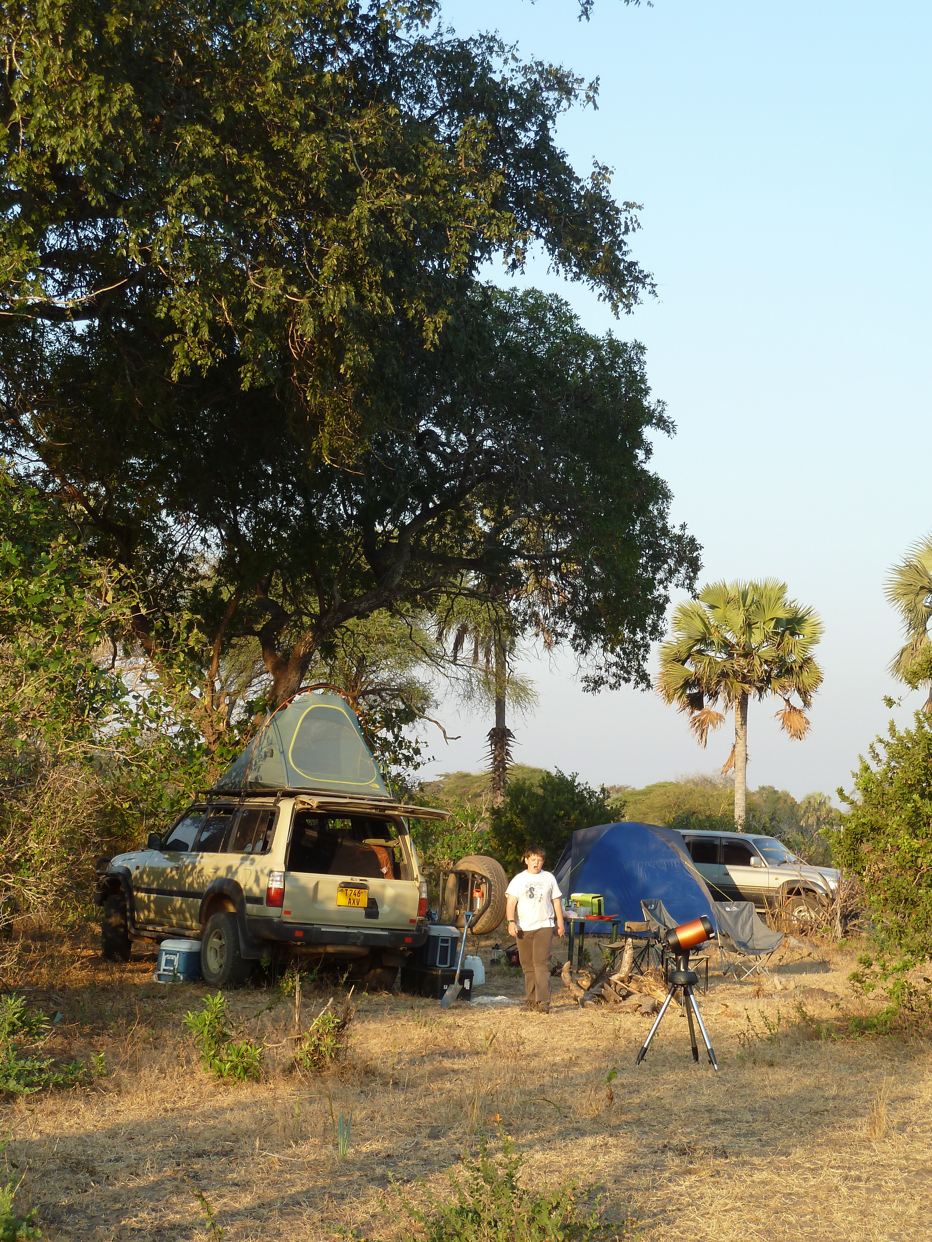

The tent is s North Face 2-person tent. I bought it in Birmingham, England, about 7 years ago, so I doubt they still make it. Two buddies have had the same platform made for their 80's, and they have Kelty tents from the US.
Here's the 60 with the tent mounted:
Here it is on the 80:
