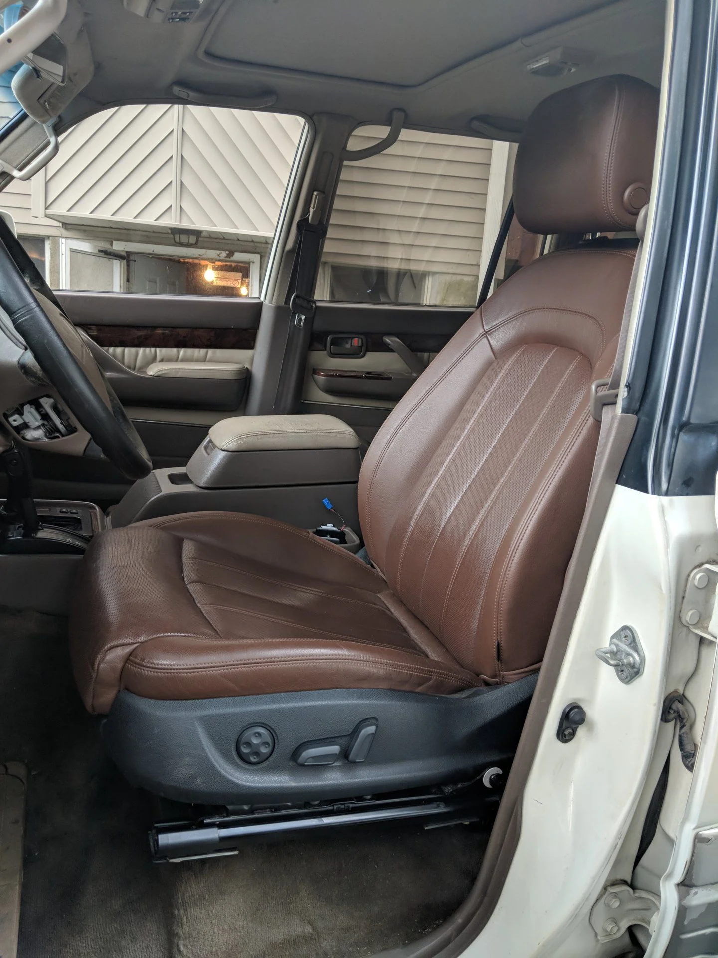

Evenin all,
Well I can’t stomach the thought of spending insane money to rebuild the OEM seats in my 91 FJ80. Sure it would be cool but this is not a restoration rig... So I grabbed up a pair of Audi A4 seats out of a sport model. Pretty much the same seats and an S4 only no fancy stitching and the pair only cost $250.00. Please follow along as I go through the process of getting these seats fitted into the FJ80.
As of today we have done one dry fit to see how much room we had and I was able to confirm they will work, just gonna take a little sawzall action and a little welding.
Steps I am taking consist of a lot of measuring establishing center line of each seat and the offset of the rails to make sure I am actually sitting center on the steering wheel.
Found that the “hump” that the OEM seats bolt to is gonna need a little trim at the center... oh well looks like I am going to be looking into makin a custom center console now too! I knew wood shop would pay off some day!!
I have seen a handful of guys/ gals do the WRX seats. Those look very nice but I am 6’ 2” somewhat muscular so those seats just don’t work for me. I test drove a couple of the WRX’s but I just couldn’t feel comfortable in the seats. I owned an Audi S4 a while back and loved the seats in that. So if your a bigger guy or gal maybe this thread can help....

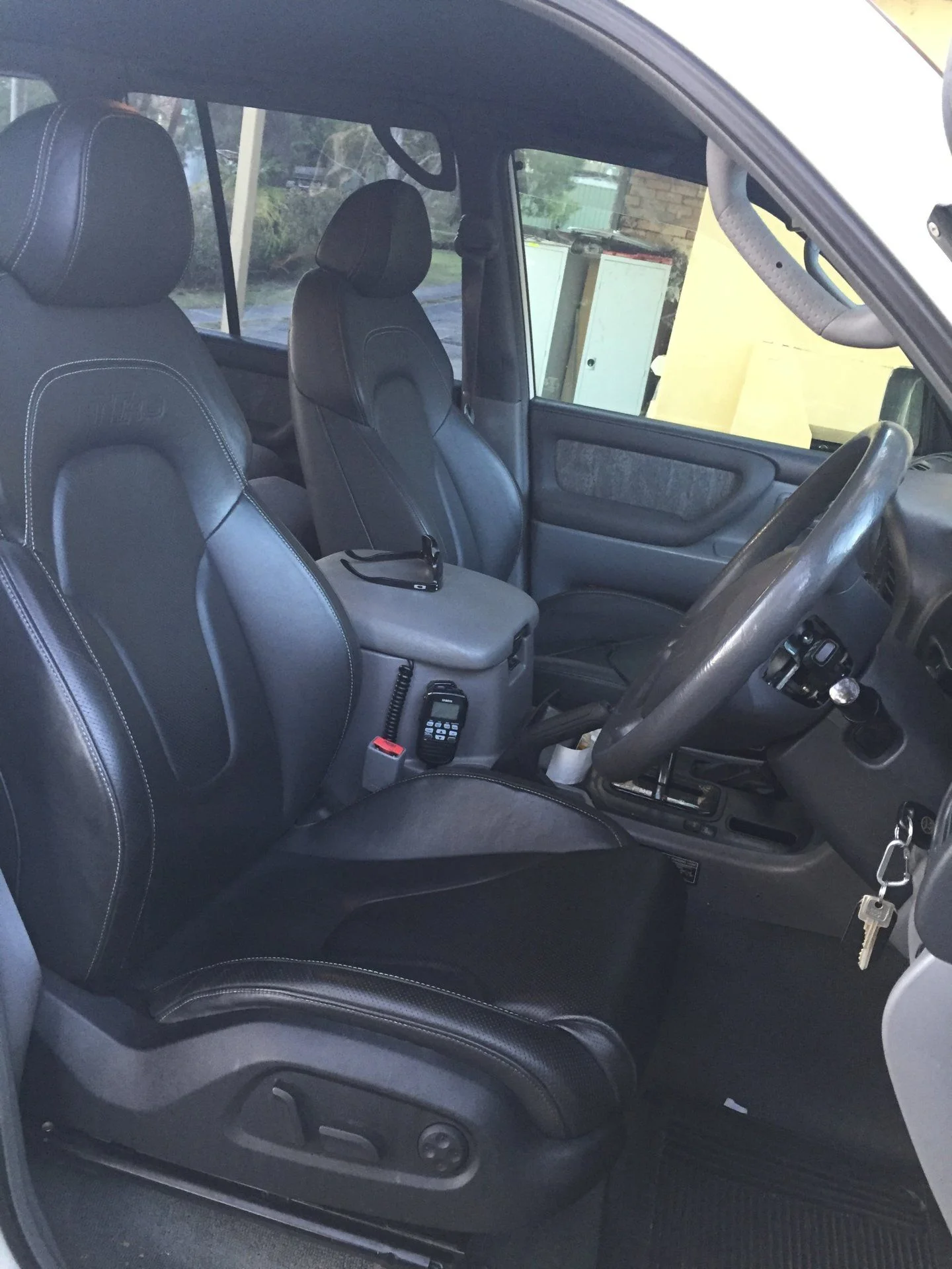

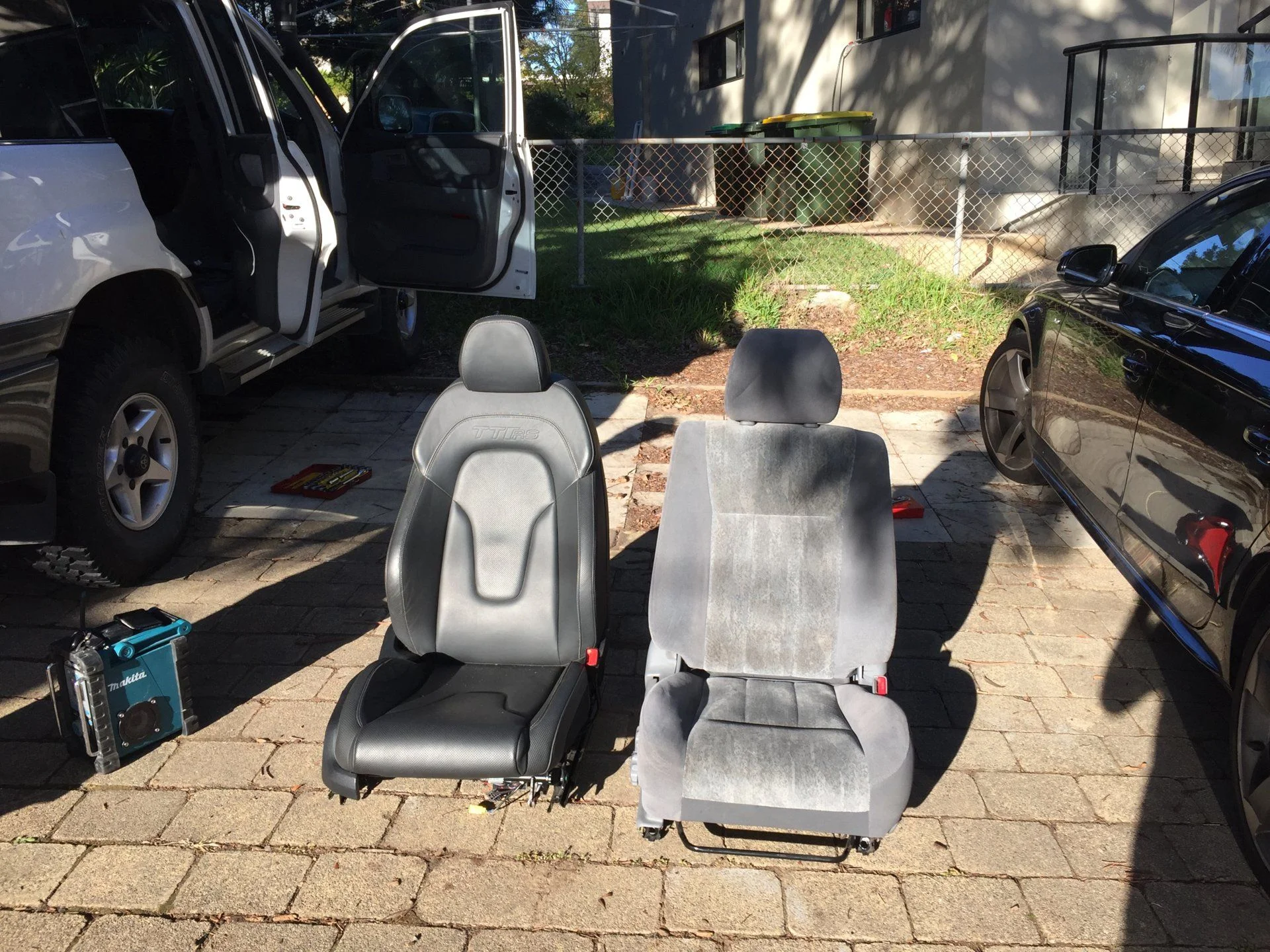

Here's my efforts of fitting TTRS seats into my LC105. I ended up making individual brackets for each corner, instead of building a frame. This seemed to work well and was very secure.
I didn't keep them in the car for very long because the switches for the electric motors had some corrosion and were temperamental.
Also I had a sore back at the time, and I think that RS seats were a little ambitious... haha

Dude, they look like they were made for the 105!
do you have any pics of what you did with the brackets?

@mudgudgeon ill have a hunt around for the photos or I’ll just go find them and take some photos.
The perforated leather on parts of the seats perfectly matched the handbrake, but that was about it. Width was pretty good. I had it slightly too close to the centre console and scored it a little.

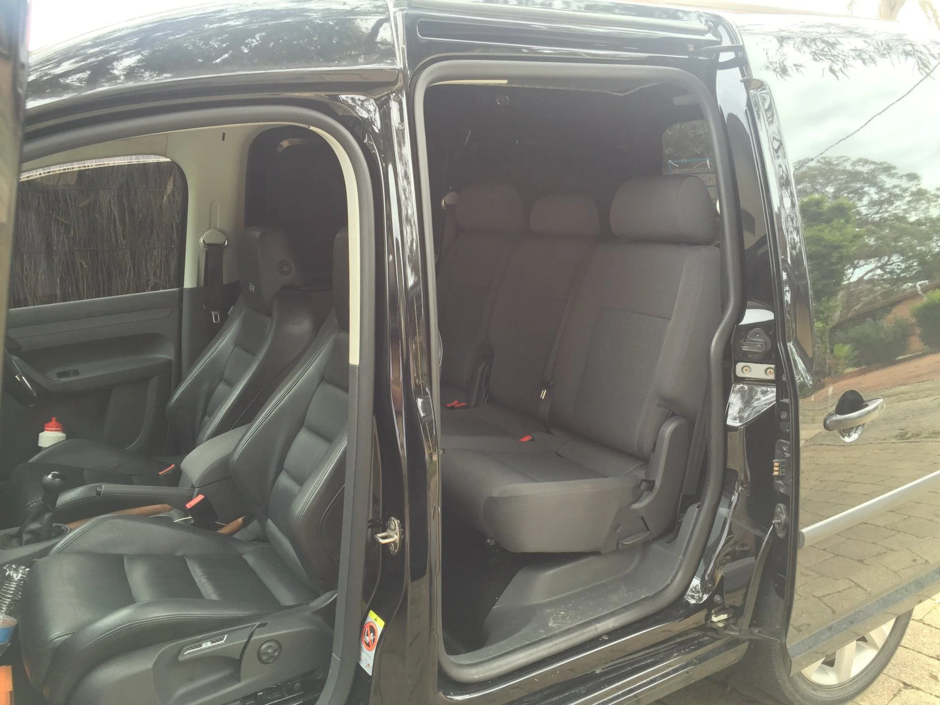

I put golf R seats into a be caddy van, and used the heaters in that tonnes.
Drove it to the snow and the switches failed and we spent 2 hours with full heat before I stopped the car and just pulled the fuses. Haha

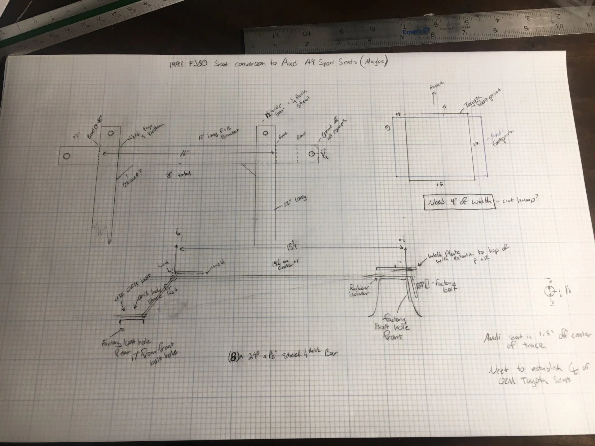

I also have a 2017 GTI MK7 That I love the seats in. However the wrecking yards wanted $1000 USD for them a piece! So $250 for the pair of full auto and heated Audi’s became the choice! So glad there is such chatter about this. I plan to attach my drawings and final measurements to this post when it’s all said and done with details on centering the seats and everything...

I think the years are optional. No seats seem to be an exact drop in. Most sport seats appear to be wider than the OEM Toyota seats. I am considering sacrificing my center consol if it becomes an issue and fabricating one from wood and steel.

excellent blueprint seats look badass, BUT Im not sure how to say this...but your steering wheel is on wrong side.
LMAO! I actually had the chance to get a Diesel RHD from Japan with 90k on the odometer... guy wanted $16k USD... I paid $8k for mine... figured I could live with the loss... Wish I could make my way to the land down under and get one... maybe the next family trip needs to be to Australia!
