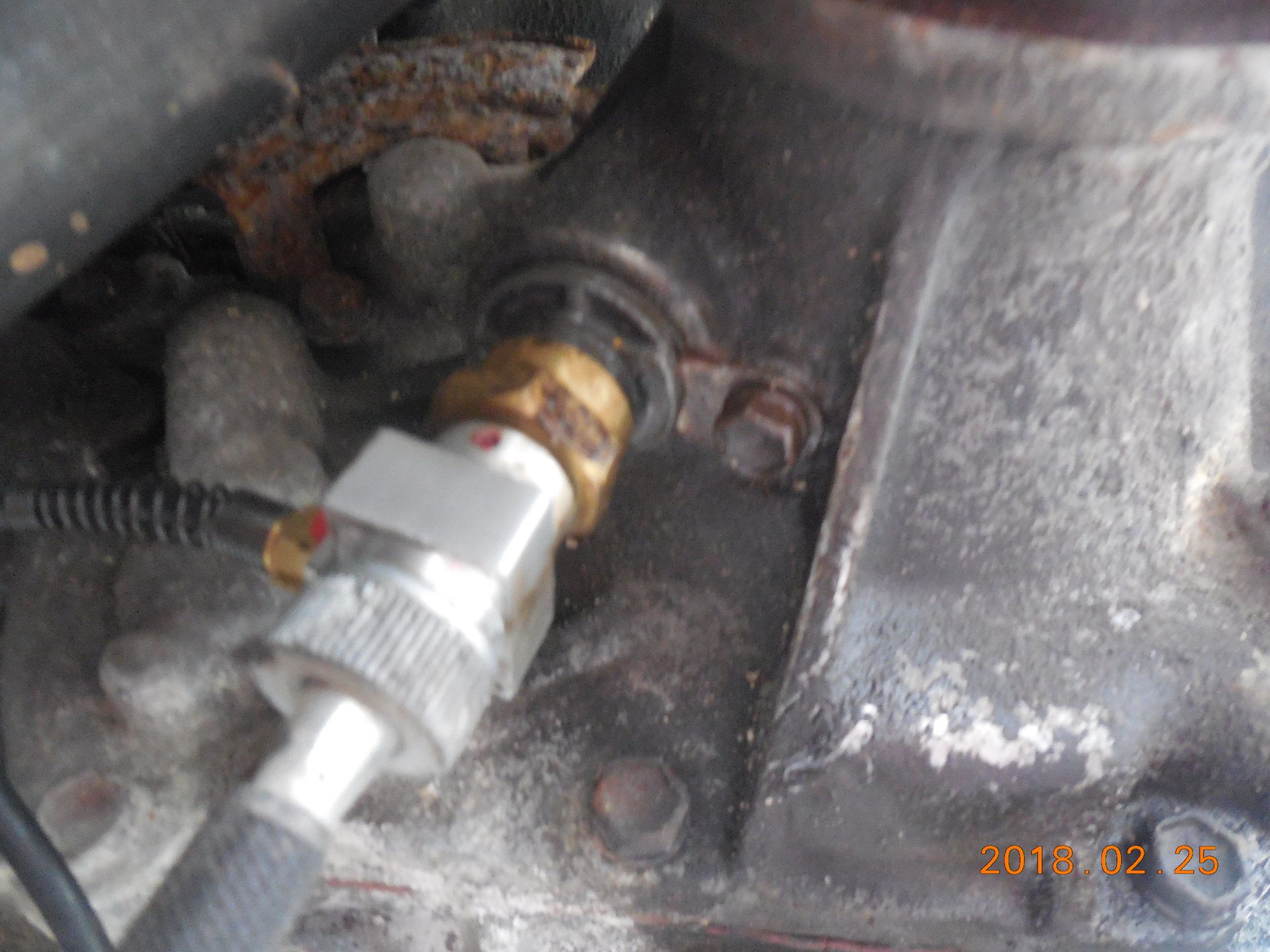

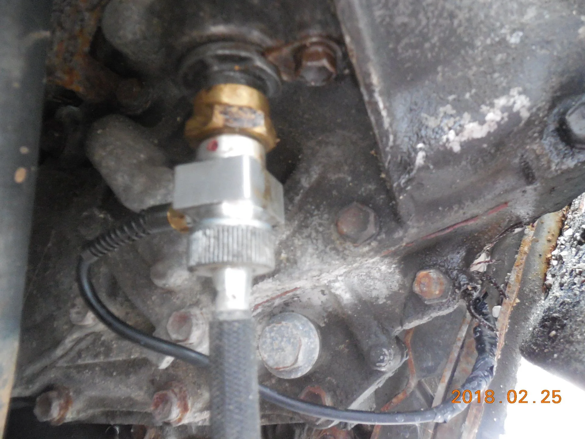

just a heads up. cruise speed sensor went out, like all the fj80's do, finally found a plug and play replacement. found a company in aussie land called New England Instrument co. they make speed sensors for fj80's srews right in in place of the old one. order the HALL EFFECT SENDER 12-24V 4 PULSE C6001. works great, easy install. little pricey $106 plus about $44 shipping. if you have some tax money left over well worth the cash.
heads up, take the whole assembly out, the nut that threads onto the speedo gear housing was frozen, put it in a vice gently and use a little heat to get it off or you'll pull the aluminum threads out. I live in the rust belt so everything is frozen and/or rusted:bang:

yes, it's an aussie company, those pictures are from my 91 fj80. my cruise works perfect!:steer:
