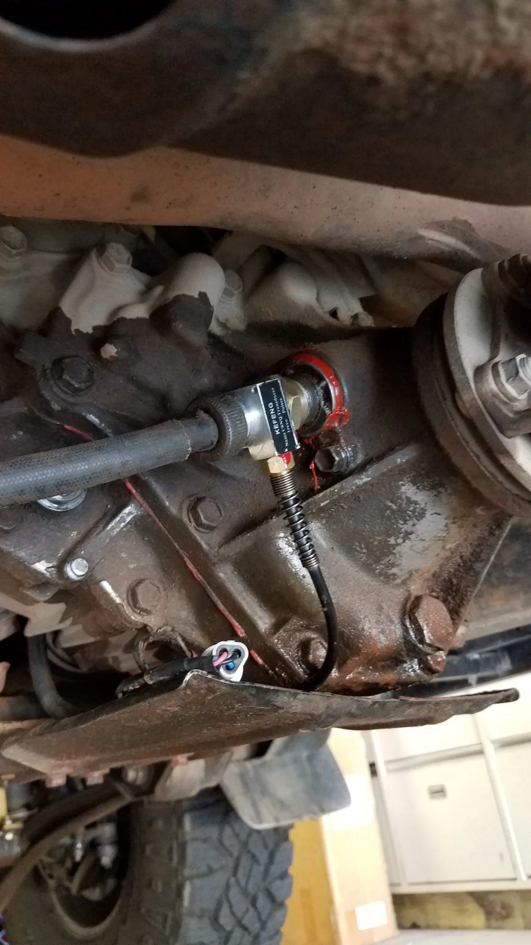

just a heads up. cruise speed sensor went out, like all the fj80's do, finally found a plug and play replacement. found a company in aussie land called New England Instrument co. they make speed sensors for fj80's srews right in in place of the old one. order the HALL EFFECT SENDER 12-24V 4 PULSE C6001. works great, easy install. little pricey $106 plus about $44 shipping. if you have some tax money left over well worth the cash.

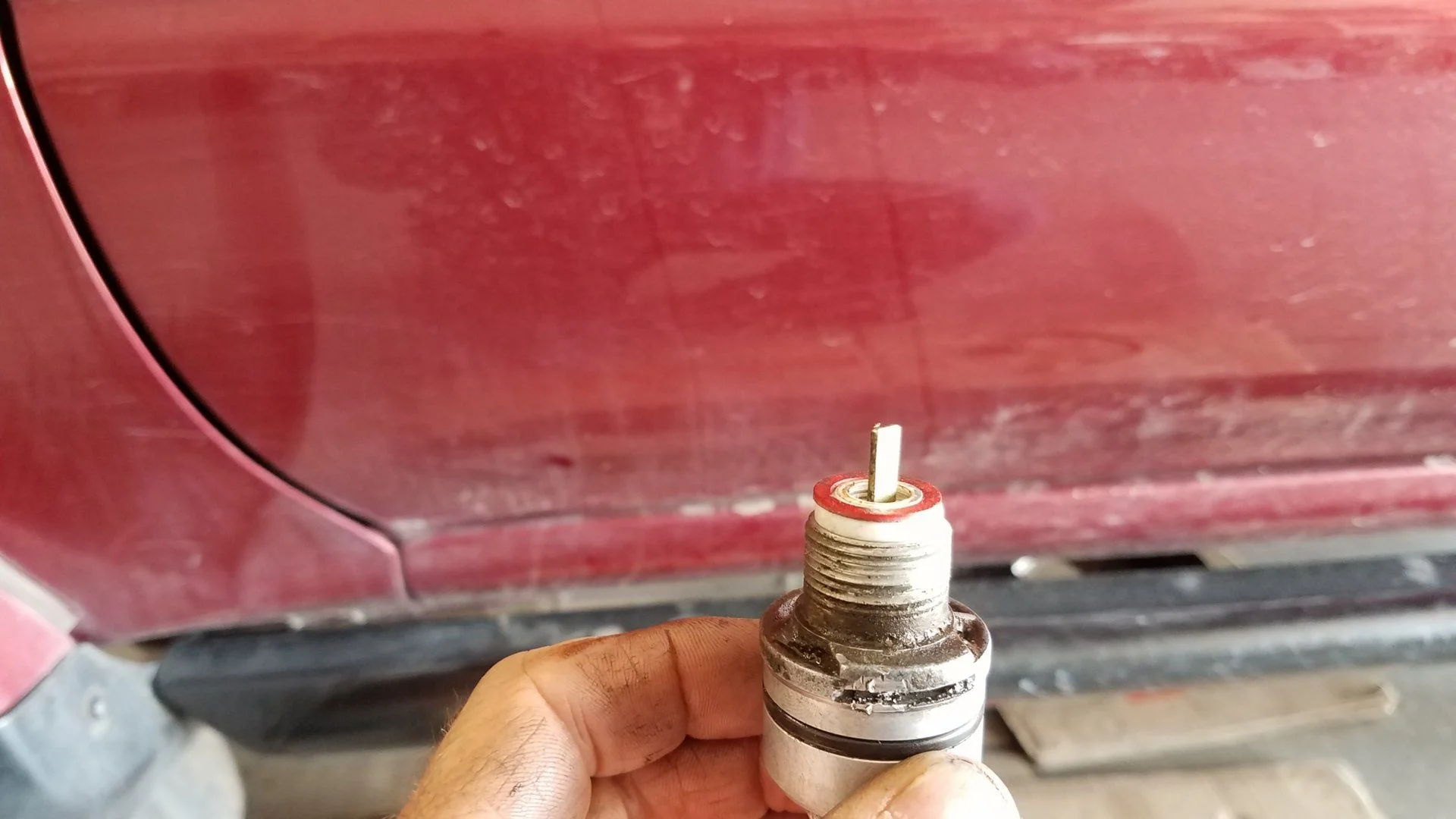

Hey 76lcmike thanks for your post. I received my sensor yesterday and i have a few questions about the connector. Take a look at these photos: did you splice the connectors together or did i recieve the wrong sensor because the new one is to short.
If you did splice them, I'm guessing the red and black wires match and the old yellow becomes the new blue wire. Is this correct?
Thanks again and get back to me and let me know what you did.
you are correct :beer::steer::cheers:to be honest I just cut the connector off and spliced;) and heat shrinked the wires to the old wire 3 wire pig tail off the old speed sensor wire harness
Mine arrived this week. Unfortunately I'm still waiting on my HDJ81. It was finally loaded onto a transport in Oregon yesterday so i should have it by the middle of next week
Life is good! New speed sensor installed and working!
Key bottom out keeping unit from turning, added about 3/16 of spacers and hand tighten, cruise control have been revived.

Were any of you able to reach the connector topside of the tranny and disconnect it? I can't get my fat fingers up to where I suppose it might be!
i did not have any issues, I think mine was hanging down already. gotta get some tiny hands on it or just splice it into the harness you can reach.....good luck!
Thanks so much for this. Ordered mine last Monday. It arrived from down under Saturday. Installed it today and once again I have cruise control! I am beyond stoked! Took a road trip over Thanksgiving without it and vowed never again.
