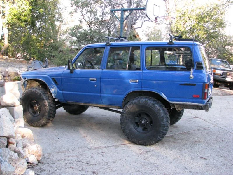

And for fun, my old 60 a few months before parting her out and a few years earlier right after the SOA. Again, I love the black steelies, but I like the alloy 80s wheels much better.
