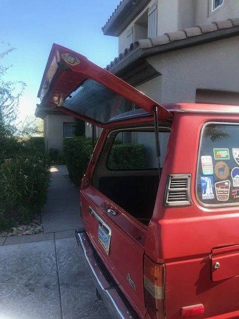

I know this has been addressed before. Just wanted to give feedback on how successful the new struts swap is.
Order from Amazon: $28.50

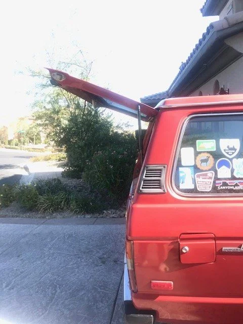

Perfect swap. Don't make the mistake of putting the new pieces together first just because it's exciting.
Luckily did this with only 1 strut.
Use 12mm open ended wrench to remove old struts.
Use 13mm to place new screws with ball joint.
Attach struts to ball joints. Wish I would have taken photos before to show the difference.
But now I don't have to bonk my head while trying to throw my mountain bike in the back.

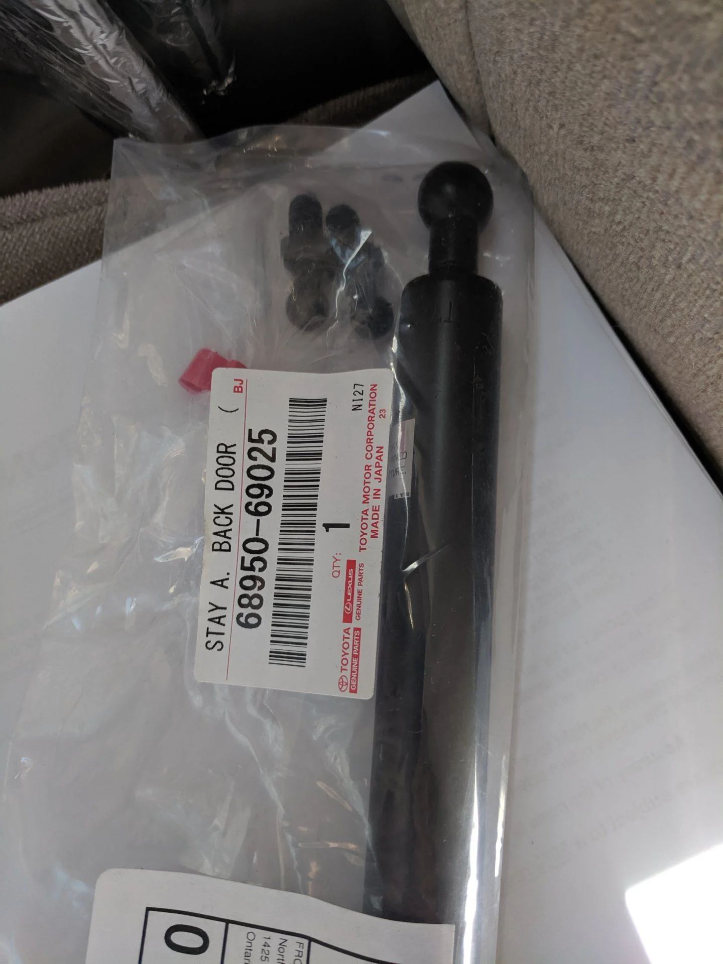

Yes, OEM will last much longer and they will fit better, they also include new ball stud screws for mounting.
In the long term, OEM factory Toyota parts cost less generally.
I just ordered a pair of the OE ones. Nationally there were 15 total on back order, I can wait. Just glad they are still available. Mine look to be originals.
