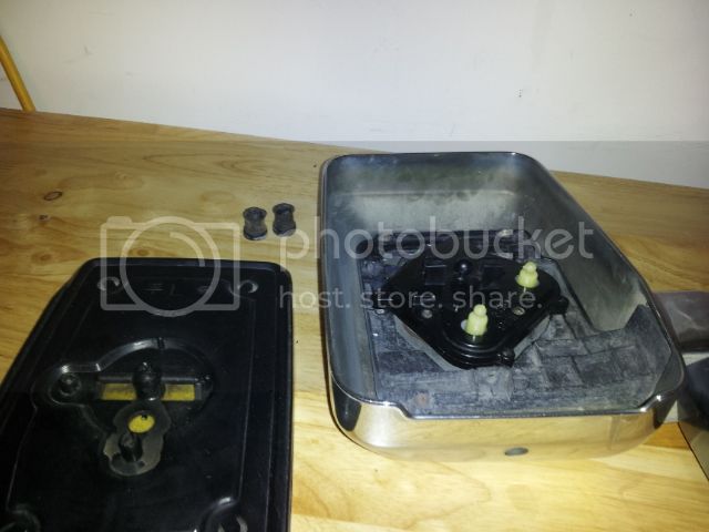

Yeah I am looking for a way to solidify my drivers side mirror. Passenger doesnt shake to badly, not near as bad as the original FJ60 mirror. Drivers side is a different story, but thinking that since I have the mirror "placement/angle" to my liking I may use some expanding foam (like you would put inside your walls of your house) in the bottom of the mirror housing to see if that will act as a vibration absorber and also solidify the mirror assembly.
To the initial post, I have not figured it out yet. Regarding the DS shake versus the PS shake - what I've witnessed is both of my mirrors have 'about' the same amount of slop when manually wiggling them but on the road the DS shakes quite a bit more and I think it can be attributed to the DS mirror housing. The DS mirror, when positioned, has the mirror sitting a bit outside of the housing (at the base) compared to the PS mirror so it is under constant assault from wind whereas the PS side mirror when positioned is almost completely seated within the housing. Also the DS housing has a recess cut into the bottom of it exposing the base of the mirror to more wind while the PS mirror housing does not have the recess at the base. I assume over time this causes the parts within the DS mirror to wear and attributes to the difference in slop between the mirrors.
‘Servicing’ the mirror just requires popping the mirror free from the base/housing – there are no screws, the mirror is fastened via various plastic ball/socket type connections. There are 2 balls connected to the motor (housed within rubber boots) that pop into the sockets on the mirror and there is a large centered ball mounted to the motor that snaps into the center of the mirror. The mirror has 2 plastic bars, 1 on either side of the centered ball socket, that snap into the base/motor. Major PITA to remove the mirror without breaking the various plastic fasteners… but it can be done.

So I did my ghetto fix using $4 expanding foam and it worked like a charm!!! Drove a few hundred miles this weekend and the mirror still vibrates but very little now, enough that you can actually see what a vehicle is.
Be careful when you are snapping that plastic face plate on and off. If that central ball that the faceplate grabs onto and pivots around breaks, the entire power mirror unit is pretty much trash. Very flimsy part for its degree of importance.
Following up on this - I bought 2 manual OEM Toyota mirrors from City Racer, and installed them on my FJ62. I took apart the old power and the new manual to see if the guts could be swapped, but part of the shake in the mirrors is due to wear in the motorized adjuster mechanism. After much hemming and hawing, I just installed the 2 new manual mirrors. The mirror - how steady, the chrome - how it glows. Bliss.
