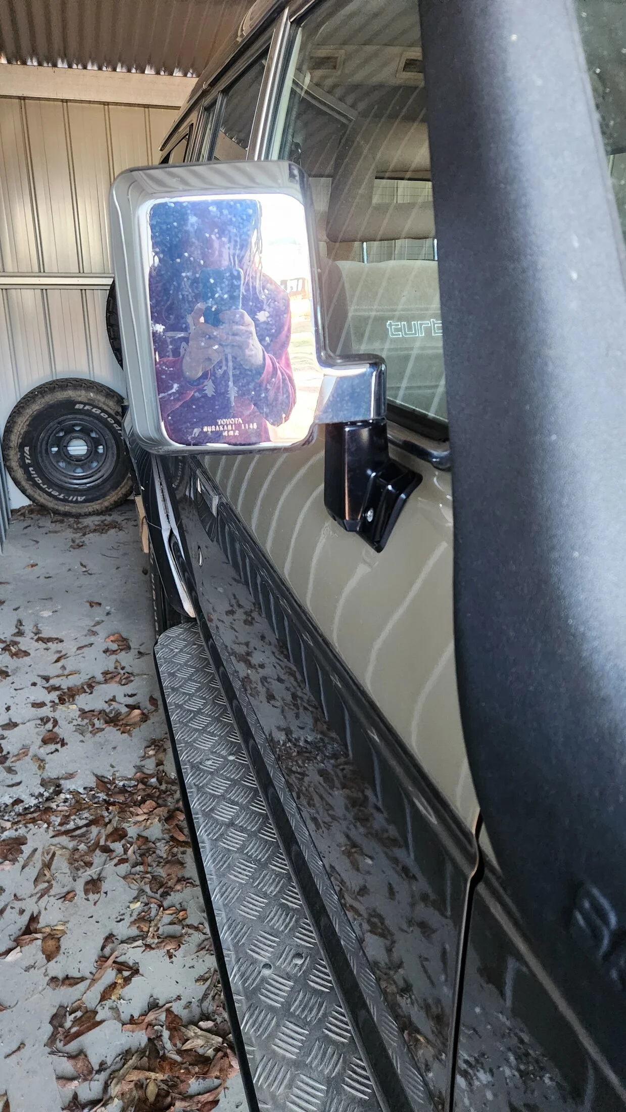

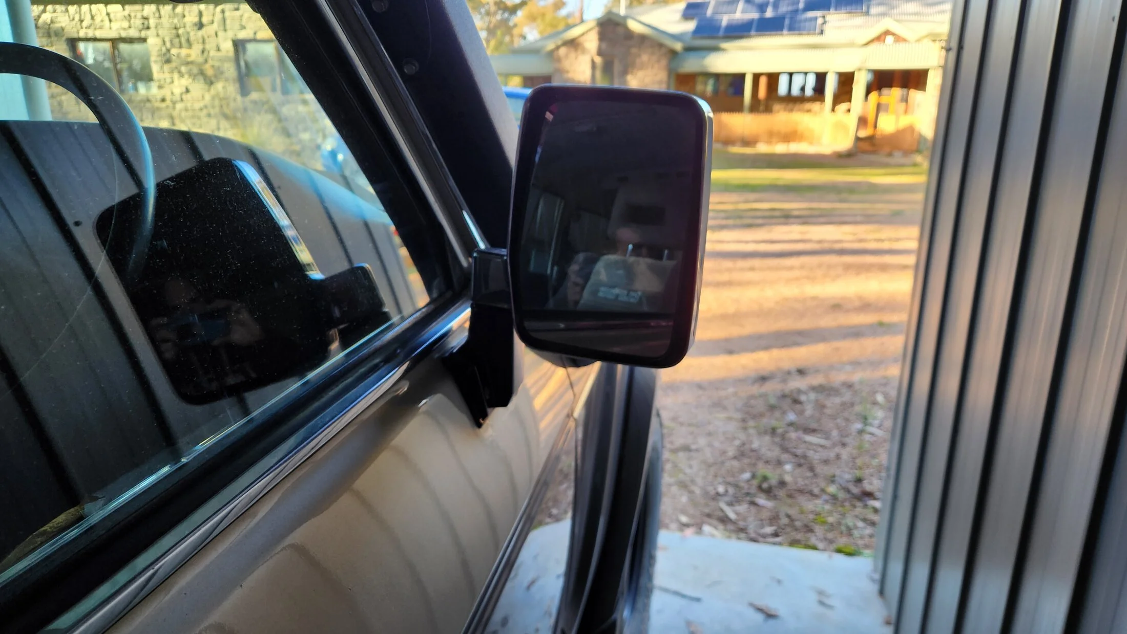

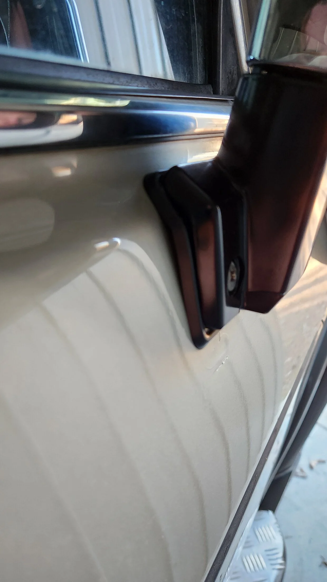

I put brand new 76 series genuine electric mirrors on my HJ61. FJ62 will be the same.
They cost an absoloute fortune, but I really wanted the electric ones.
They plug straight in a electric works amazing, super smooth.
The mounting isn't 100% perfect, but it's definately close enough. There is a small hump where it doesn't sit flush, but unless you were looking for it you would never notice.
The biggest disappointment is the angle of the driver's side isn't great. Probably because the seating position would be different between 60 and 70 series.
The mirrors fold in and hyper extend in case you bump them into something. I have to hyperextend the drivers side a tiny bit so I get the mirror angle correct.
It's pretty hard to explain!
The passenger side is perfect and I definately recommend it.
If I was clever I could 3d print or make some sort of wedge that would push the angle of the driver's side out a tiny bit. I might look into it one day, but hopefully someone smarter than me invents one.
So overall I'm sort of happy with it. Way better than the cheap aftermarket rattling junk I had. The mirrors would be perfect if the driver side angled out a tiny bit.
I'd definatley recommend an electric passenger mirror, and probably just get a 60 series manual driver's side.
