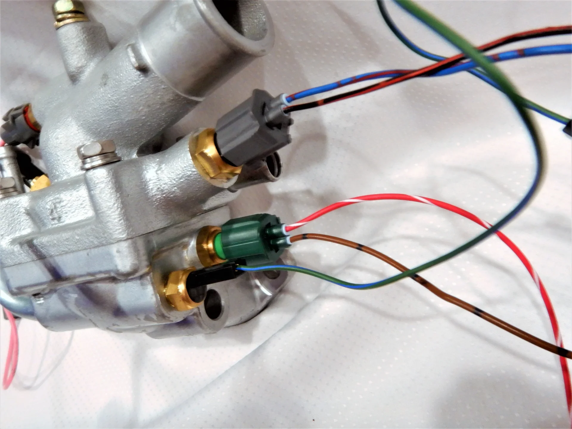

Awesome that makes my mind a lot more at ease. Im confident in replacing the sensor my main concern is converting the female plug from the old version to the new style, I haven't done a lot of electrical work before if there are any tips or things to look out for.

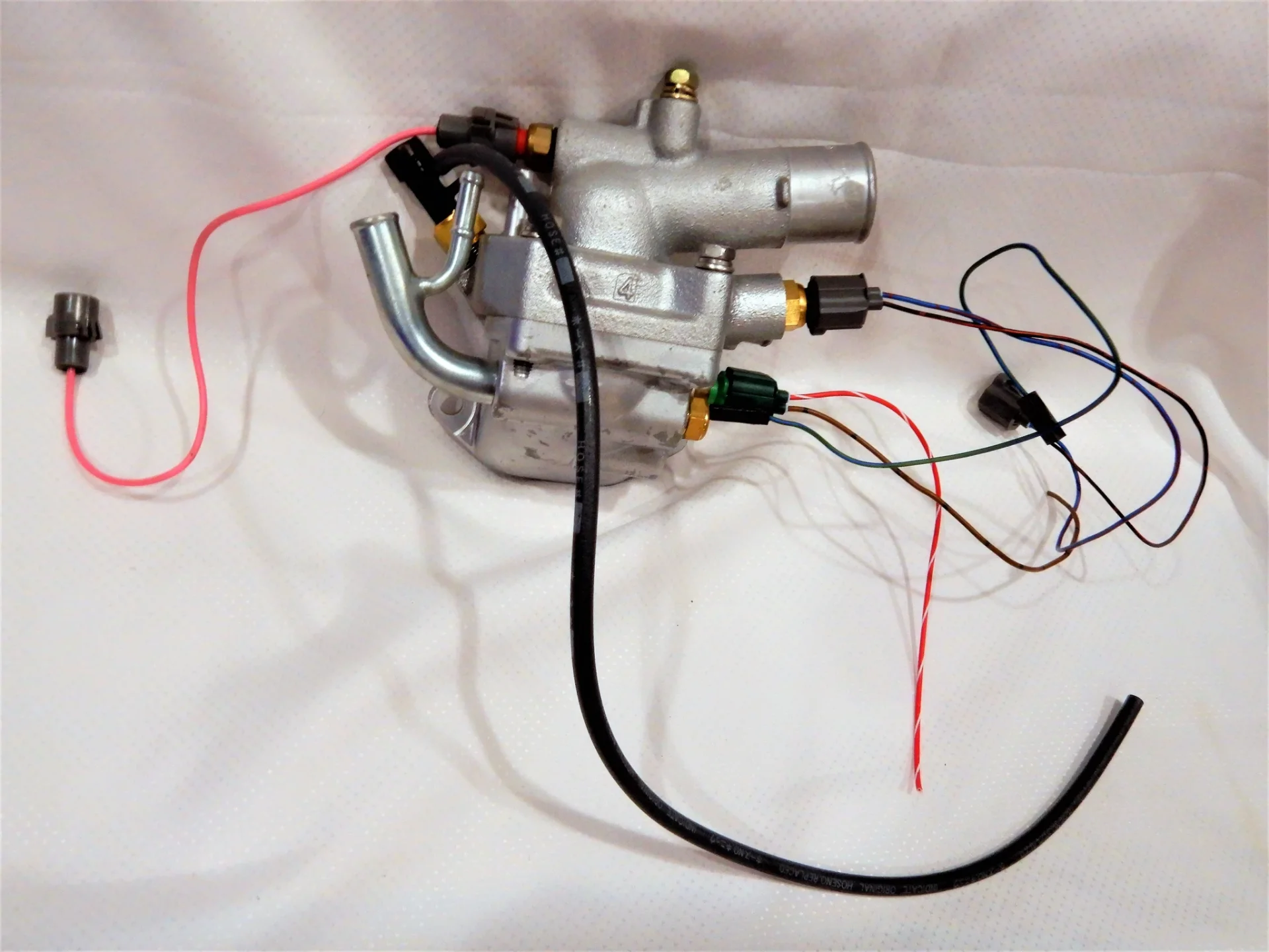

So splicing in the new sensor should be pretty straight forward. Basically cutting off the old sensor (keeping note what wires go where). Take pics before you do anything in case you forget :). With a FJ62, its worth investing in some decent electrical work tools, like good crimpers for the terminals and wire strippers/cutters. ;) Even having extra wire on hand for repairs, heat shrink tubing for sealing repairs. If you are unsure on any electrical work it may be worth looking at Youtube for some tutorial videos. Its not that bad, you will get it done.
I have been using these crimpers for the past 5 years and have been very happy with them. You can swap out the jaws if you use different terminals as well: Amazon product ASIN B0050KDKUC

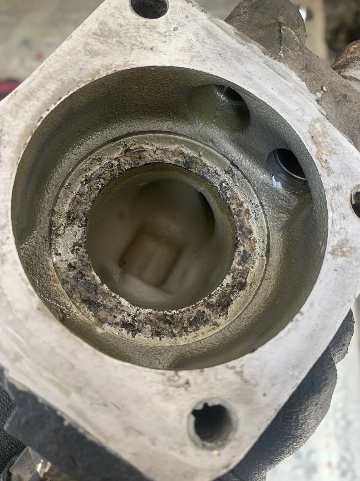

Ok that worked really well, I got the senor off which is good. However the more I compare the top of my housing to those pictures, there is a lot of corrosion and pitting of the aluminum on mine. Not sure if it would effect the performance or structure of the housing since some of it is around where the thermostat gasket would go.
some minor corrosion is expected .........
if it crosses a line of course you should consider replacing it ...........
how is the LOWER housing ?
the 2 flat gasket mating surfaces are most important
then ALL the various HOSE bibs
if the bibs are pitted badly then replace is the matter of course ..........
more photos of your housings would be helpfull ?

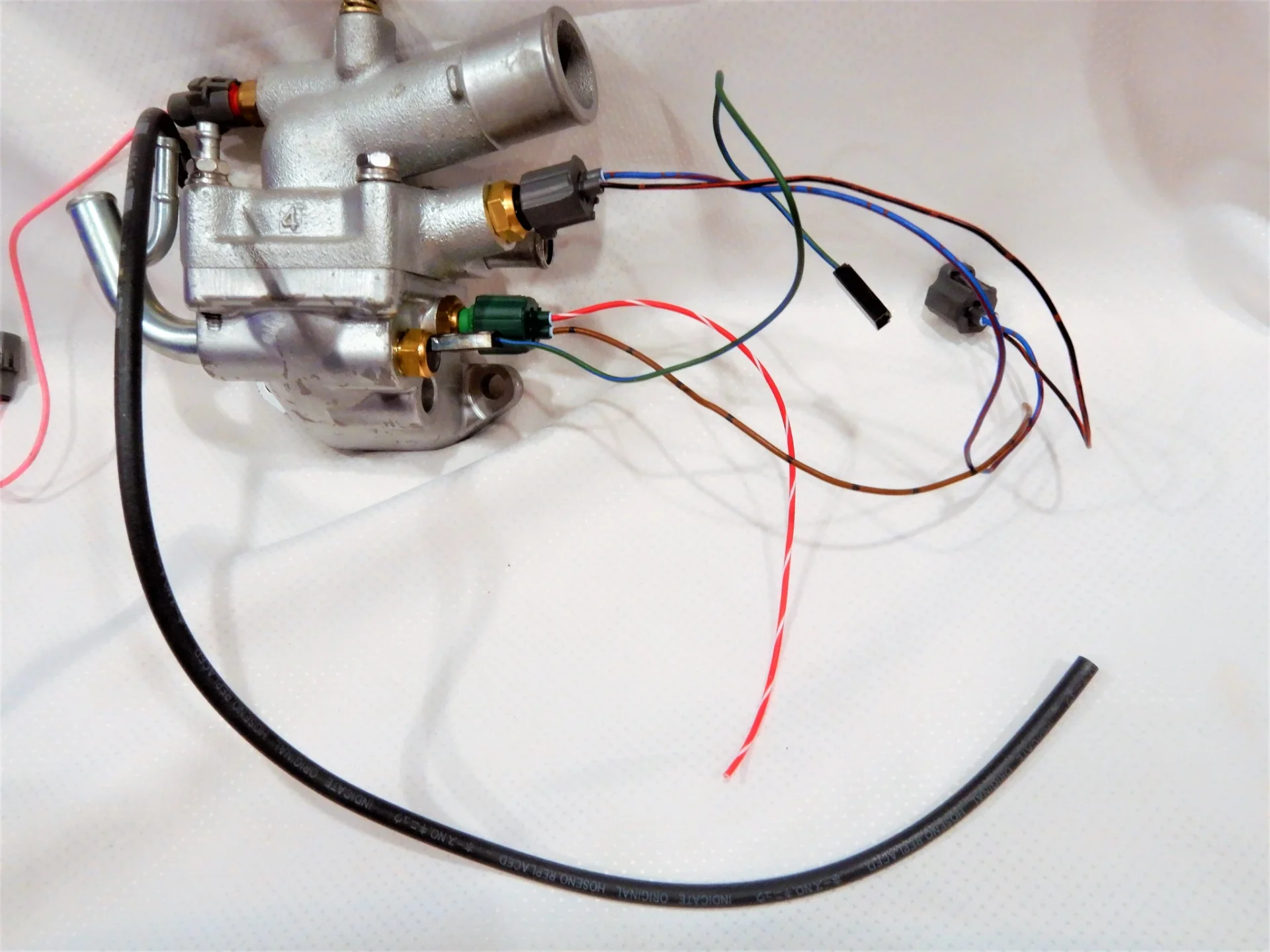

So as I find time I work on it bit by bit. One of the connectors does not have the wires attached to the connector, I'm not sure what to look up to find a video to see how to do it. If any one has advice on that it would be great. It has the wire, connector, and two metal pieces (brackets I want to call them). Messed up the first connector I tried to do and had to restart which is great, the wire slipped out after crimping it down due to not realizing what I had weren't actual crimpers. Wire is now a bit short but not too short which is good. Thanks everyone for the advice so far.
Update: I have all the female connectors on and ready to go, next step is to put the sensors on the housing, thermostat, and then gasket between the upper and lower housing. Is it necessary to put anything on the threads of the sensors before putting them back in the housing? Waiting on a new radiator drain plug since my other one had stripped threads, then put water in and flush it all out. Is it worth it to put some prestone flush and cleaner in with it drive it around then drain and put coolant in, or leave it all open and use a garden hose at the top of the radiator and flush it that way? Thanks every one for the help, has been a "fun" learning experience
