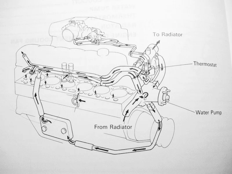

Does anyone have complete diagrams with part numbers for cooling hoses on the fj62 with 3fe. I'm scratching my head trying to figure out what goes where. I've tried searching and i own the 1988 toyota repair manual pub RM080U and it doesnt help
Did water pump / thermostat / new radiator and oil cooler hoses. Thanks!

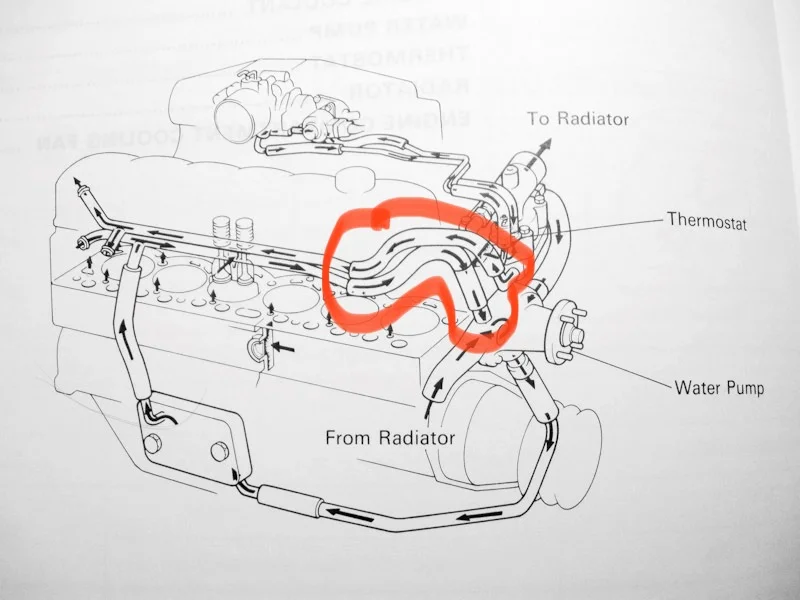

Something like this?
Ive got that one,
I think i figured out my main stumbling block
99556-30300(15777) is cut to length for the oil cooler to pipe / pipe to water pump I think that clears up 90% of my confusion

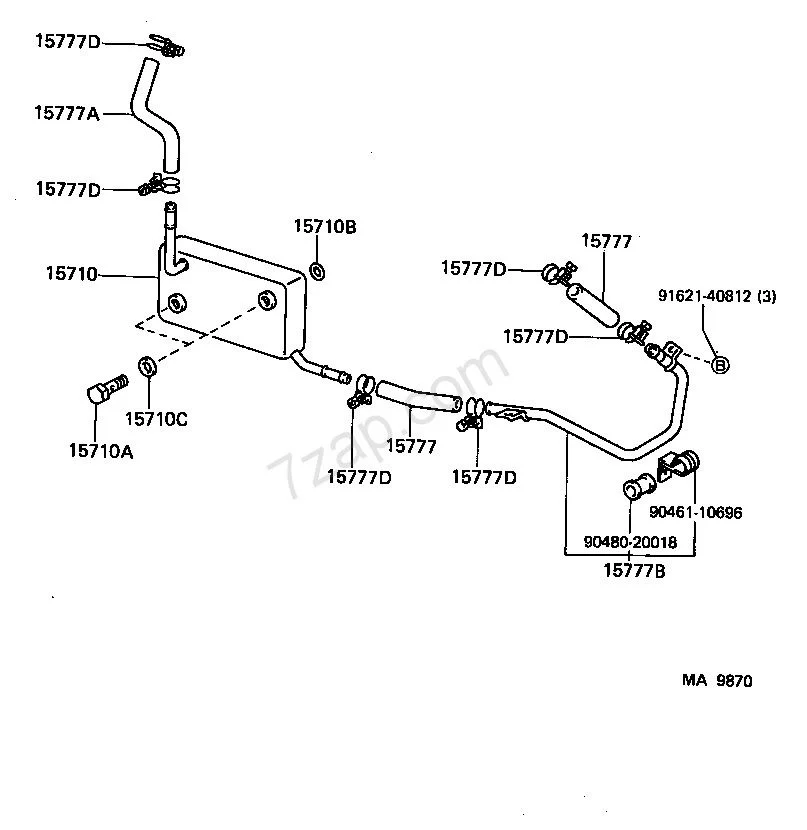

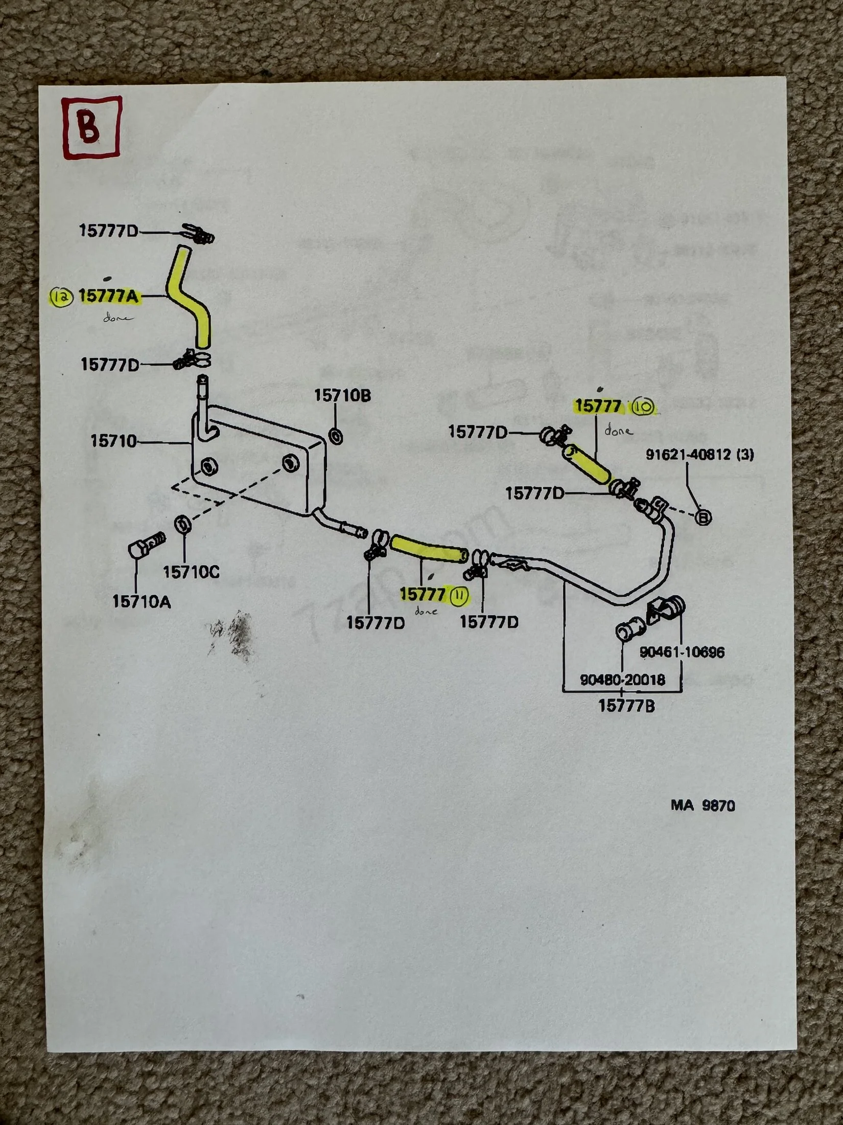

Sounds like you have this. Oil cooler plumbing.
So a lot of me tripping up was with some radiator shop using a crazy bend in place of toyota part # 99556-30300. I got that all sorted out.

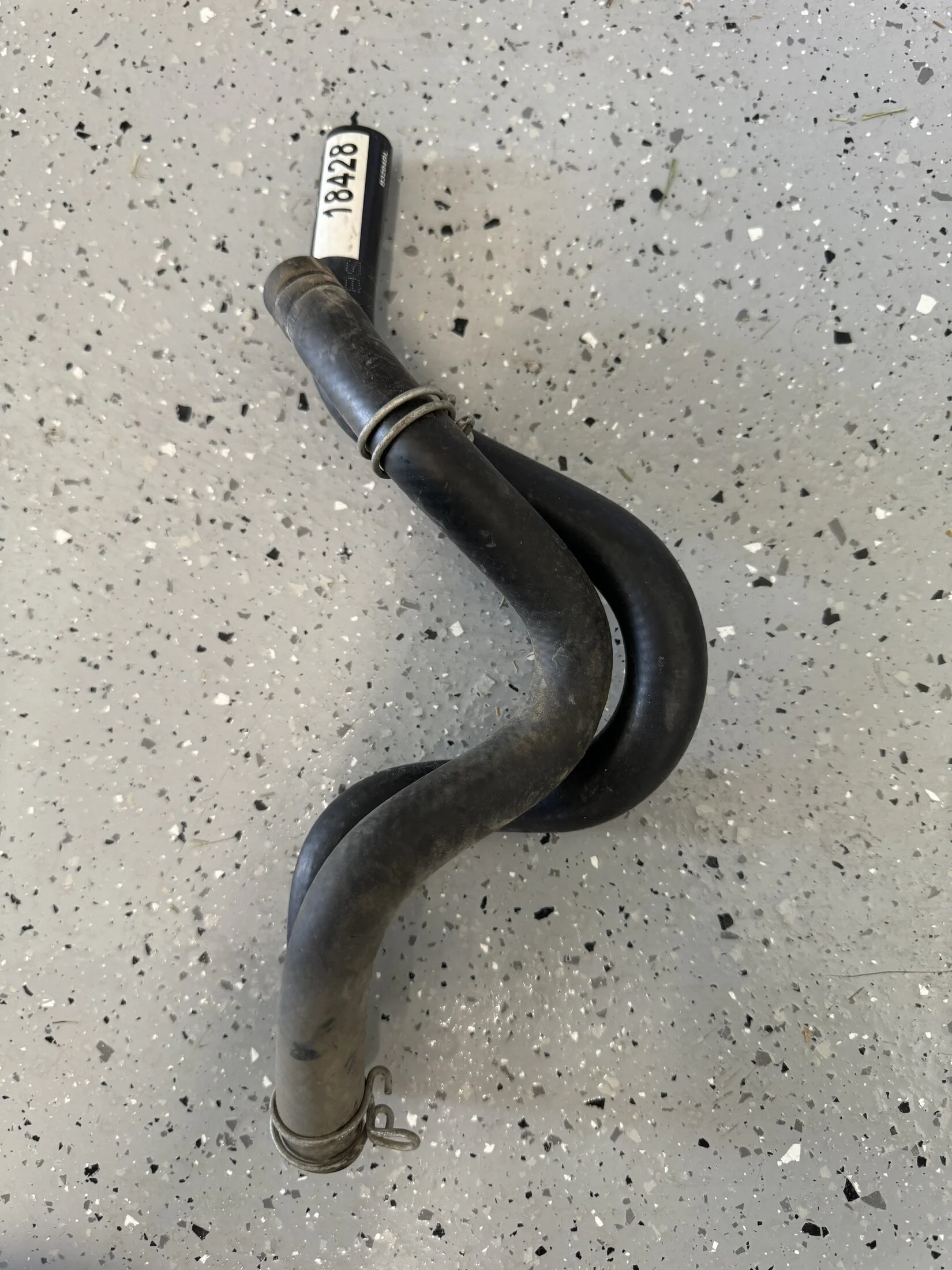

For rear seat heat on the FJ62 i have it cobbled together for now. I am going to try half inch 180 degree(ish) bends from gates 18460 (has a compound bend but should work)
I found this from Gates a visual ID of all the hoses they make with ID and length. I'll report back on rear seat hoses for an fj62 (the image above by 4cruisers appears to be fj60)

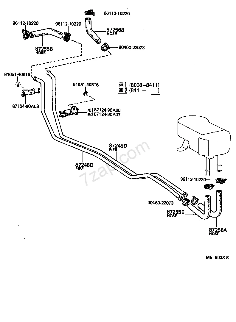

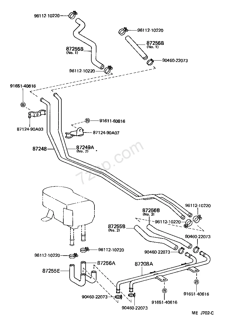

No, that's the FJ62 diagram. Here's the FJ60 diagram:
The FJ62 rear heater is under the center console, the FJ60 heater is under the passenger seat.

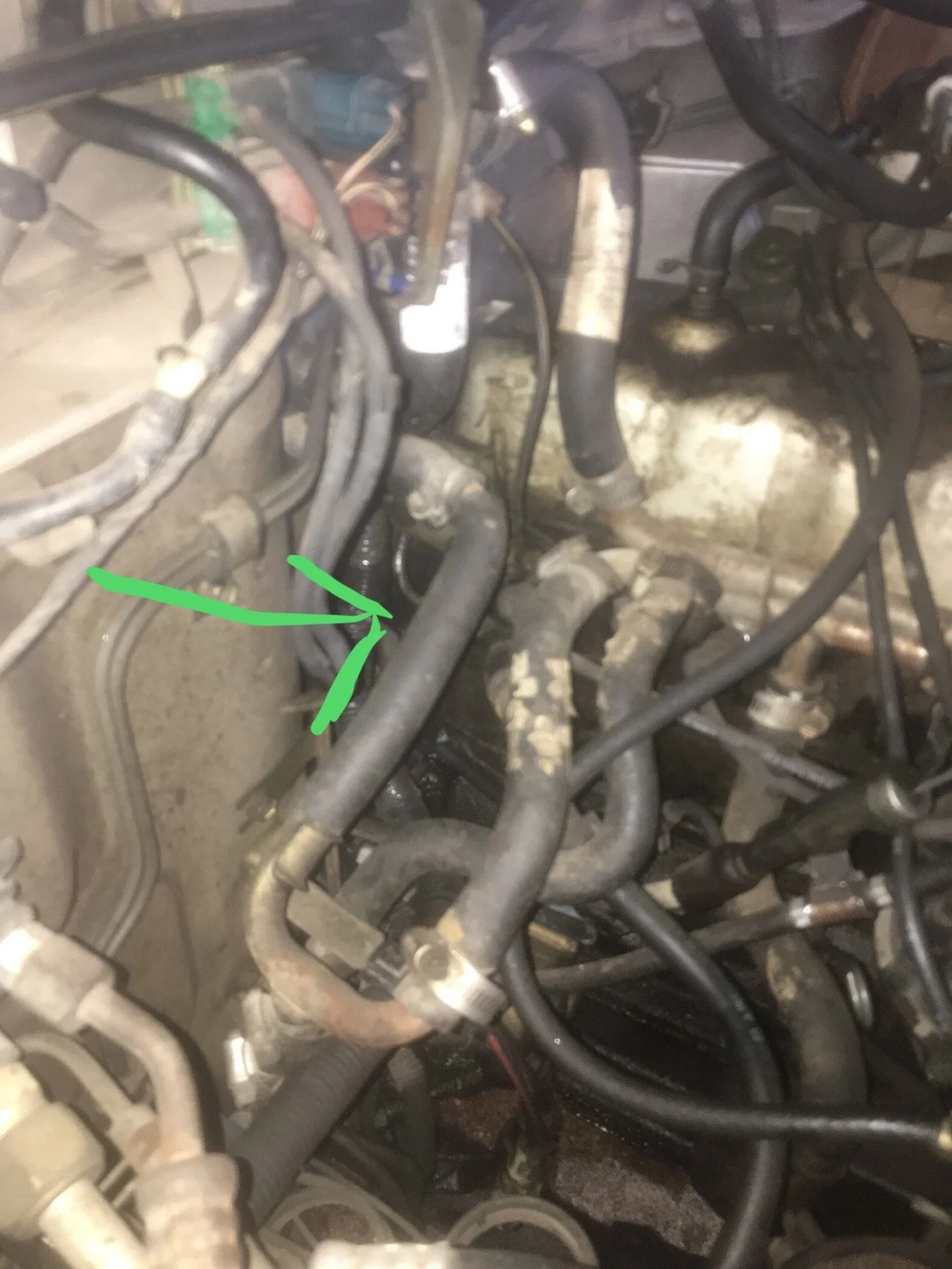

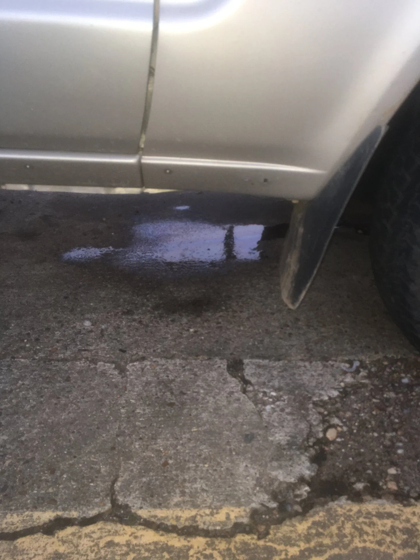

So, I’m looking at these diagrams and I’m trying to figure out where my 88 FJ62 is leaking from. Heard a hissing noise from the back of the motor around the firewall. All the visible hoses seem to be fine and leak free but it’s leaking from somewhere and draining out over the Bell housing of the transmission. The green arrow is where I hear the “hissing”
From the plug on the back of the 3FE?

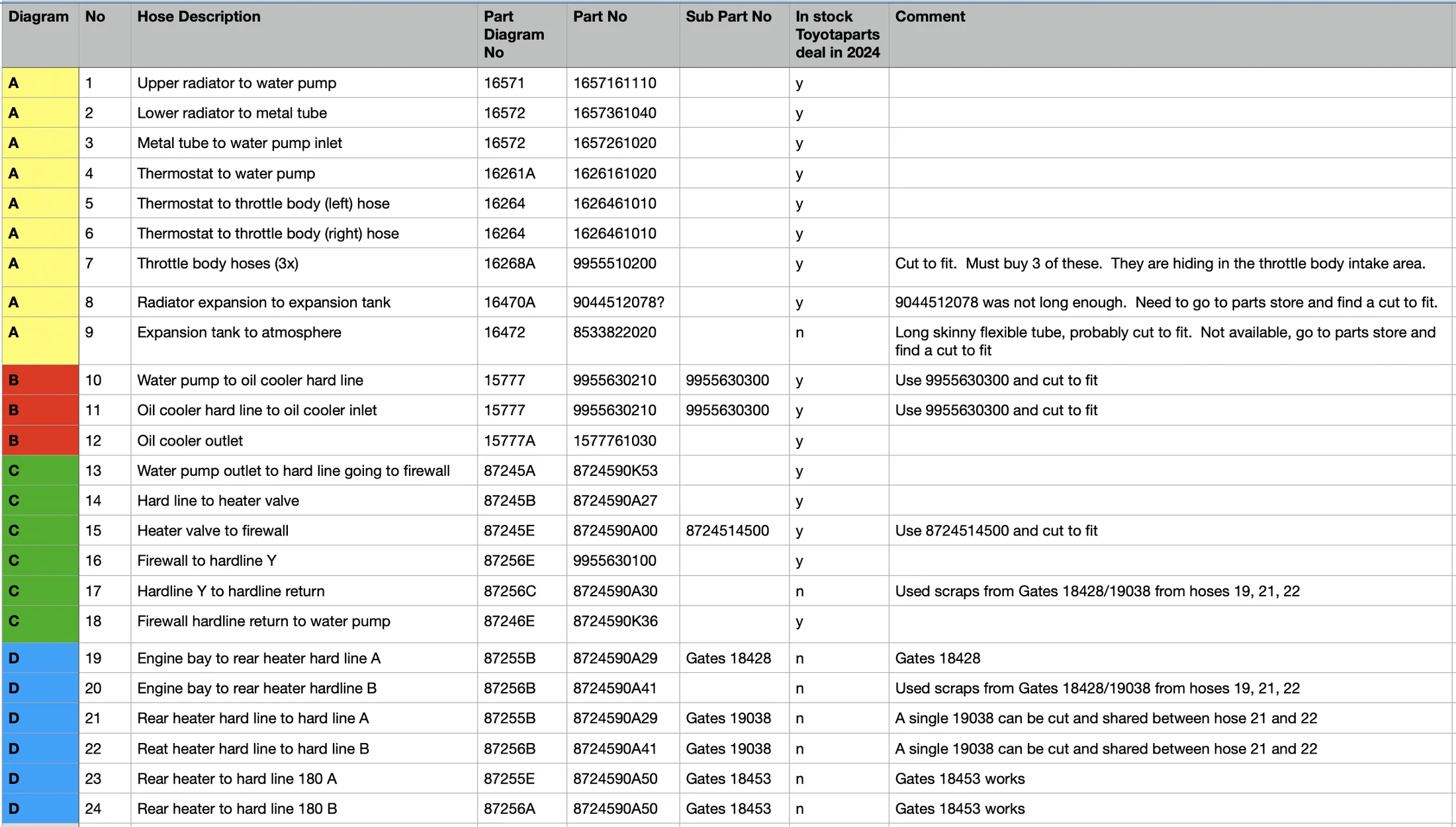

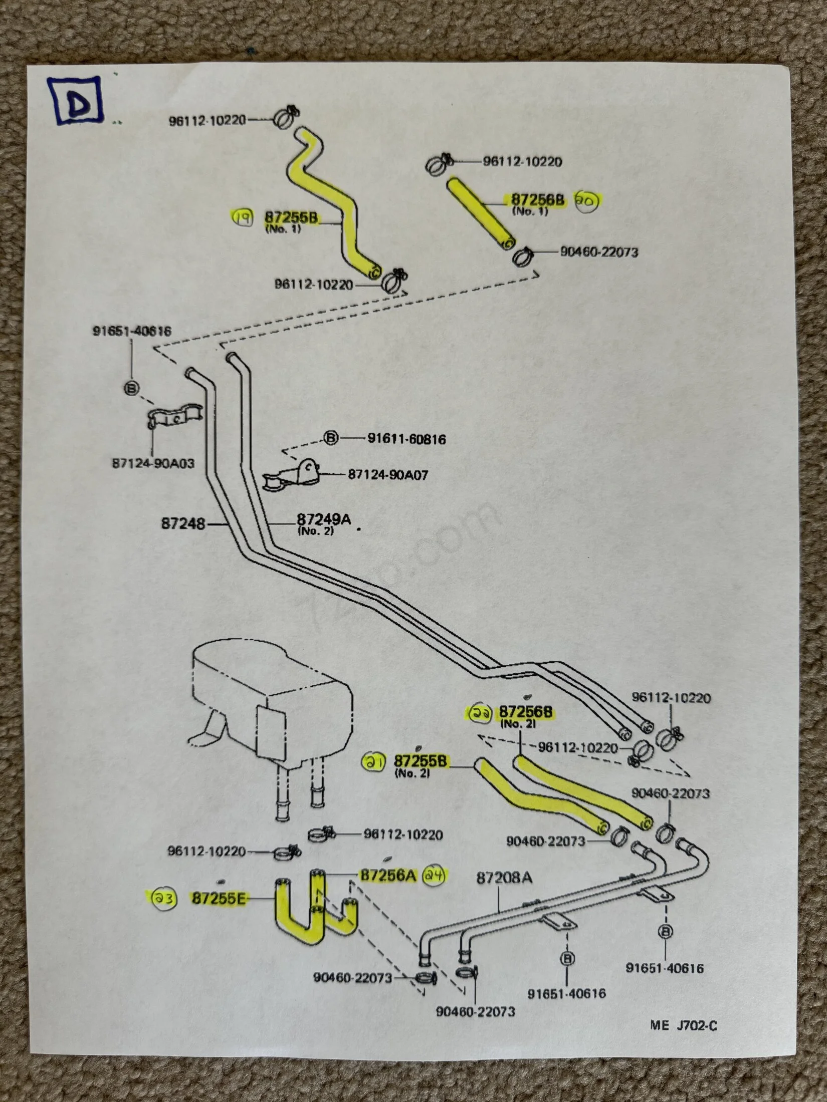

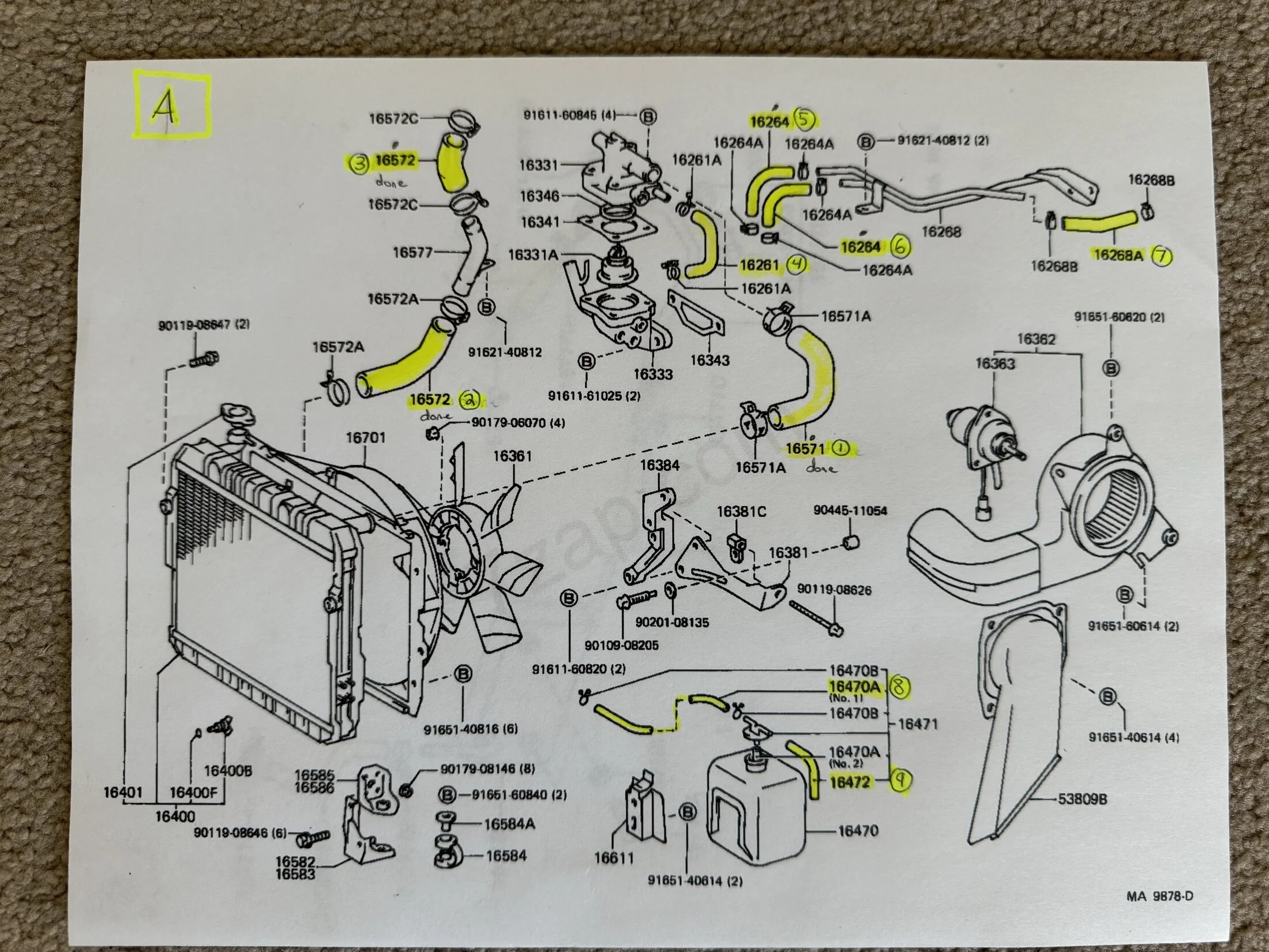

I just finished replacing the coolant and heater hoses on my FJ62 with rear heater. Finding them all was a bit of an adventure, so I thought I would share the complete list that I used here. I prioritized ordering the OEM hoses from Toyota where they are still available and then used alternates from Gates when they were not. The only two I didn't do were the ones connected to the expansion tank. Thanks go to lots of different folks on Mud for posting their gates alternates.
Diagram A
Diagram B
Diagram C
Diagram D
I just finished replacing the coolant and heater hoses on my FJ62 with rear heater. Finding them all was a bit of an adventure, so I thought I would share the complete list that I used here. I prioritized ordering the OEM hoses from Toyota where they are still available and then used alternates from Gates when they were not. The only two I didn't do were the ones connected to the expansion tank. Thanks go to lots of different folks on Mud for posting their gates alternates. View attachment 3658849
Diagram A
Diagram B
Diagram CView attachment 3658860
Diagram D
