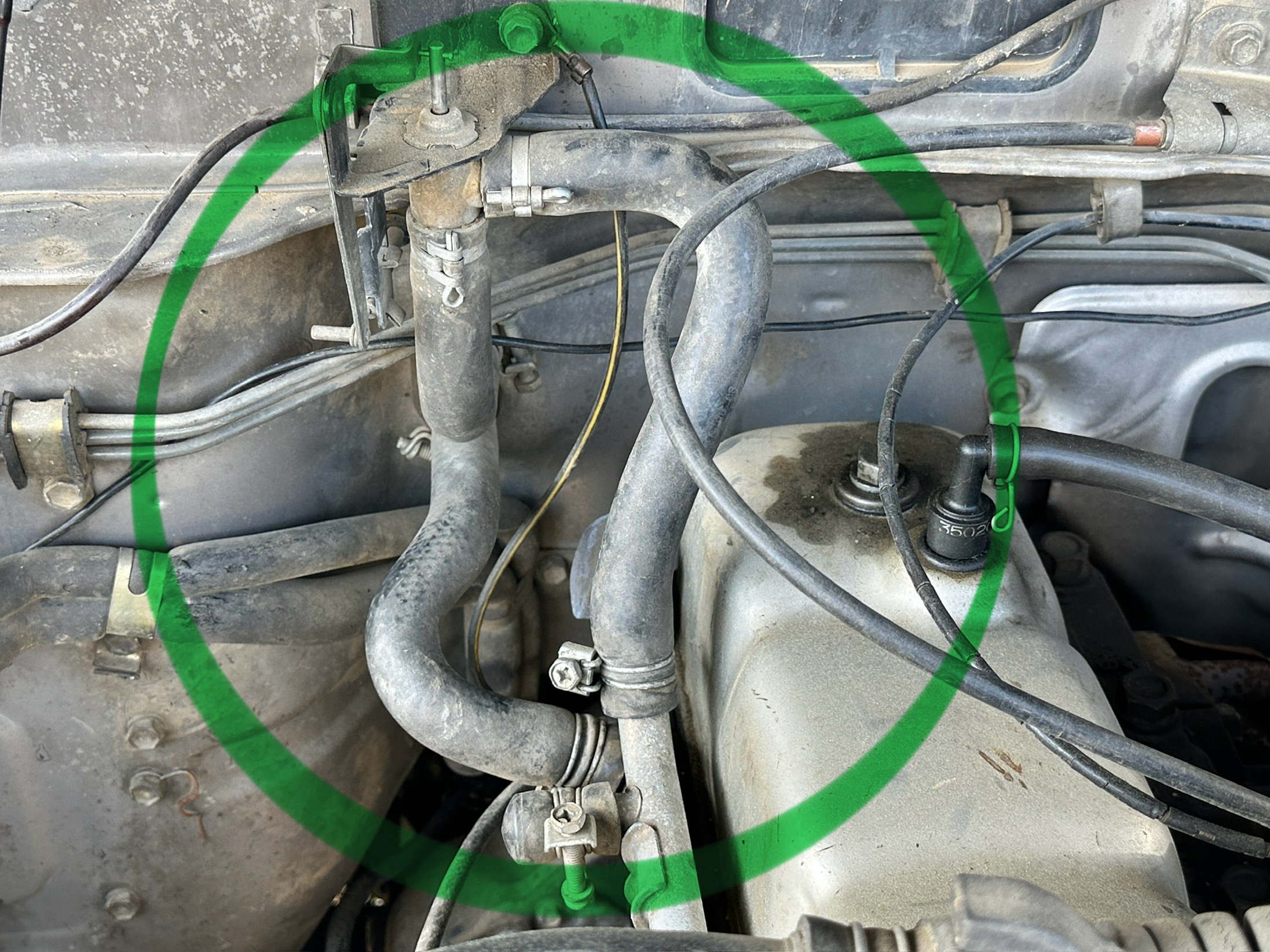

@mblakec - for my rear heater I have all hoses intact except the hard lines off the firewall are missing flexible hoses 87255B & 87256B. I have no idea where they're supposed to connect up to so they can bring coolant in/out to the rear heater. Do you know? I wonder if PO did a sloppy delete. I purchased over the summer and shipped up to Boston from TN so guessing the PO had no need for rear heat. It would be great to get the rear heater pumping since the front heat isn't strong enough to warm the entire cabin at cold temps.
Hi @mabbet, I traced the connection to the rear heater supply return with the red and green lines. You’ll see one connects to a hard pipe by the motor and the other connects to a tee.

@mblakec Ok, that makes sense now. The PO removed the T pipe and replaced it with a U pipe. Do you happen to know the part # for the t pipe? One more question, why would the PO bypass the rear heat? I wonder if there is a clogged pipe so wasn't pumping heat. I will try to flush the rear lines today and see if water flows in/out. Thanks!
@mblakec One second look I still have the t pipe but PO ran the hose from the t pipe to the engine to bypass rear heater. If the lines flush out today, I should be able to reconnect pretty easily, right? Looks like I need to buy hoses 19 & 20 from your "D" diagram. Can you confirm? Thanks!
Yep, you just need 19 and 20. That’s nice that the T is still there.
Some people bypass the rear heater just so that they have less potential points of failure. I think that’s most likely. Good idea regardless to flush everything though.

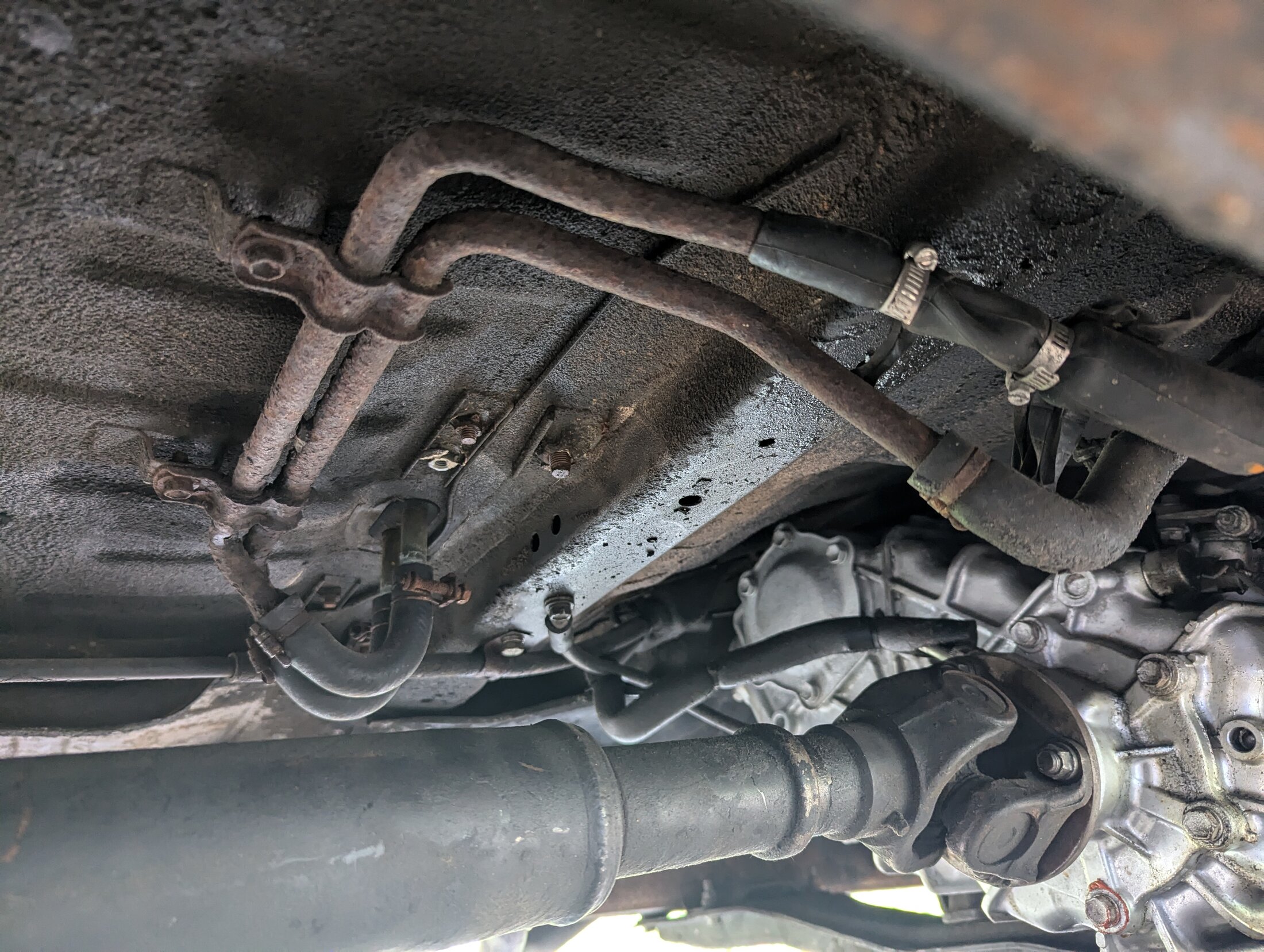

@mblakec I flushed out the lines and now I know why he bypasses. The hardlines from the rear heater core are corroded and leaking. Part # 87208A. Did you have to replace that part as well?

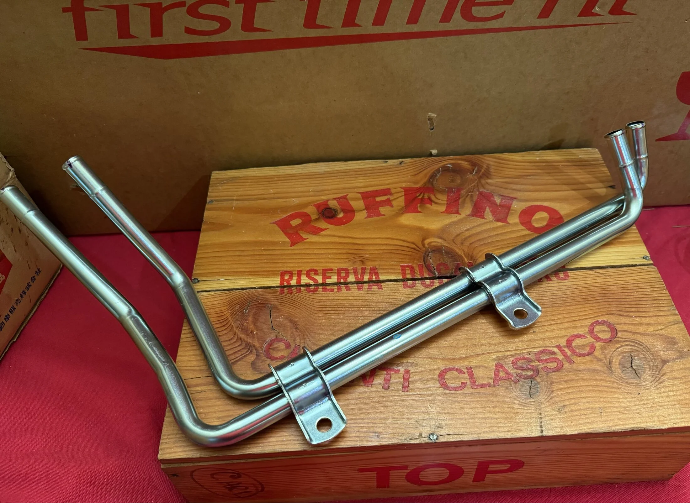

Now I see 87208A
This is a 87208A from a 60 Series ….
I am 💯 % certain of this ..
It is the correct 13mm OD rear heater tubing and will use a M8 bolt / faster
Let me know if you require any additional Tech
I have had this for maybe close to 15 + years
NOS / zero corrosion or flaws to report …
Matt
@ToyotaMatt do you carry part# toyota 87208A?
Bummer. I didn’t have to replace my hard lines, so I haven’t tried sourcing them. Hopefully ToyotaMatt can get you straightened out.
This is a 87208A from a 8/80 - 1/90
60 Series ….
I do not know what model BJ6# FJ6# or HJ6# it applies to …?
Let me know if you require any additional Tech Metric Measurements etc ..
I have had this 87208A for maybe close to 15 + years approaching 2 decades
I can compare it to my 5/89 Canada Spec. FJ62LG-PNEK in a hour or
So if this helps here ?
Matt

@ToyotaMatt that looks like the piece See the picture below.
i concur a solid current-fitment match visually as well ...
what say you ......?

@ToyotaMatt I'm getting 150mm too. It's dark here in Boston but i measured center to center on the bolt heads and shows 150 mm. See below.

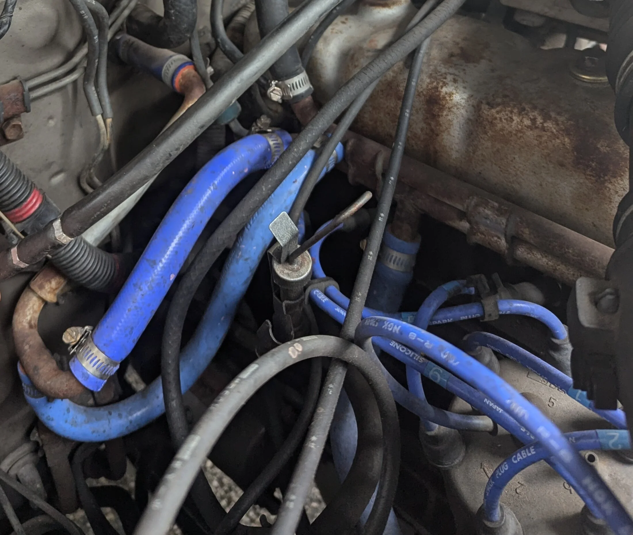

Jumping in and hoping that the hive can help me out. I can’t find these on any of the diagrams in this thread. It is for a non-US spec FJ62 with a 3F engine. No rear heat.
Does anyone have any thoughts or philosophical insights on what p/n OEM or Gates these might be?
Right hose - Toyota 8724590A27
Upper left - Toyota 8724514500 (cut to fit)
Lower left - I’m not sure on this one as I have rear heat and that one is different as a result.
I had trouble sourcing those hoses, so I ended up just cutting to fit. It's been a good winter with hot water flowing to the front and rear cores. Now, on to the starter... it never ends, but I wouldn't trade the old girl for anything else.
