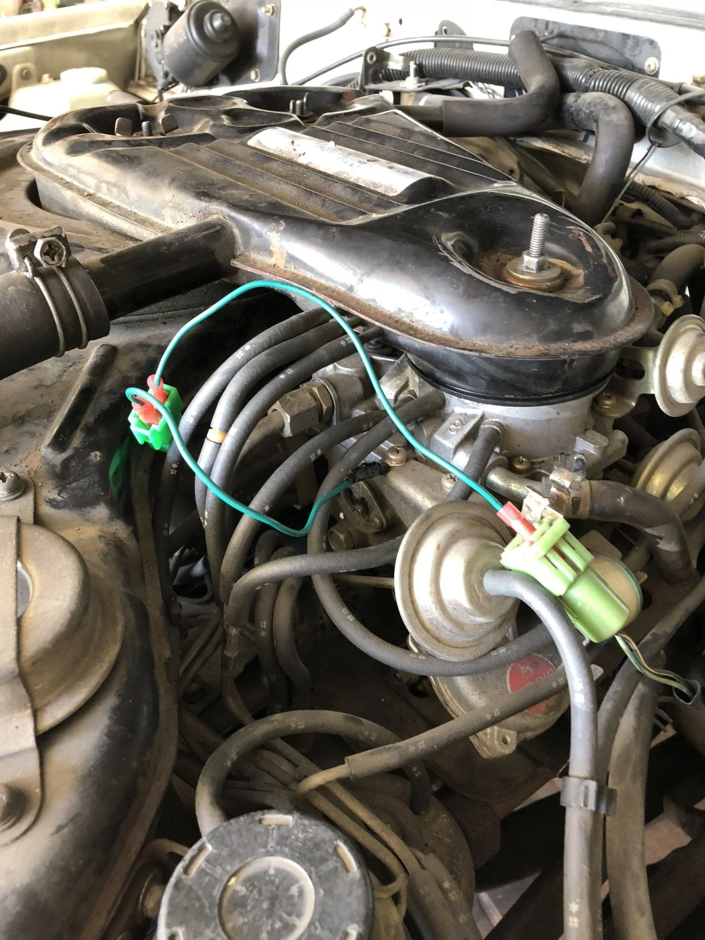

Why jump straight across? His plug works, but may not be getting grounded. He needs to jumper hot to hot on the plug - and ground his ICS directly to the carb using the other jumper. There are pictures showing this. And probably links (or search for) to the green wire mod (white wire on ics side gets grounded)
Yeah understood. The OP's plugs no longer fit together. Its different on the replacement ICS. So trying to initially connect both sides using jumper wires.
What’s a jumper? The original one has the two metal pieces horizontal & the new one has one horizontal and one vertical.
The OP did not really specify what 'wiring' was done, but I assume it was the jumper wires suggested by @NeverGiveUpYota. Was more suggesting a method to troubleshoot the wiring they did and assuming the grounding is good, just that the ICS is not connected properly causing it to not energize (either ground or hot or both). Agreed though the ICS ground bypass would rule out a ground issue and may fix the OP's problem at the same time at the expense of bypassing the ECU control of the ICS intended by the factory, which has its own sets of issues. I included a pic of the exact bypass mod done on my truck as a guide for doing that earlier in this thread which I'll include again here if the OP is interested:
Hopefully you can tell how it was done.
To the OP: Could we see pics of what wiring option was used on your truck?

Yes, I'll get you a pic this weekend. I may try to re-do my jumper wires first just to make sure the connection is good. And you're correct, that's all the wiring I did. Connecting the ICS into the carb seemed pretty straight forward. I'll try grounding it to the carb this weekend too and see if that works. Would make sense.
If you intermixed your jumper wires you may have blown the engine fuse. I've done that before. Just double check the fuse before you go any further.
Ah. Good to know. I bet I did. I'll double check it. Thanks!
Ok, so my fuse was good. Got the jumper wires set up and grounded it to the carb (pic below). Idled no problem for about 5 minutes. Took her for a test run and it died the first two times i tried to stop at a stop sign, but then ran fine. Drove for about 5 minutes without an issue. Coming home, came down a hill, and it died around 1K RPM. After that it would die every time i hit the breaks, or had the rpm below about 1K. Let it sit for a few minutes after I got home, started it up again and it idled fine.
So just to be clear, no change if you swap wires around at the ICS plug? As @John McVicker stated you should, with the key on, hear an audible click when plugging the jumpers in and out. Since your two plugs don't fit together, you'll have to use the jumpers to test this. Could just take one of your jumpers off, and touch it to the pin in the plug and get the click the way you have things set up now. I can't really tell in the pic the colors of the ICS side wires, so can't really tell if the polarity is correct, but now that you have the ground bypassed to the carb, its easy to swap things around on the ICS side plug. Might try messing with it until the thing clicks. If you are not hearing it then as @John McVicker said its wiring somewhere or ICS itself. I have had the polarity reversed on my ICS and it ran like crap until I swapped jumpers around. It will most likely keep dying until you figure out how to get the click to happen. On my truck, I am usually troubleshooting this after driving it (cause I am pissed its not idling) and the ticks of the engine cooling down sometimes drown out the click of the ICS. With my crap hearing the two sound the same.
You also again might want to get a multi-meter on the truck side plug and make sure you are even getting +12 volts up to it. Ground does not matter if there is no positive voltage to the solenoid. If you are getting good ground and +12 at the truck side plug then you can focus on the actual ICS itself or the jumpers you made.

-The original ICS was heard to click when disconnecting and connecting green connector
-Replaced with new one from cruiser corps
— jumpered the non mating connectors
No click and no improvement (not sure it’s hooked up correctly)
— manually grounded ICS to carb and jumpered hot side between connectors
Improved idle, idled for 5 minutes, test drove it and found lingering problems
* check for audible click when removing spade connector
*Unsure if polarity is correct, check with key on and a voltmeter or test light
*Lingering problems: idled for 5 minutes but still died while downshifting and braking at 1K rpm or braking for stop lights or when below 1K rpm. Idled fine after getting home and shutting it off for a little while

Ok, so I double checked my wiring. Definitely hear a click when i attach my jumper wires. It will idle with both jumper wires connected to the ICS, but not great. Definitely better when it is grounded at the carb. Had a vac hose off as well (prob from taking the air filter cover off and on). Any problem with leaving it grounded to the carb? Seems to run fine now, but idling a little low, around 500-700 rpm. Seems like it will only occasionally die if the idle falls below 500. Idles a little higher after the engine has warmed up. I looked into increasing the idle, but seems like a little bit of a complicated process and want to make sure it's done right. At least it seems to be running 98% of the time lol.
