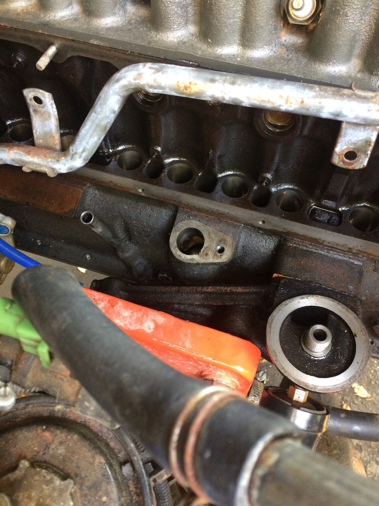

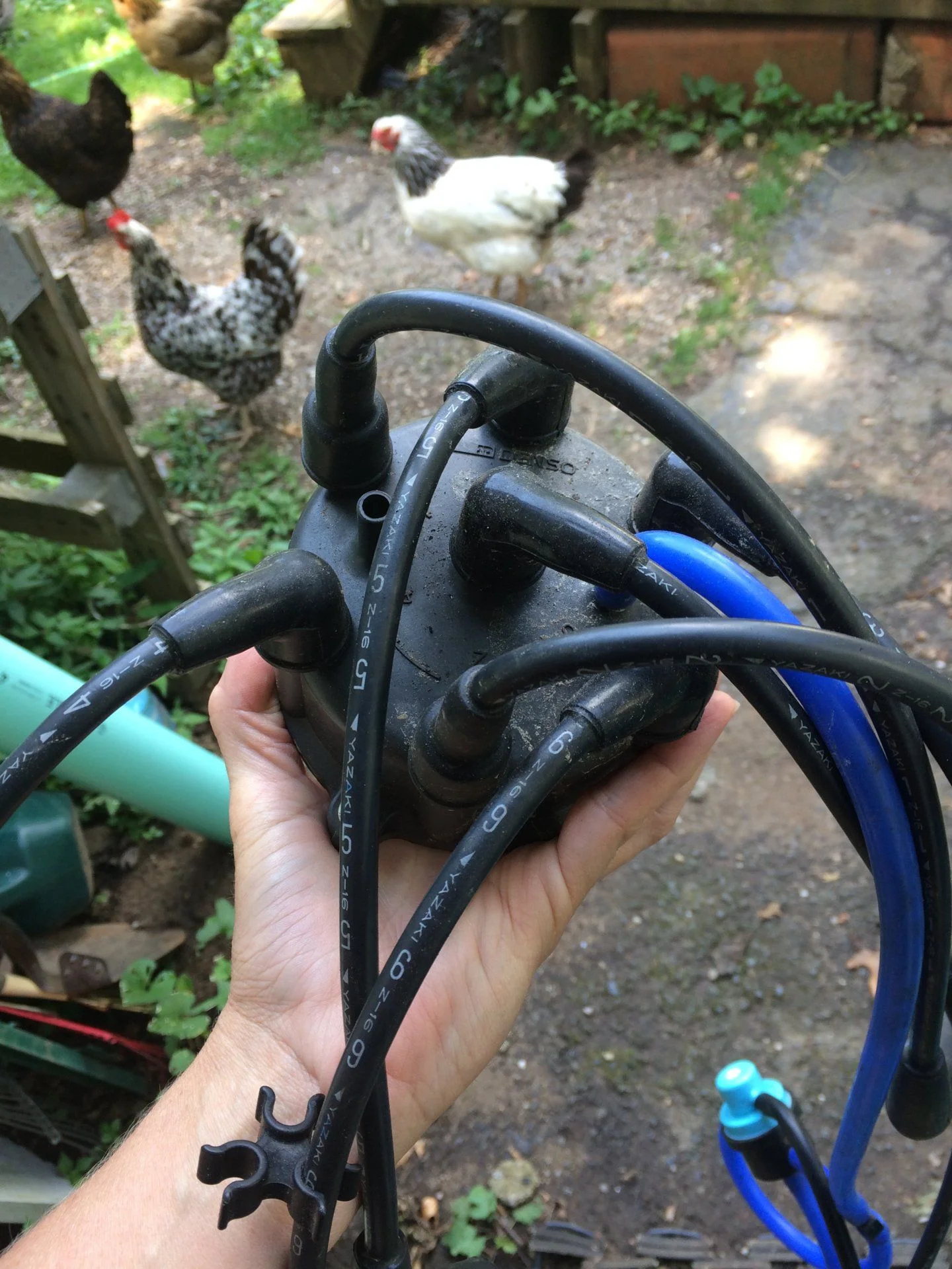

My mechanic experience is somewhat limited and self taught...so excuse my ignorance, lol, but where is the distribuor cap?

Ha! I was going to go out and take a photo but my diz is pulled along w/ a bunch of other parts... I can add a photo of the empty hole. ;) smaller hole in photo (has a bolt hole next to it to the right, dip stick hole to left and to far right is the oil filter housing... photo of diz cap as well.

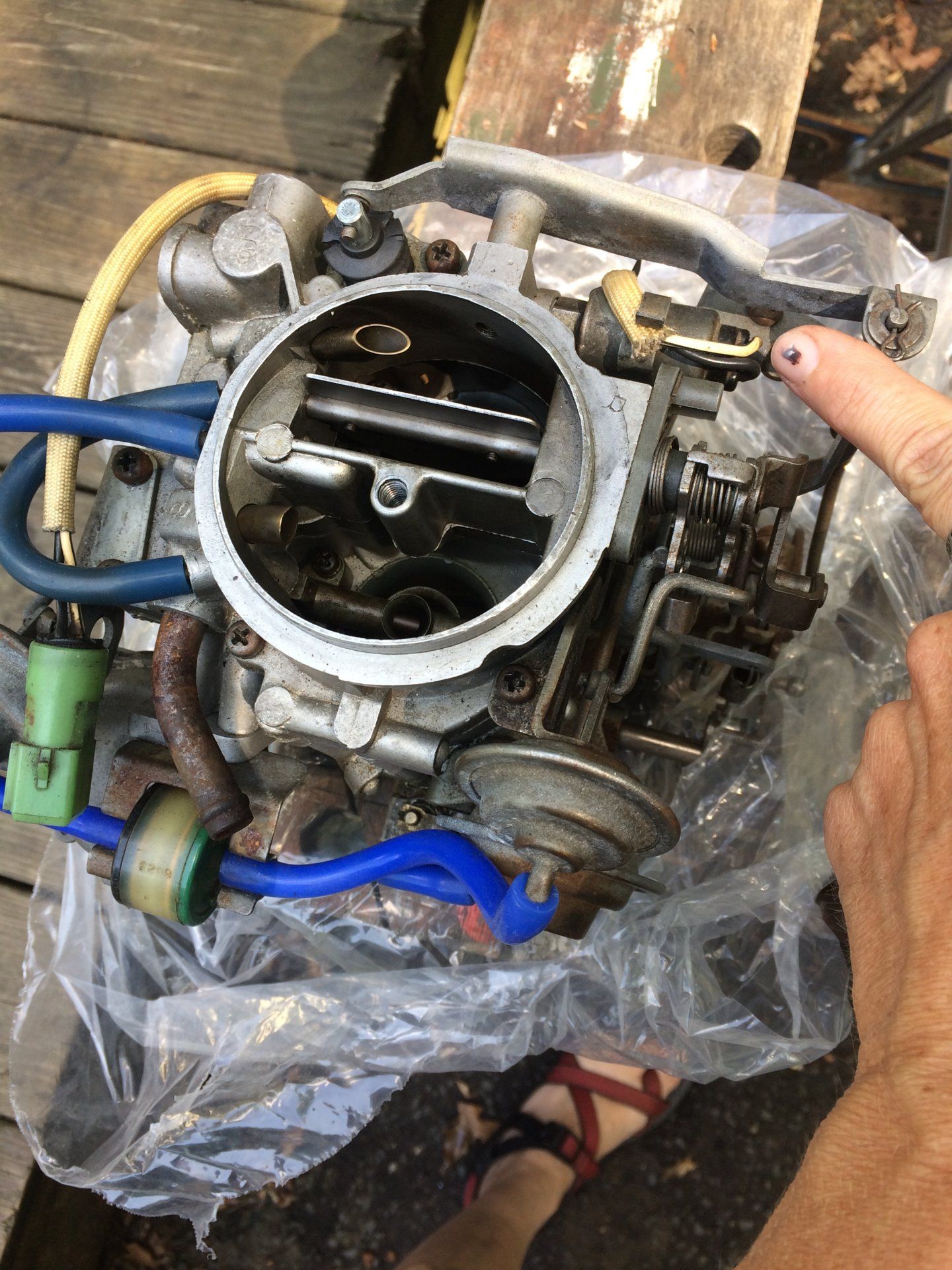

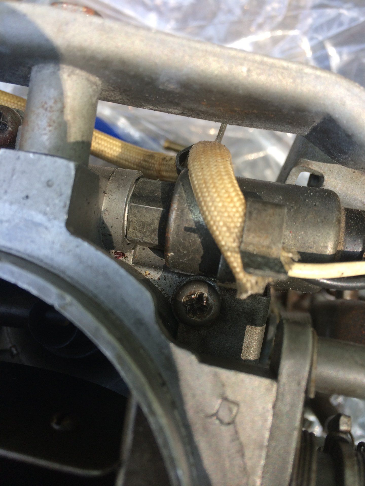

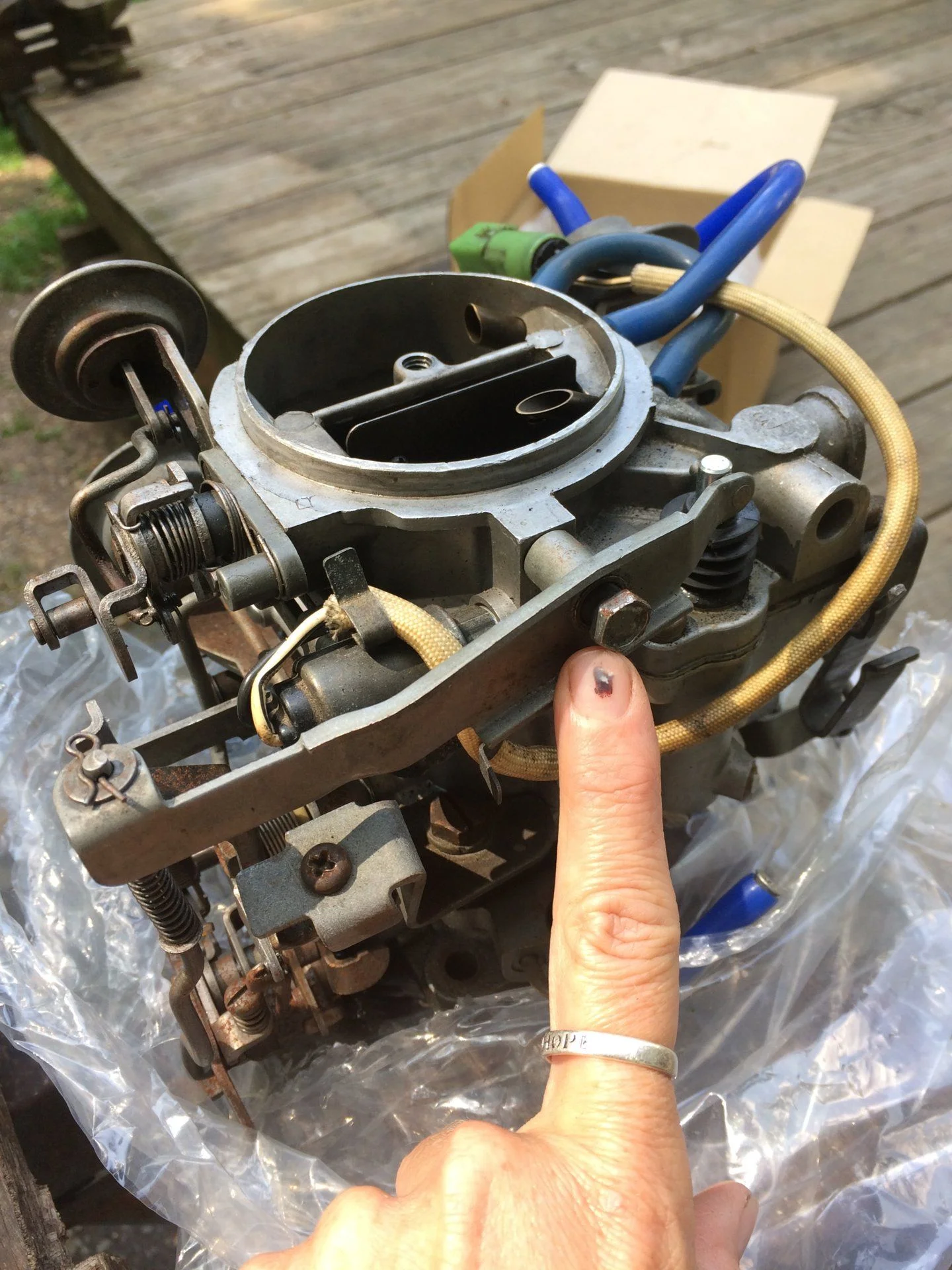

Photo of carb and me pointing to the idle fuel cut solenoid. If your replacing try to buy a used one and not one from China. It’s well known they don’t work as well as oem. I also pointed out a bolt on the ACC lever you’d need to remove to get the lever out of the way to loosen its 12mm end where it screws into the carb. Be sure to replace the o-ring on its end. Very tiny. Can befound at an Ace Hardware in their o-ring assortment bin.
