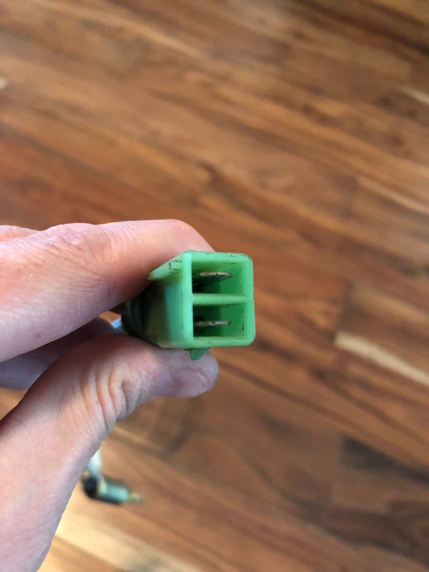

Well, I finally got a chance to replace the ICS...got the new one installed fairly easily..went to connect it and the connection is different on the new one than the original. I think I got the first one from cruiser corps or something, and it says it fits my model, but obviously doesn't. Any ideas where to look? I've attached a pic of the connection from the part I removed from the truck.. Thanks!!

What’s a jumper? The original one has the two metal pieces horizontal & the new one has one horizontal and one vertical.

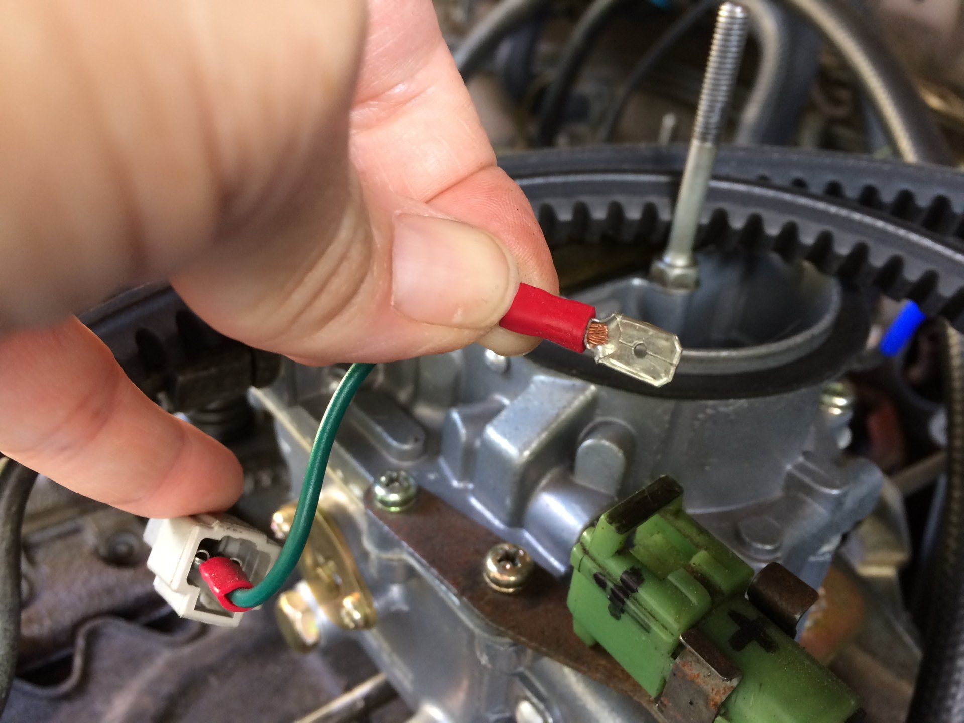

I think NeverGiveUpYota is referring to making jumper wires to connect the two ends of the plug. Something like this:

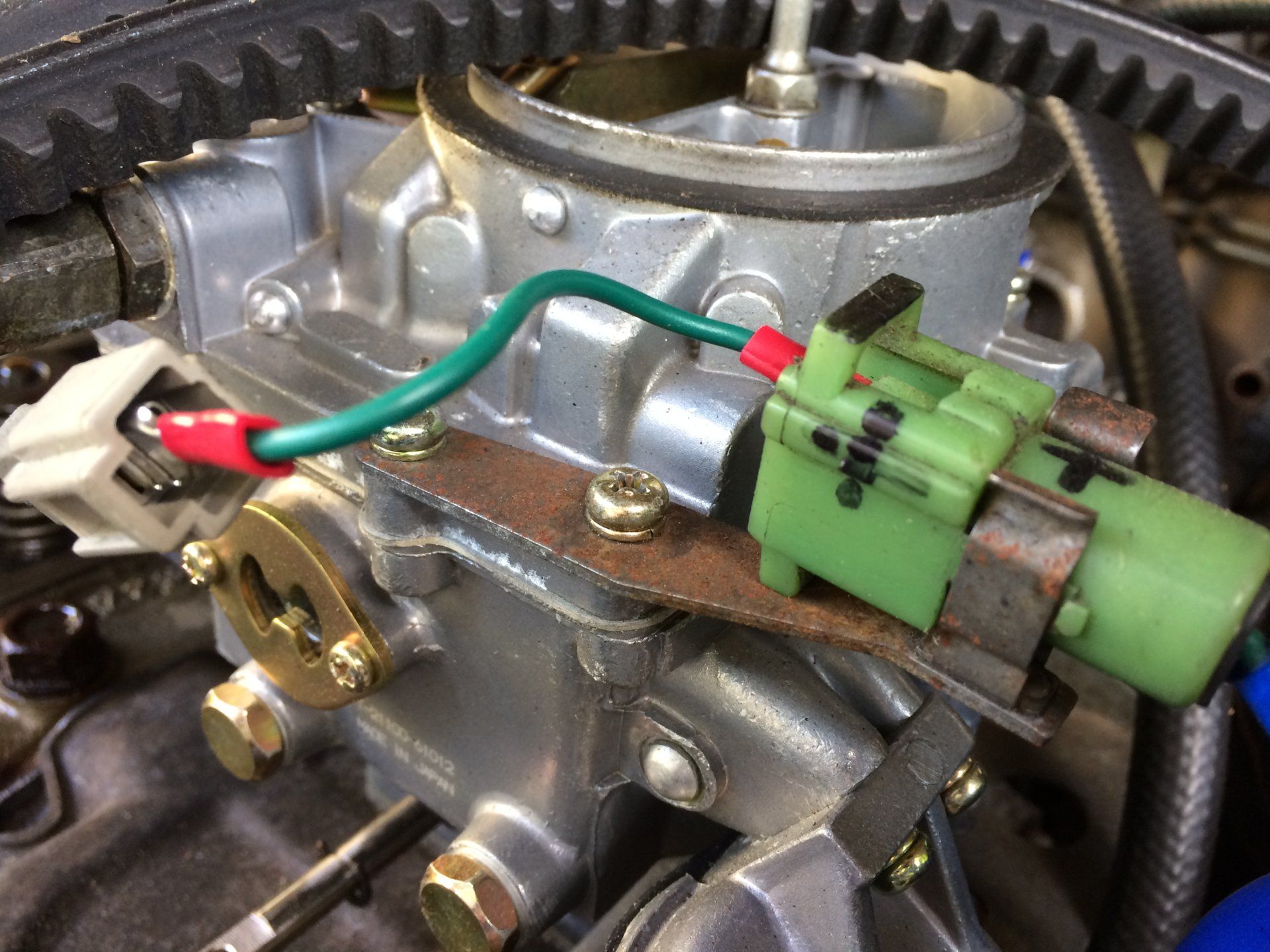

Used spade connectors I had similar issues to what you are describing. The grounds on these sometimes go bad over time (grounded at emissions computer on mine) so I did this to simply get a good ground for the ICS to open up to allow fuel to flow. Once I did this the truck now idles. But would prolly work for you to connect your ICS with the two different plugs. Hopefully you can tell which side is ground (lead going to carb body) in this pic.

Yes apologies it took me so long to respond. Very simple to make. My city racer requires only one but the one you have would need two. One for positive and one for negative. And I was right, the nub side of the green connector is positive. I used 18g.
Some will ground straight to carb body like in his photo above to bypass the emissions computer but that can have set backs. It’s the most wise to do it the way it should be but sometimes the emissions computers solder lead has cracks in it and it's faulty. Guessing your new in this world of a 60?

ICS itself. Up by the carb. Simple thing is to swap the wires around to check you have the right polarity. You could also just get a 12-volt test light with alligator clips, and use that to test the wiring. You could just put the clips on the terminals in the truck side of the plug and see if it lights up when you turn on the key. Then if that does not work you can take the ground side alligator clip on the test light and hook it to the carb and see if it lights up then (this effectively bypasses the ground at the emissions computer). If it does it would tell you that you are getting +12 volts on that ICS harness, but not getting back to ground to allow it to open. Then you could look at the Emissions computer on the driver side kick panel. The ICS is grounded in that computer (PCB board) and the leads where the harness plugs into it go bad so the ICS no longer can ground out and energize and thus open. Look back at my photo I posted to make sure you have the correct polarity(hot and ground).
Having said all that as a quick test you could just do the carb ground bypass trick in my photo. If it runs then you know its definitely electrical and can look at the ECU. If still no go then you could move on to something else. Funny enough I am chasing this same thing right now myself. Plan on re-flowing the solder joints on my ECU this weekend.
