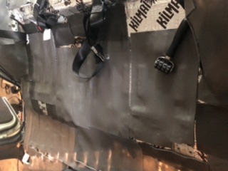

Took the poor man's route and remove my interior, pressure washed carpet and reinstalled after putting down Kilmat 80mil and Noico red 150.
Didn't feel like the investment in the new carpet was worth it, as it has been said before here this thing isn't going to a museum or BAT. I happy with sound proofing and restoration of carpet.
After pressure washing we hung carpet on a line and banged additional dirt out for another 20 minutes amazing what 30 year old carpet will hold
That’s disappointing to hear. They advertise the red 150 as a good sound reducer.@Built4Camp I wish i could say it was like driving a Rolls just more dependable. I only noticed a little difference with noise and heat, but I think this project is worth it because you can inspect covered up areas for rust and really freshen up interior.
