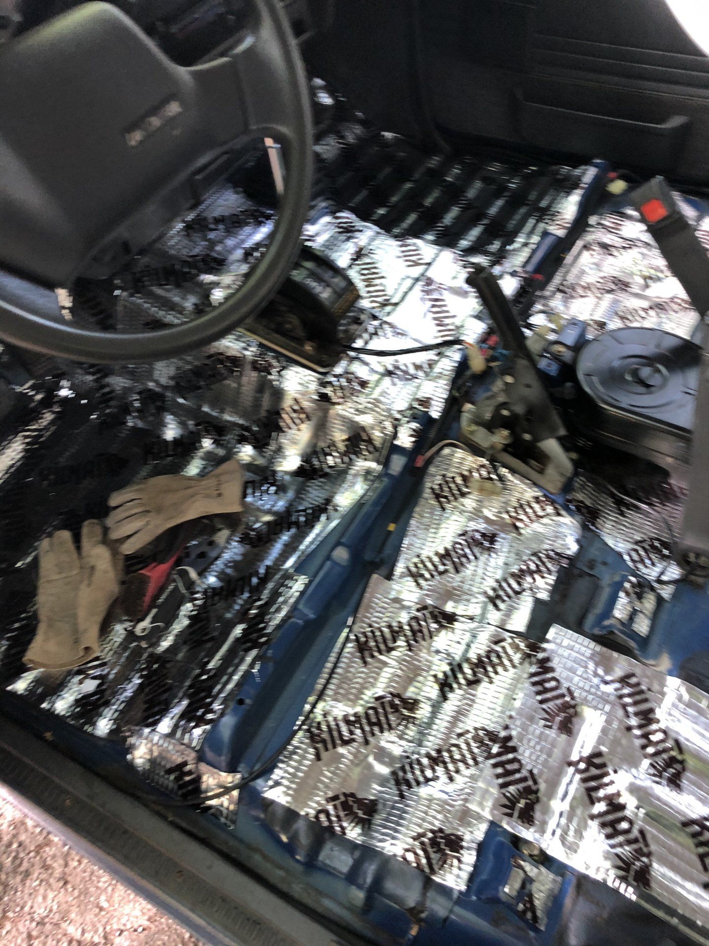

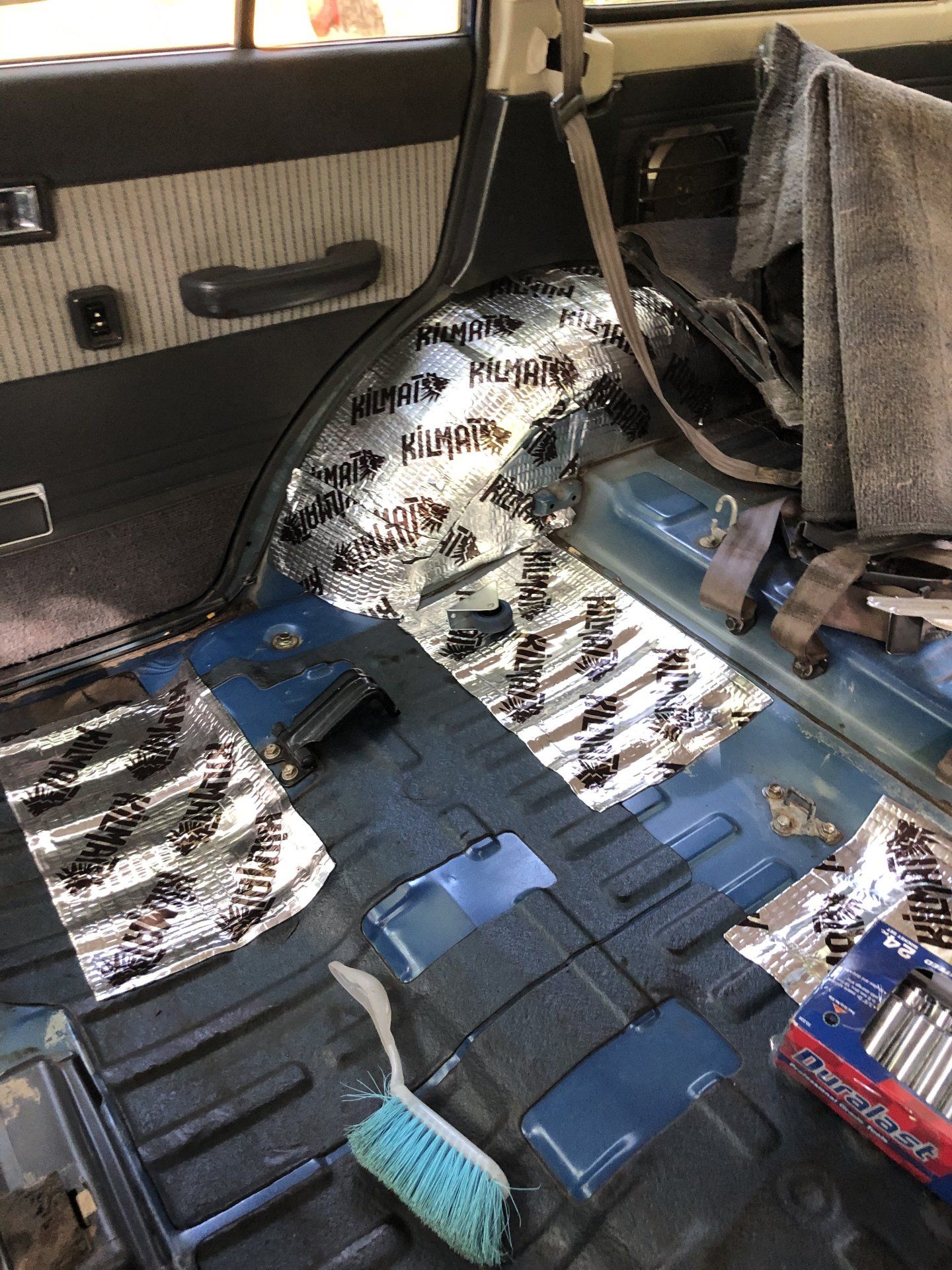

Here's some more inspirational photos. I saw this thread a few months ago and got some inspiration to do this to my own cruiser.
1. stripped out interior
2. removed oe sound deadener (tip: use computer air duster cans - don't shake, turn upside down, spray on, then shatter with rubber hammer, vacuum up.)
3. sanded off some surface rust, sprayed rust reformer, and then primed floor board.
4. applied kilmat 80mil everywhere! Floor, wheel wells, trans hump, doors, rear quarters
5. Applied 150 noico over every place I put the kilmat
6. Installed new carpet from @dnp
Doing this has made a huge difference on how the truck feels and sounds while driving. I think I could hear a mouse fart it's that quiet now. The only thing I really hear while driving is the engine but I still need to add the hood insulation wince I took mine off because it was all chewed up.
Kilmat 80 Mil:
I agree. Also, I imagine that front 1/3 of the truck is where most of the noise is coming in - or at least that's where you're sitting, so that's where you're going to hear it.
Yeah trans hump and wheel wells will be the most important to cover in my opinion. Next would be the doors and rear quarters.
@jjones I'm jealous that your wheel well vinyl covers are still presentable. I like them better than the carpet that comes in the kits. Mine are just a bit too chewed up to look good next to the new carpet.
I'll be adding the doors and rear quarters when I tackle upholstery.
