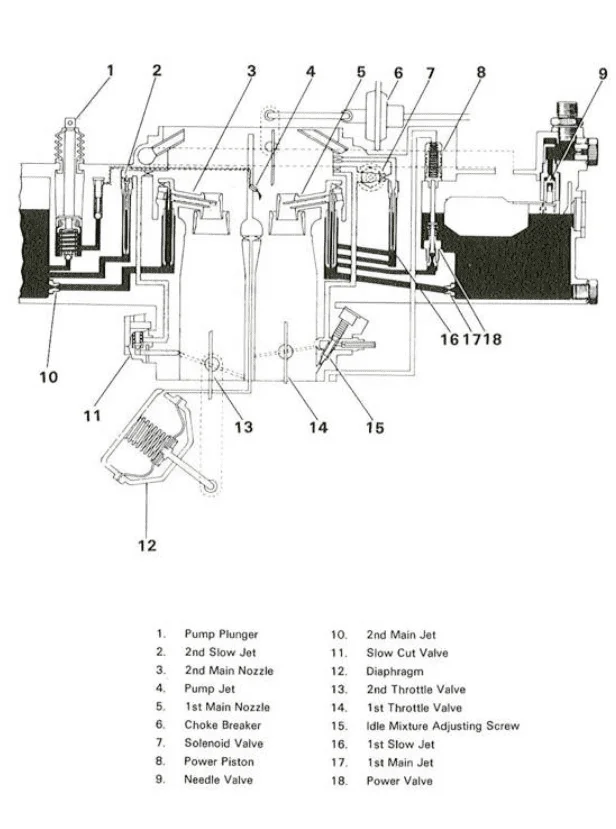

It does seem like a problem with getting fuel into the cylinders. If your float bowl has fuel in it (as seen through the window), then I would think the fuel is getting to the carburetor. Looking at the schematic below, when the car is at idle, the 1st throttle valve (#14) is mostly closed, and the gas is pulled into the engine through the needle valve (#9). But the solenoid valve (#7) must also be open.
I would pull the needle valve out and spray spray some carb cleaner into the port. I would also remove the solenoid valve and confirm the piston is moving, and spray carb cleaner in that port (leave the needle valve out for now so the entire circuit can be blasted). reinstall the solenoid valve and the needle valve. unscrew the needle valve about 2 full turns from it's seated position.

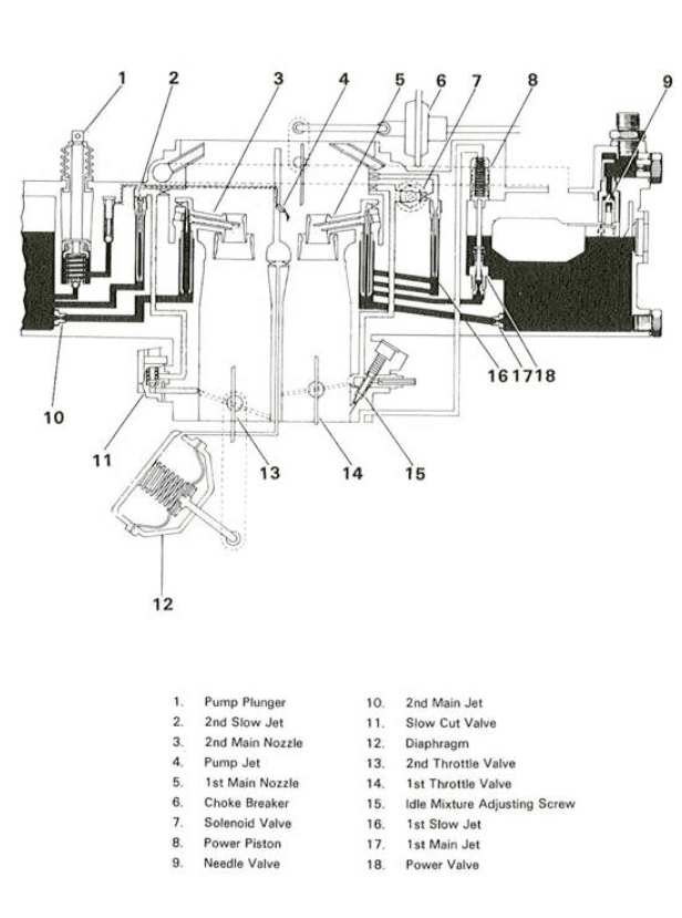

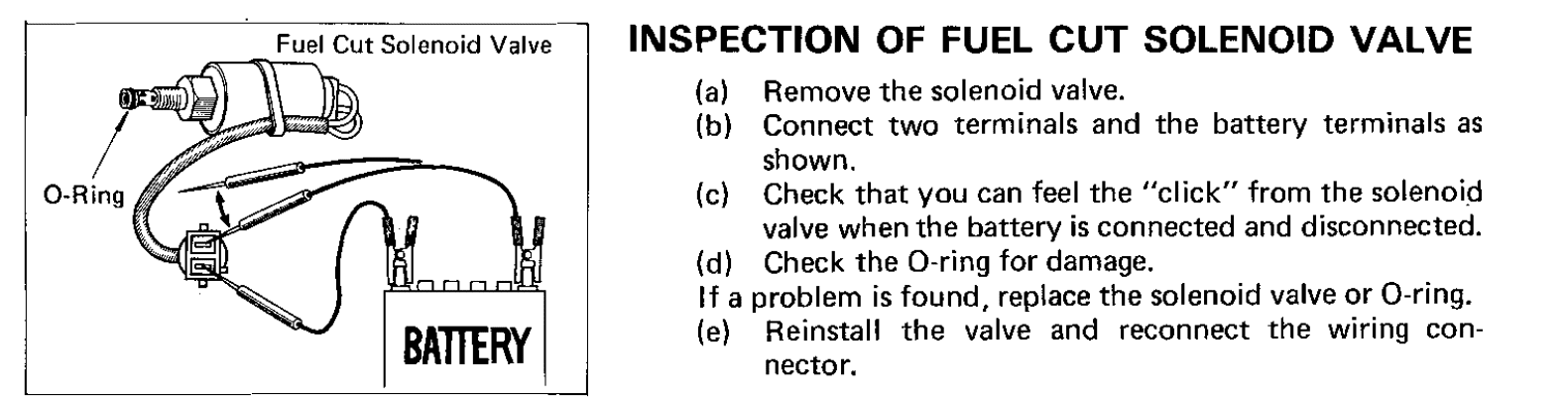

Just wanted to add that I’ve just checked the operation of the solenoid valve and it’s working fine; I sprayed some carb cleaner in the port for the solenoid valve while I had it out and will work on the needle valve next. Also, I can keep the engine running but only if I keep a heavy foot on the gas and keep the RPMs above around 2000: does this point more toward the needle valve and idle circuit in the carb?
