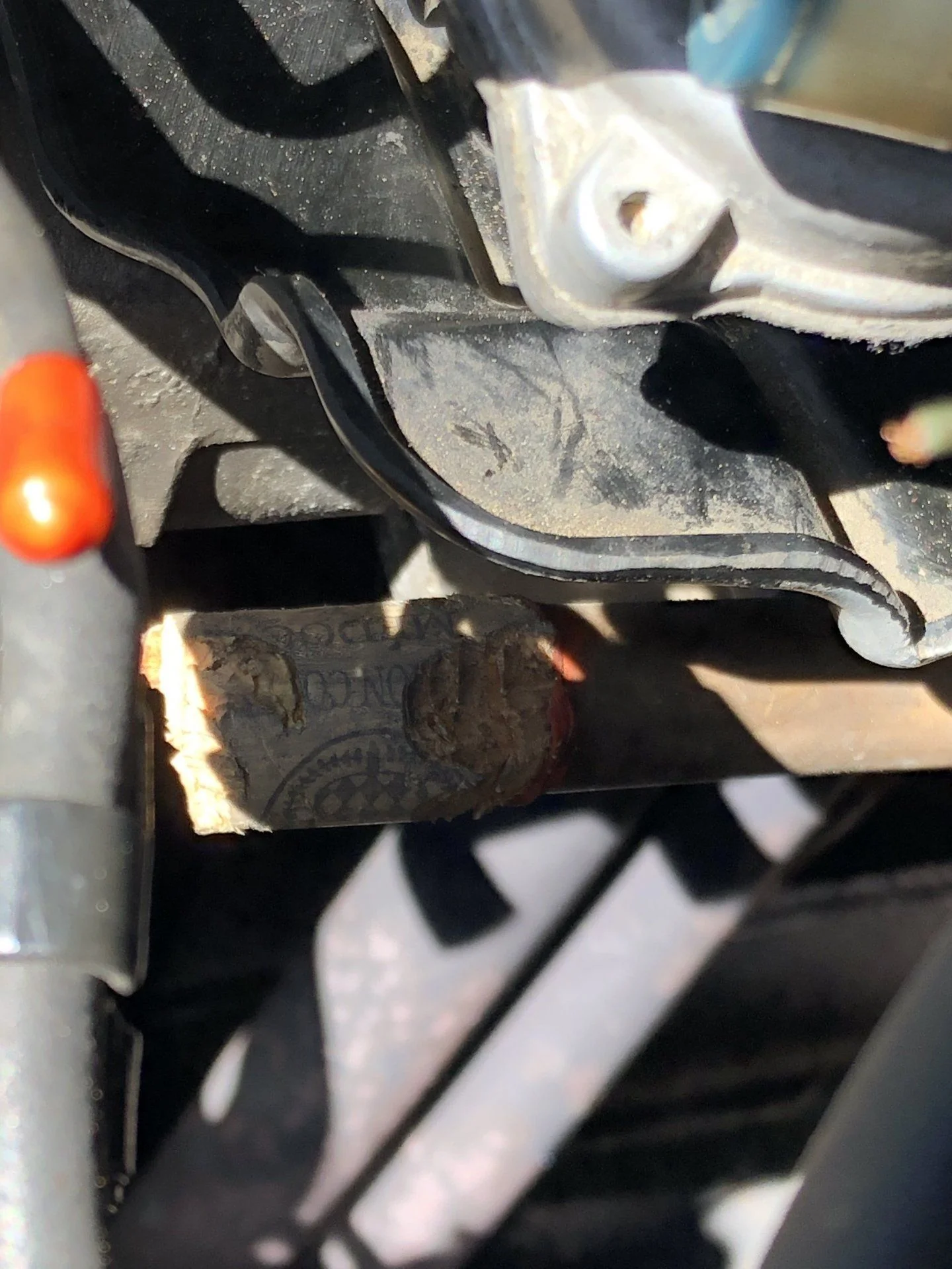

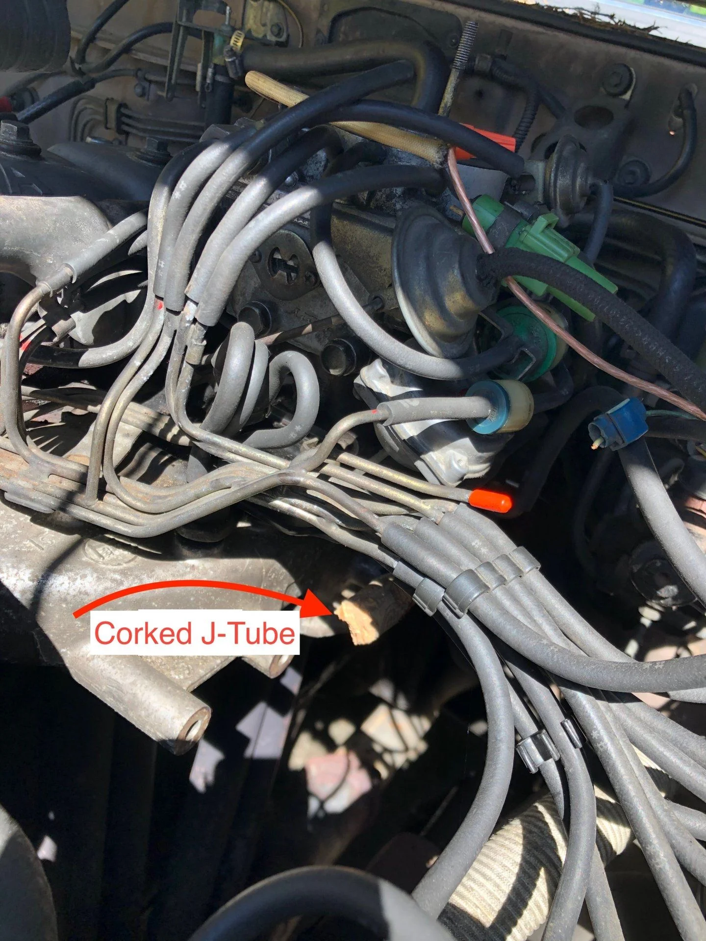

The beast is running again and pretty smoothly now. The issue was primarily down to a leak at the J-Tube which the PO had left on the truck and capped after desmogging. I plugged up the J-Tube temporarily with a cork and the motor started pretty easily and idled properly. In fact it is idling a little better than before all this happened but that is maybe because I had also taken the carb off and did a semi-rebuild, cleaning out the primary and secondary jets etc etc and installing new gaskets and o-rings (some of which were not present when I dismantled). I did notice some small granules of dirt in the float chamber but nothing too bad. I also installed a new fuel filter and made the 'white-wire' mod to the ICV solenoid. While the carb was off, I also examined the heat shield/insulator under the carb which looked OK as well. So, it's back up and running and I will be welding a new cap onto the J-Tube to replace the cork (although it seems to work fine!). I also have two workshop manuals for the car but of course neither mention desmogging and what to look for, so it became more of a discovery exercise in the car as well as some online searching for desmogging procedures and working back from there. Good lesson for my son (and some new words that he learnt...).
I have posted a couple of pics to show the temporary fix.
