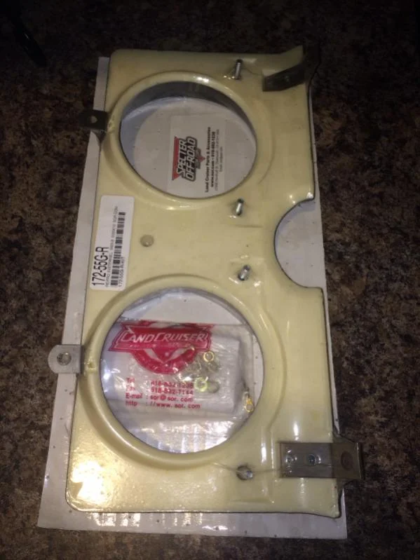

but why not go with a CruiserCorps cap seeing the cluster and glove door(?) inserts you have? Tucker

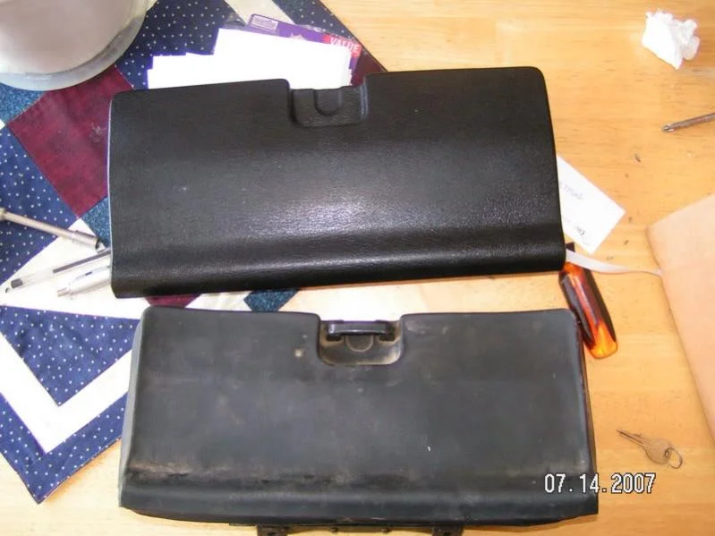

Have the SOR gauge repro and it looks plastic-y...
Have been going rounds on what to do...
Order the SOR glovebox door and dash pad, then recover to match the door cards for the '76?
Or eliminate it all, scrapdaddy style, and paint the metal dash, metal door cards, metal gauge plate, and use Steve's on the '72?
Hope to recover seats, whatever they may be, with a matching product, too, so my thinking was keep the exact same finish throughout all.

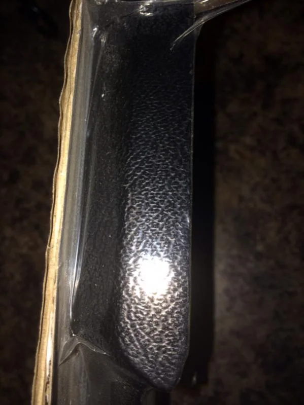

was able to get off early and pick mine up. just peeked at them and they are sexy. the vinyl appears to be a marine grade vinyl, so i think it would be fine for recovery your dash chris.
I have been following the thread. It would not be an issue to use the same vinyl. There should be enough flexibility in the vinyl to deal with minor to mild moderate contours.

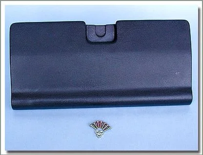

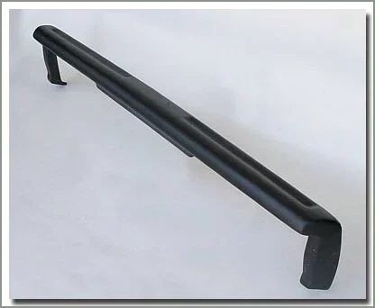

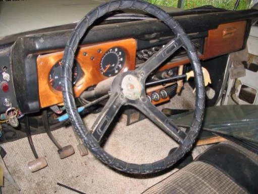

The gauge surround
Lower dash pad
Glove box door
Dash pad
Really those four pieces are it. Balance paints black, being the same black that'll continue throughout the interior.

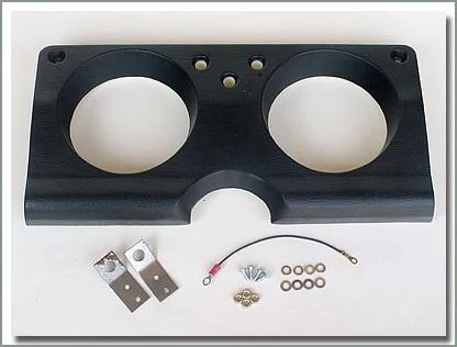

The SOR gauge surround I have is tough plastic with a semi-embossed texture, that looks like plastic. (Not wanting to open, for fear of losing fasteners)
It's very rigid plastic. Hard as a rock.
If their glove box door and upper dash cap are constructed similarly, it be a good foundation ( I think ) structurally, due to rigidity.
Have a lower dash pad that's stated "in good condition" on the way, too, since I'll need for one of the two, anyway, but if it were built like SOR's gauge surround, and all could be recovered in a matching vinyl that'll last a long time, I'd reconsider redoing the OE dash.

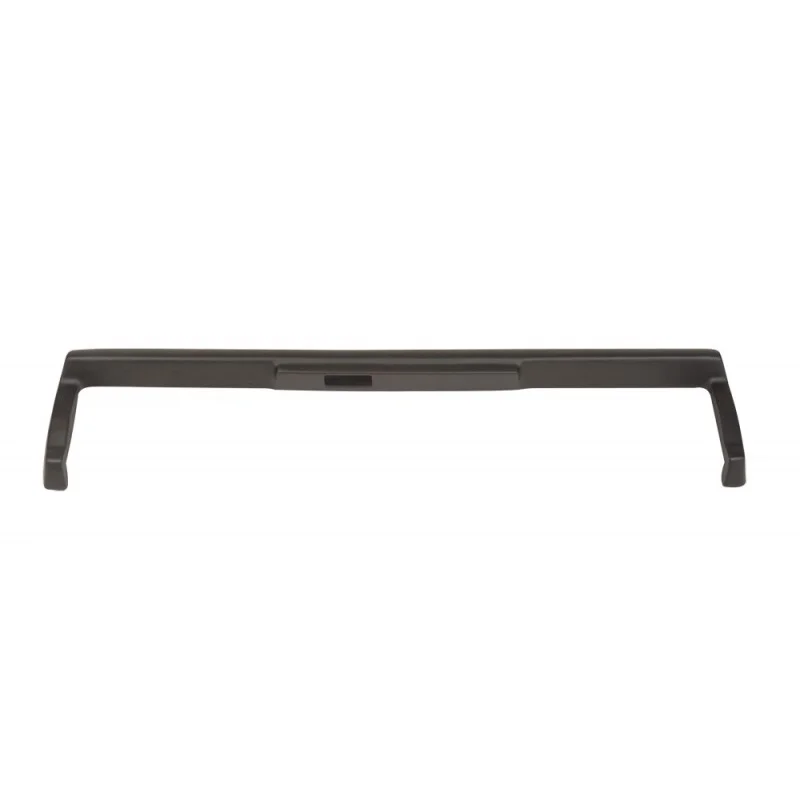

This is a cap, but only pic I had.
Door pulls are easy and there's also a small lower dash pad not depicted.
