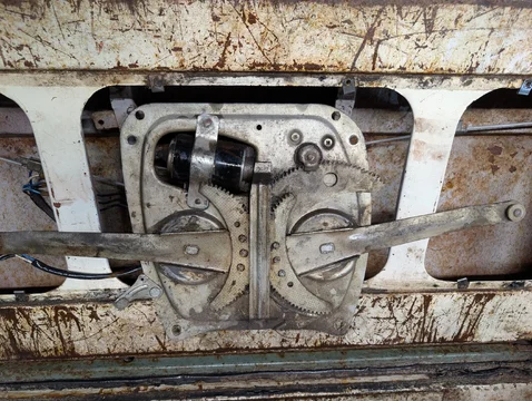

Hi everyone! New FJ55 owner here. I'm working on getting my rear window regulator functional again. I have removed the regulator, inspected the plastic gear, and tested the motor - all good. My issue is the arms are not properly clocked. Any advice on getting them in sync again?

They aren’t supposed to be equal. IIRC, 4 teeth or so off is where you want them.
@jadesculptor read the thread linked in post 2 above.
Edit: be super careful working with that mechanism. Those springs are very strong and the teeth can easily take a finger off. Once you pull the motor there is nothing stopping the teeth from moving.
Thank you WarDamnEagle! With that knowledge, my regulator may be just fine. I'll just clean the regulator, fix the broken wire in the tailgate, install the new channel rubber, and reassemble. Again, thank you all for the quick reply. This community is awesome! And Gary S.'s post is gold!
