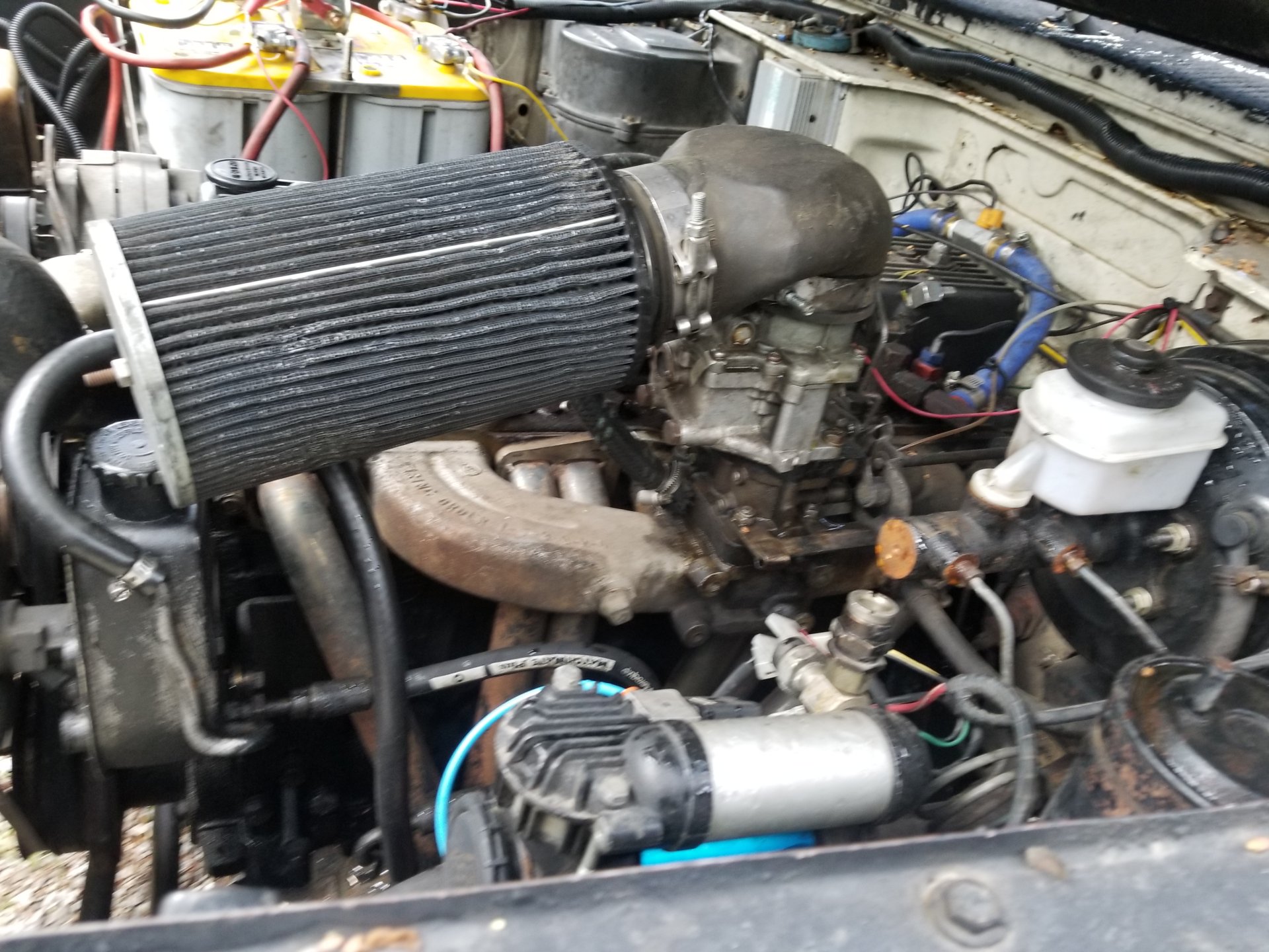

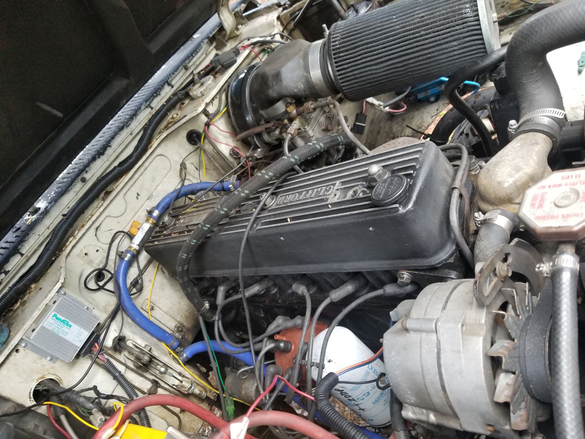

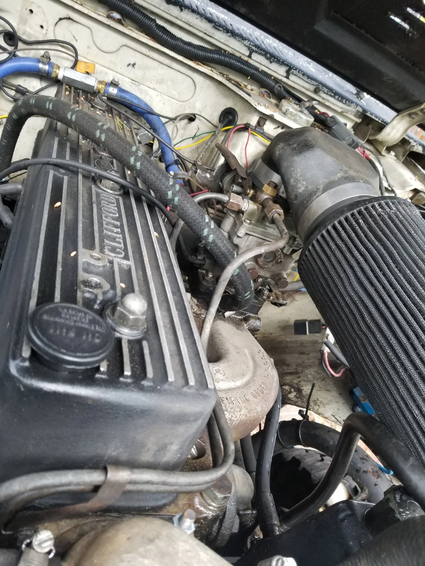

I just recently purchased it and am in the process of running through it. Yes tach, have flushed the coolant and changed the plugs. Getting ready to change the oil/filter this weekend. It does need a good card clean and adjustment. The PO changed the carb and added some sort of fuel delivery adjustment knob so it does have some hesitation with a heavy throttle application. Probably needs to be cleaned. Will post pics later when I get home.

Any chance you could send a pic of the motor/carb set up on yours?
