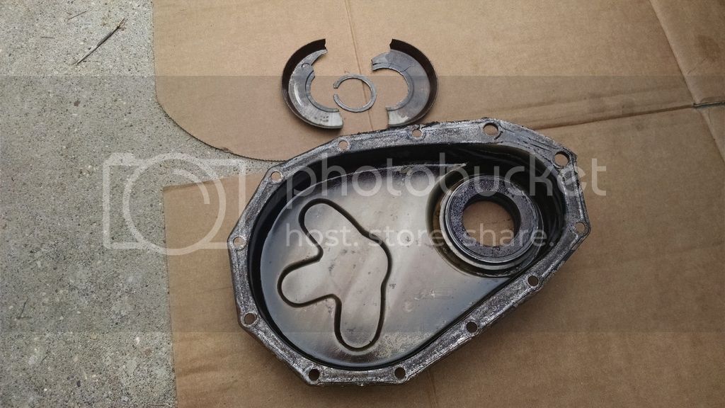

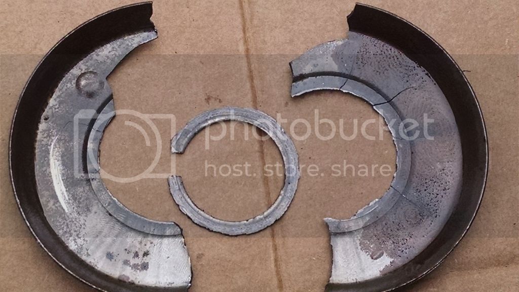

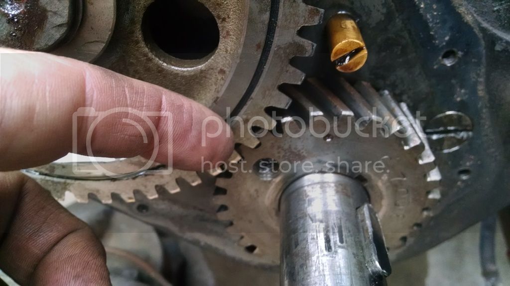

It was from the front and at first it was kind of a knock them turned into a sound that resembles a card in the spokes of a bicycle wheel.I think the harmonic balancer was not installed correctly. The balancer holds the slinger against the crank gear.I think the slinger was just spinning freely and the stress and vibration tore it apart.
