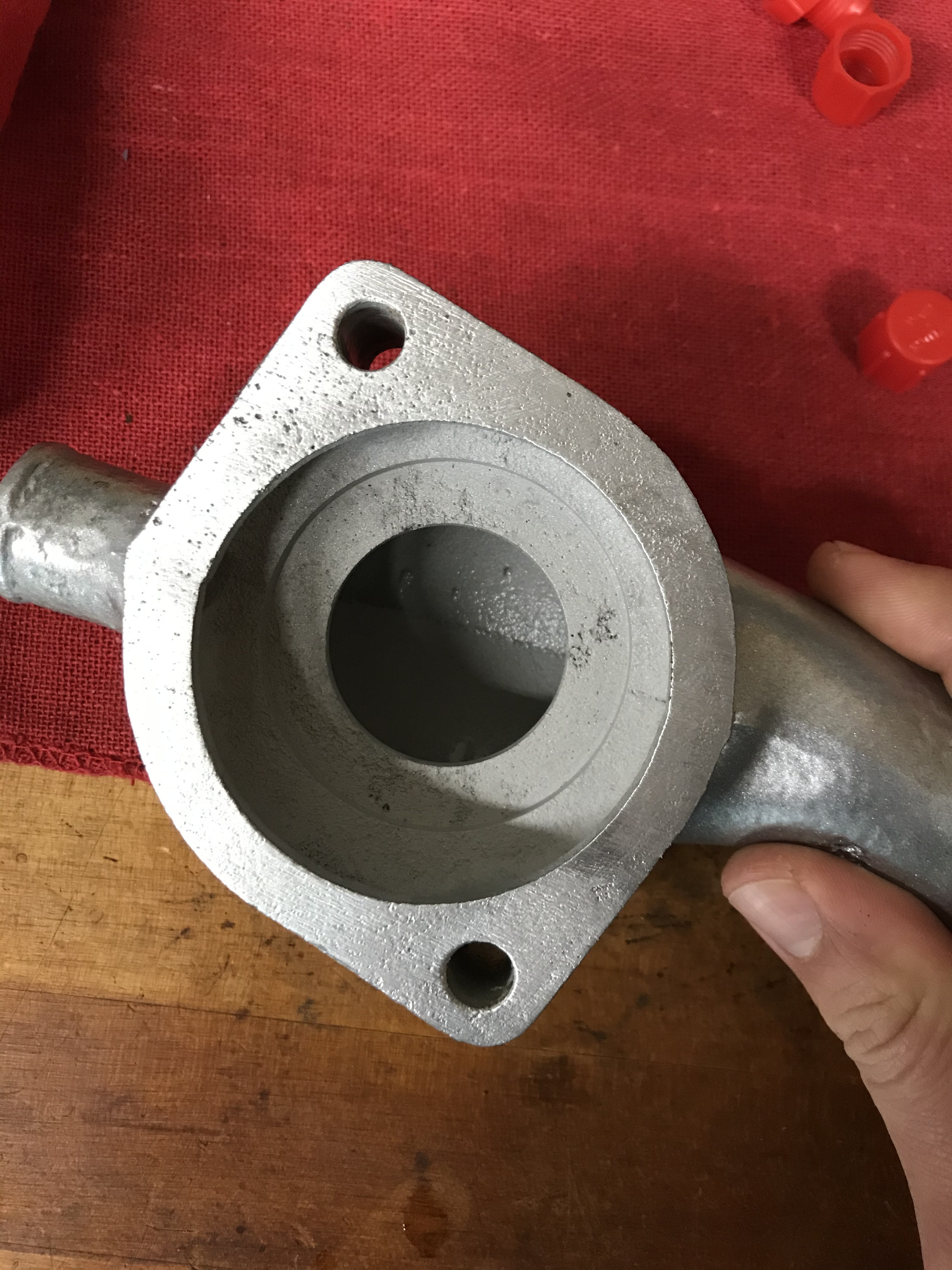

Glad I read this thread. I had a thin gasket and when positioning the housing, it had a gap, and I thought, that must be the rubber gasket on the top holding it up, and if I crank it down, it will seal. Then I removed the rubber top gasket and the housing still would not go all the way down. Used a permanent marker and drew a line around the diameter on the thermostat and when placing it in the top housing it showed where it was binding. Measured the hole and where it was touching on thermostat and hole was about 1.5mm smaller. Luckily I have a mill/drill in my garage, and set it up and bored the hole out a couple of mm bigger. Even if I had used a thicker gasket between the two halves of the thermostat housing, it could have damaged the thermostat. Fits perfect now with that bit of clearance and the top rubber gasket sits where it should. It was a genuine Toyota Thermostat as well, so beware.
Hmmm, what hole are you talking about? I cannot envision what you had to enlarge here.
It’s the hole in the top housing that lets the water through when thermostat opens. It is about 40mm dia and pressed part on top of thermostat was about 41mm. After machining it out a couple of mm thermostat fitted perfect and everything working ok.

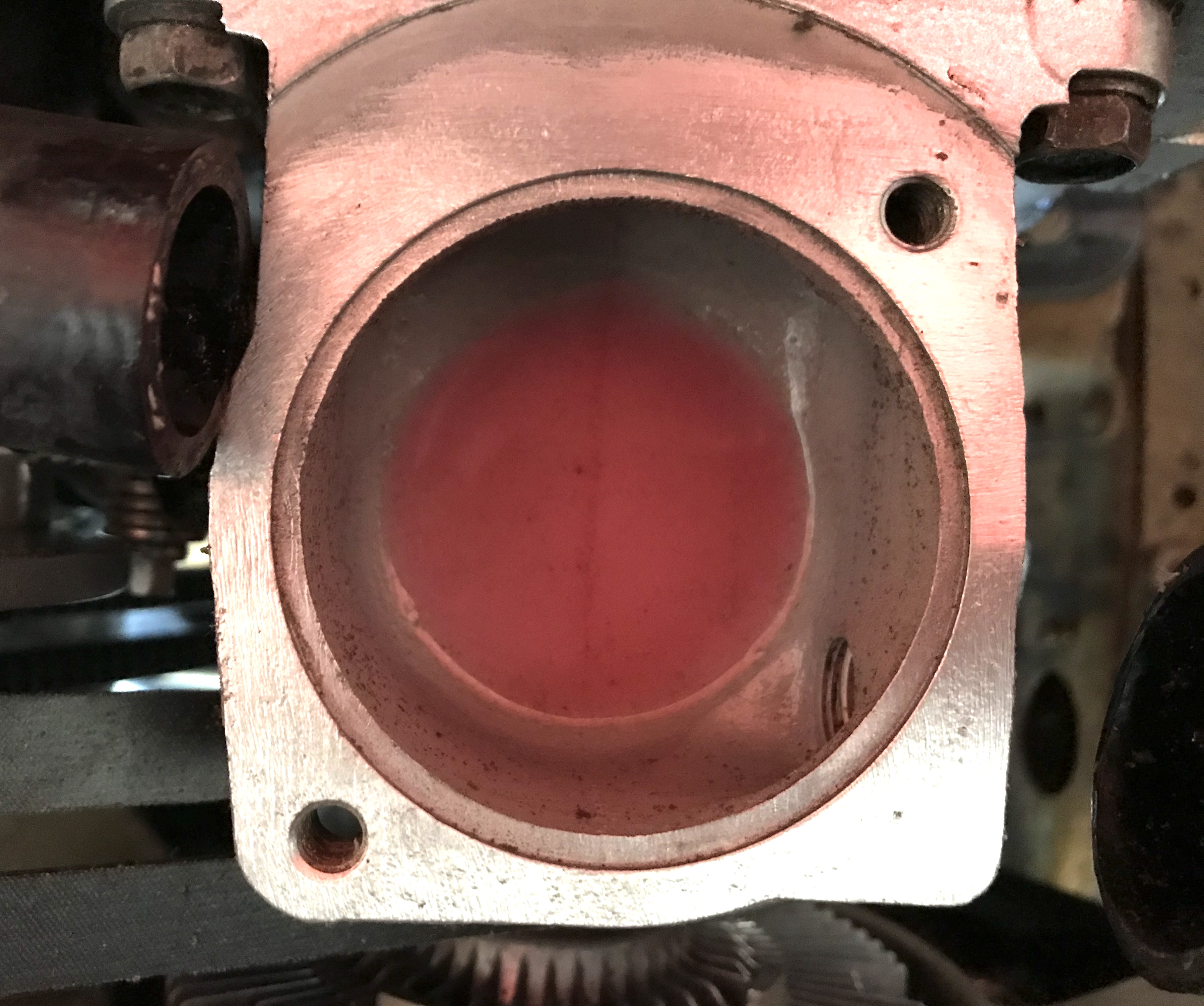

I'm hoping this crew can help me. I pulled my 2F to reseal it because a Welch fitting on the back of the motor was leaking. I was uber meticulous during reassembly because I didn't want any leaks. I reinstalled the motor and test-fired my Holley Sniper yesterday. Everything worked great, but the thermostat was leaking at the seam between the upper and lower thermostat housings and under the head of one of the bolts.
I disassembled the t-stat housing and cleaned up the surfaces with a brass brush. I assumed the leak was due to pitting in the aluminum housings, but both machined surfaces look decent with only light pitting. They had previously been sandblasted and powder-coated, so they were certainly clean on original assembly.
Any ideas to prevent this from leaking on reassembly? I had previously used a high-quality paper gasket that was supplied with my gasket kit. I do not recall the brand, but it was Made In Japan. I prepped the aluminum surfaces and both sides of the gasket with Gasgacinch and let it get tacky. Then installed.
The thermostat is not interfering with the housing (I can use a "thin" gasket per the instructions in the OP).
Would the thick rubber gasket fix my problem? Should I use some Permatex water pump silicone?
By your description it should have worked just fine. Should not require Permatex in this application. Are you sure you had the bolts tight enough?
ps: use anti seize on those bolts.
