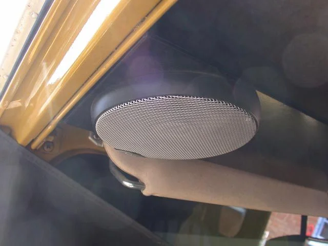

the overhead speakers are mounted on a plate overhead welded between the front side rollbars right behind the upper windshield channel
at high speed, I can only hear the overhead speakers - yeah, I need to get onto adjusting front vs rear in my new stereo :rolleyes:

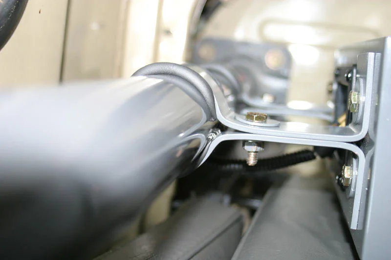

Here's a pic of one of the speaker mounts I cut out of a piece of scrap stair landing that I got off the jobsite. It's approx. 1/8" thick. Not quite as pretty as the ones that Specter has but a hell of a lot cheaper. Above it is an factory mount.

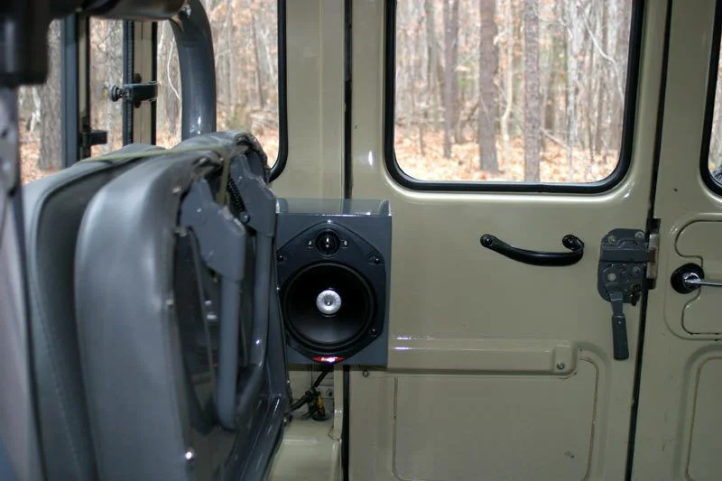

I made these boxes of MDF. They angle back at the top to face up a little. I convered them with canvas left over from making the under seat tool bag. Speakers are 4 x 6, rears are 6 x 9 in box kits from walmart that come pre-carpeted. They are on the rear floor with extra wire so they can be moved or put outside the truck for camping. They fit perfectly, even when the jump seats are folded down.

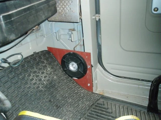

Here is where I mounted mine.

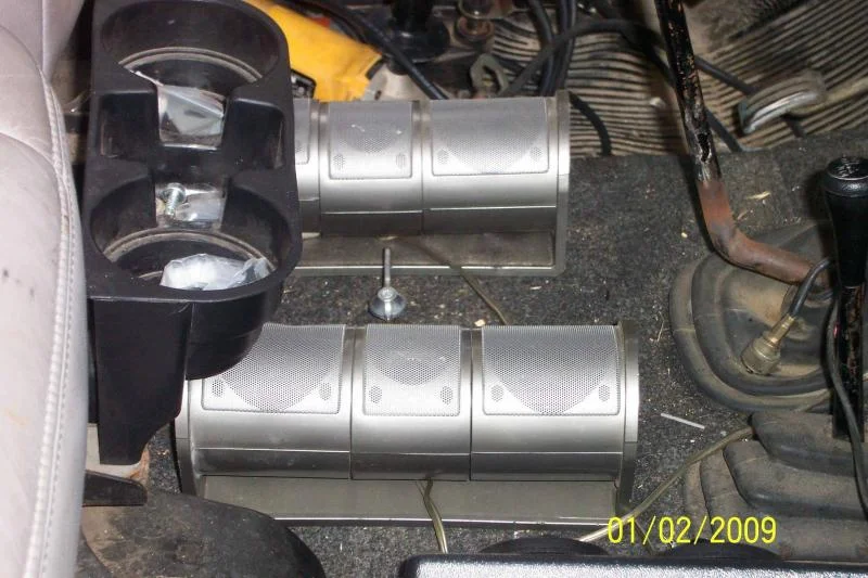

Found these at a walmart a couple of yrs ago. Sound off the floorboards worked really well.

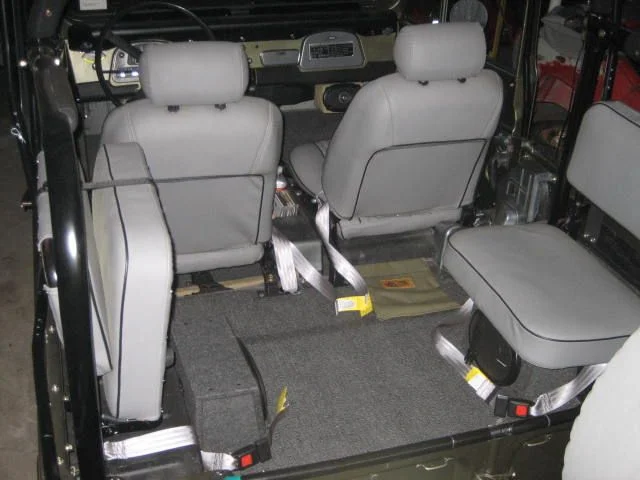

mine
